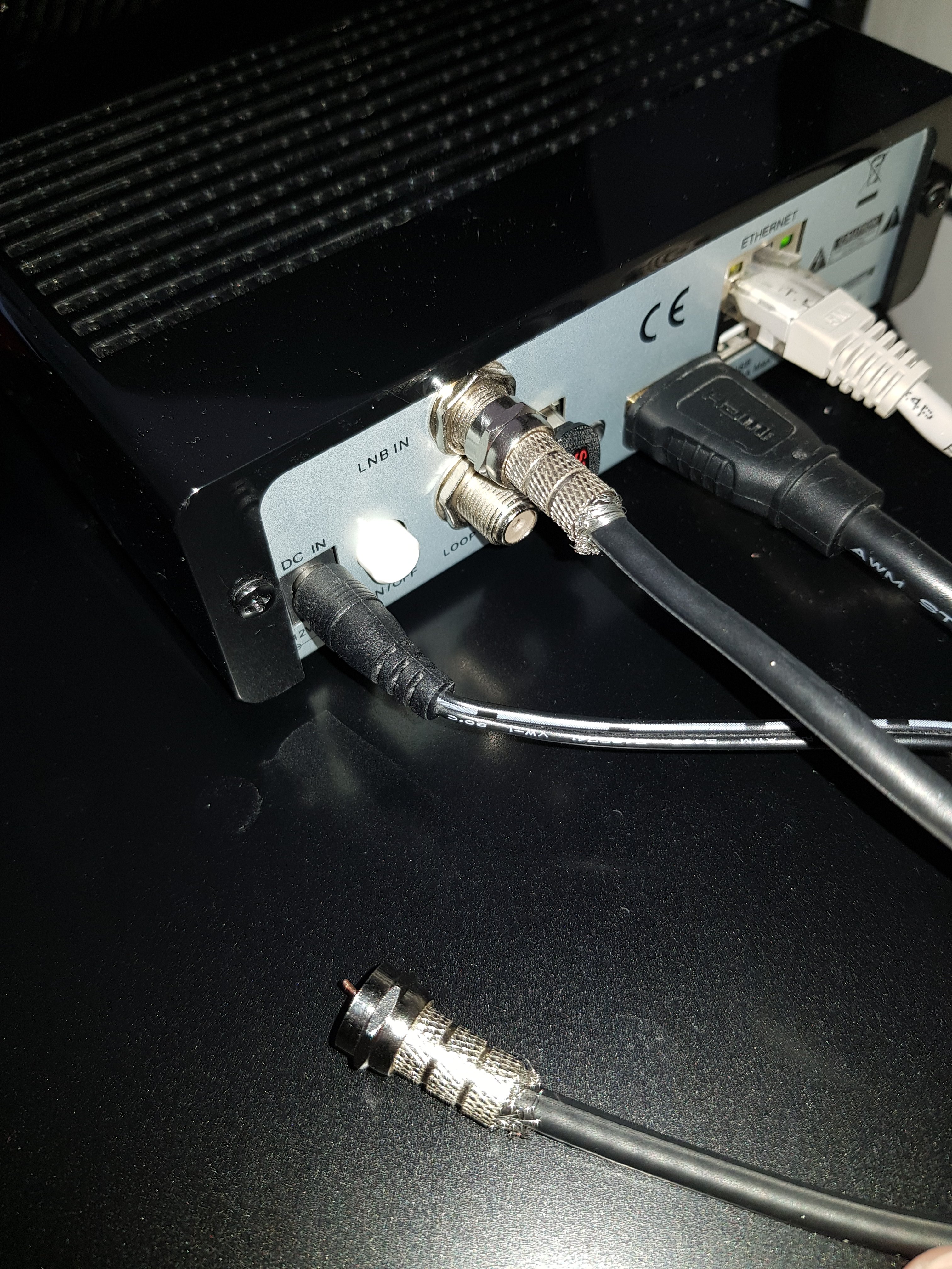

Could you take a pic of how you have the tuner on the h9 setup and post it ?

Yes just the 1 input on the zgemma. Tried both cables and get nothing. 20220405_160252.jpg20220405_160408.jpg
Just standard set up outside, never touch it since it was installed. Then back of zgemma and set up of wires/cables. This is the same in both rooms.

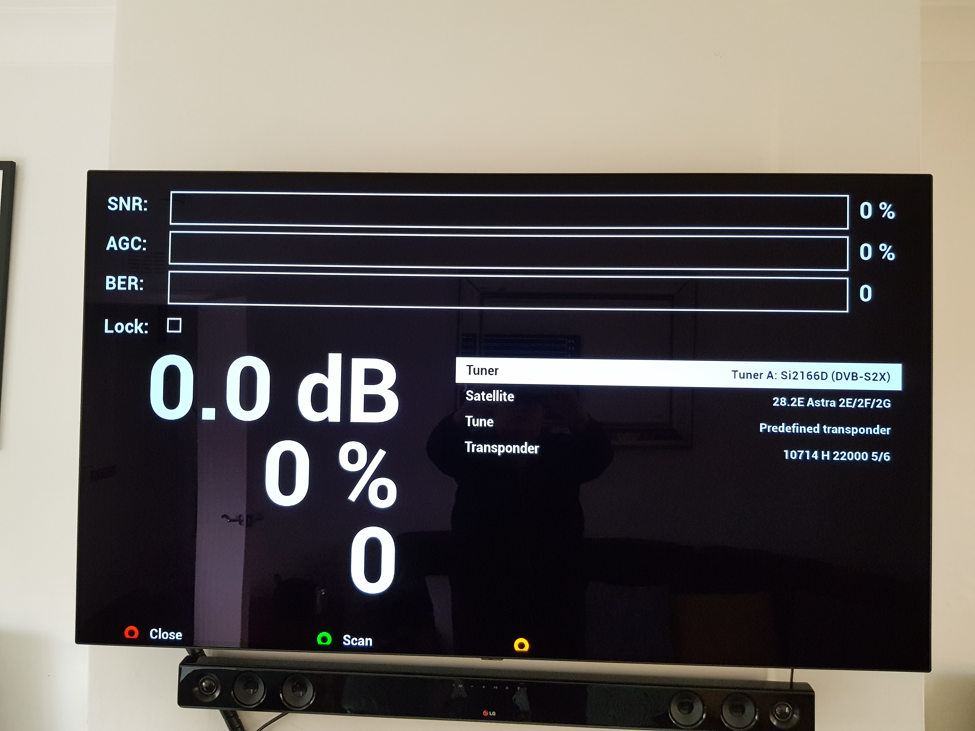

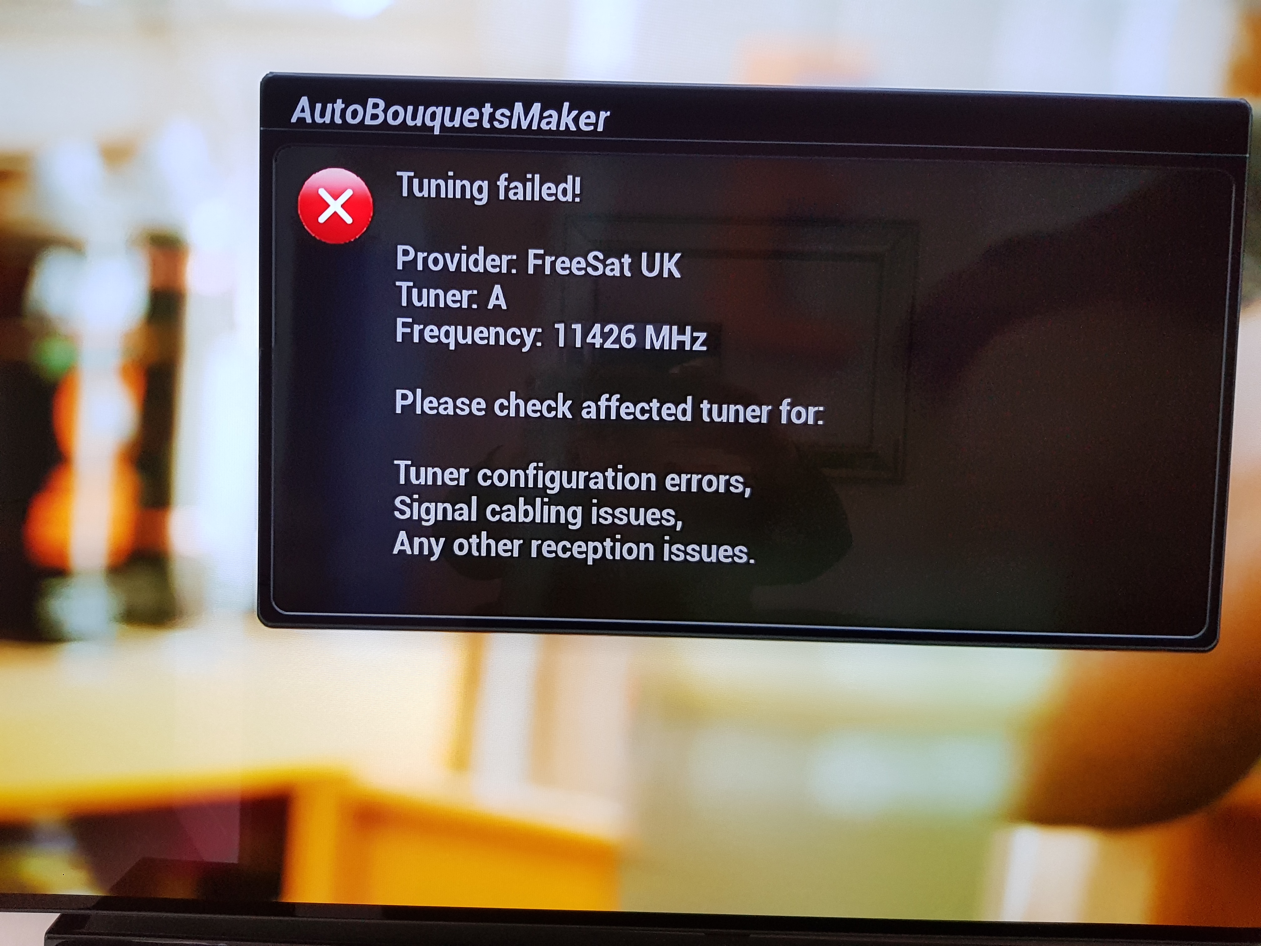

I can see a picture of you using ABM to read Freesat and it is not locking onto the home Frequency. It seems as if it is actually receiving signal because there is video in the background. Have you tried to scan using Enigma2 and not the ABM plugin? A manual scan, single satellite, 28.2 should get you 850+ channels .
