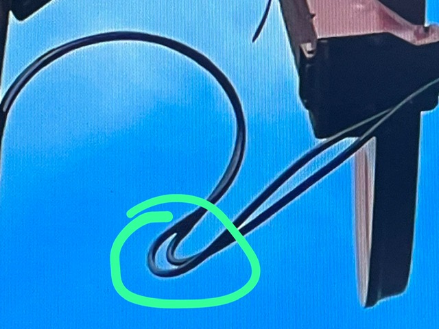

Dont you have to pay for Sky germany??? Your loop is in the wrong place and too severe!!
