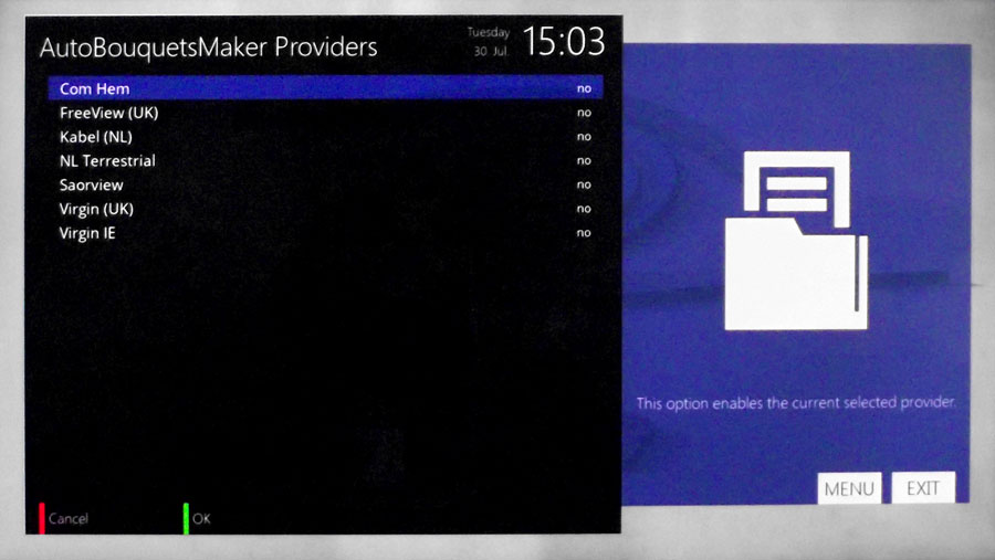

Providers Menu
Menu… Setup… Service Searching… AutoBouquetsMaker…Providers
Answer yes to your choosen provider
Virmin (UK) area *change this to what ever is your closest region *, there may be more than one for your area so start with one, then maybe try another only if your missing any channels

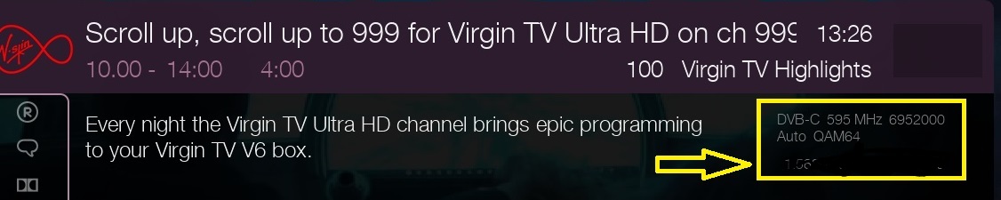

Net ID's
00001 West Yorkshire
00002 Glasgow
Ran the scan under complete as suggested which downloaded the channels. Then tried scanning from ABM but still getting the error ABM cannot read data.
Then to virgin tv highlights no frequency or QAM information available... DVB-C has an X beside it. My net id is 23
in that case it looks like the DVB-C tuner is either disabled or not working.
Is there a posibility you have plugged the VM cable into the wrong socket?
Had a look at the other net ids and noticed my city now has a net id 21 shared with Belfast, and 23 on its own. Started the scan using this new to me Net Id of 21 and it scanned. Really confusing. The DVB-C is in the right socket being a lc it has 1 tuner. I now have free channels all i need now i think is to get a softcam APK .... how do i get that. Im almost there.

I am trying to setup openatv 6.3 on a zgemma H2H and I have hit a problem with the Auto Bouquet Maker plugin, there are no options for Freesat or Sky in the provider list. Any ideas why these are missing?
That usually means you haven't set the satellite tuner up correctly.
All those providers are either cable or terrestrial, no satellite services at all.
