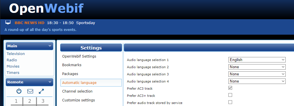

OpenATV Set Up Guide
Change automatic language settings like this and reboot box.
