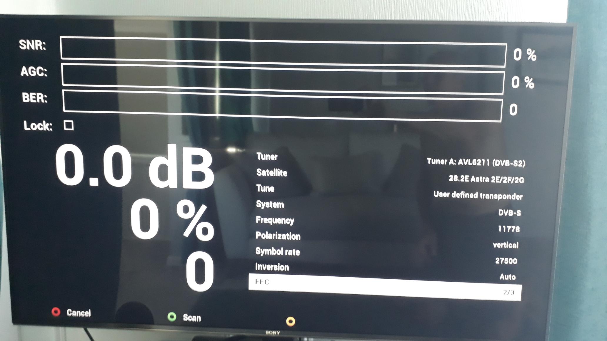

My LNB is a Sky supplied and fitted Hybrid, two ports for Sky Q and four ports which I use for my Humax Freesat box and my Mutant HD51
I can confirm that the issue is not related to Willobuild as I rebooted to slot 1 on my Mutant which is plain Openvix 6.2.008 and the problem still occurs.
Do not use ABM for now, instead perform a manual scan, single satellite, choose tuner B. If you do not get over 850 services, it is confirmation that there is a hardware fault. Please respond back with the number of services/channels you get.
I've just performed a Manual Scan exactly as you suggested and it reports that 715 channels were found. Looks like I've got a problem. 😢
There are two possibilities, minor alignment or faulty LNB.

My assistant was busy but I used the "Alfred" android app to send the screen to my phone while I wiggled.
But it started at Zero and remained at zero whatever I did.
I think I have all the settings correct, looks to me like something is very wrong.
I just don't understand how I can receive 715 channels but not this one.

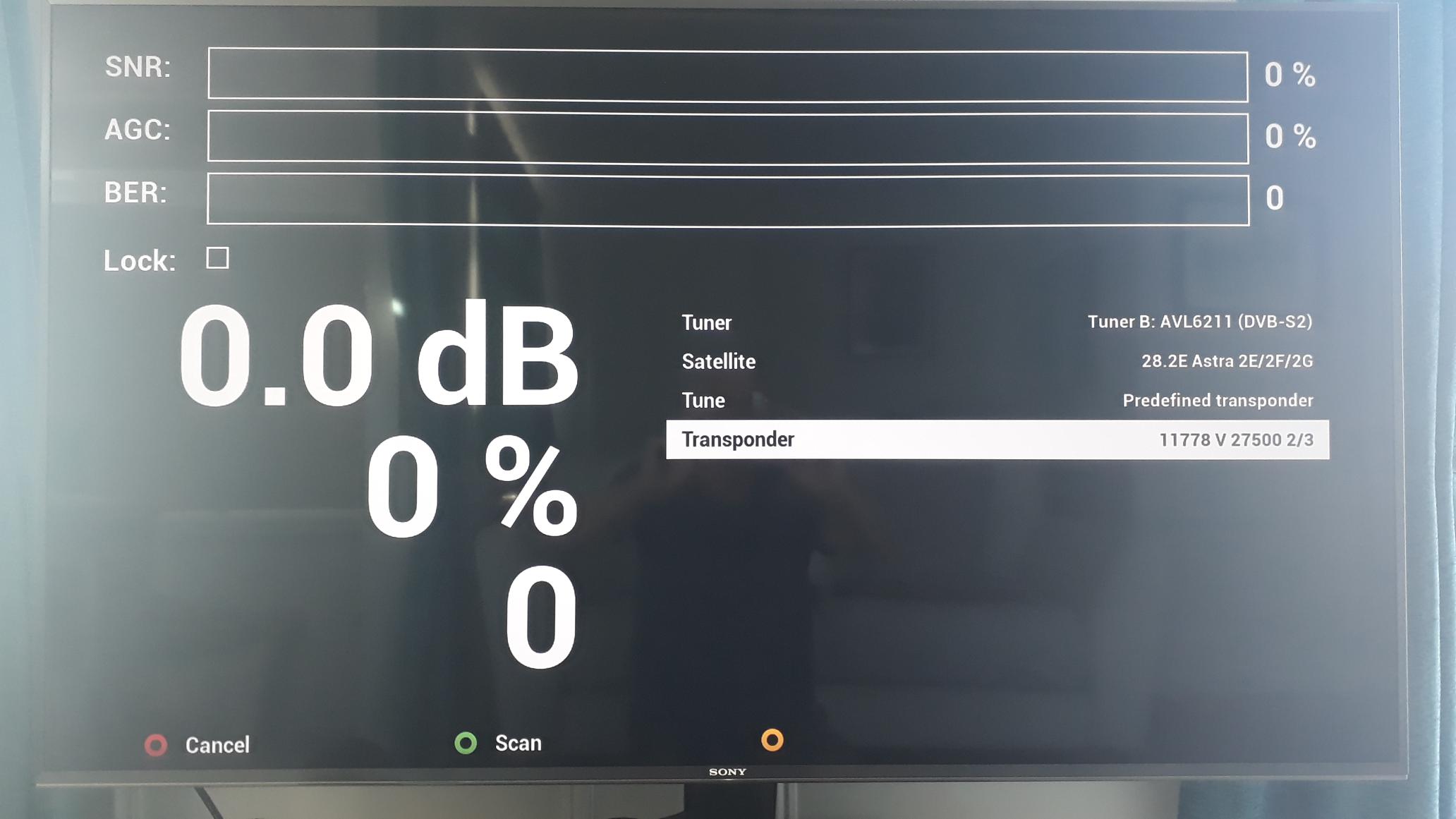

Use the predefined transponder instead of user defined. Pressing right/left goes through them. The recordings/list button will open the list.
Unfortunately I got the same result with a pre-defined transponder.

On 2 of your pics ive noticed its vertical transponders with no signal, try some more vertical transponders under the predefined option if the majority are showing no signal it will be the LNB.

This morning I set my Mutant on Signal Finder at 11778 and got no signal (as usual)
I turned off the power to my Sky Q box, still no signal on the Mutant .
I turned off the power to my Humax Freesat box....................................................................BOOM!!
Signal Finder Burst into life on the Mutant and I had a strong signal.
So I powered up the Sky Box, still got signal.
Powered up the Humax and the Signal on the Mutant has gone.
I'm guessing that means a duff LNB

It is a weird and quirky issue with some LNBs that I have seen over time. They work fine with one device, as soon as you have two devices sending commands to it, they exhibit the issue you just witnessed. The wideband section does not do the switching, so we can take that out of the equation.
I very much doubt your new cabling is at fault.
I appreciate that it is awkward to get to, but you could try and swap the port that the Freesat box is plugged into. If that port on LNB is faulty, you should be able to work with three working ones. The mutant will be fine with one signal wire. Just make sure tuner config for each tuner matches what is physically attached to it.
