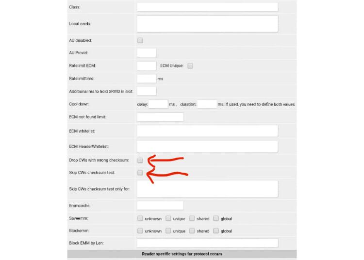

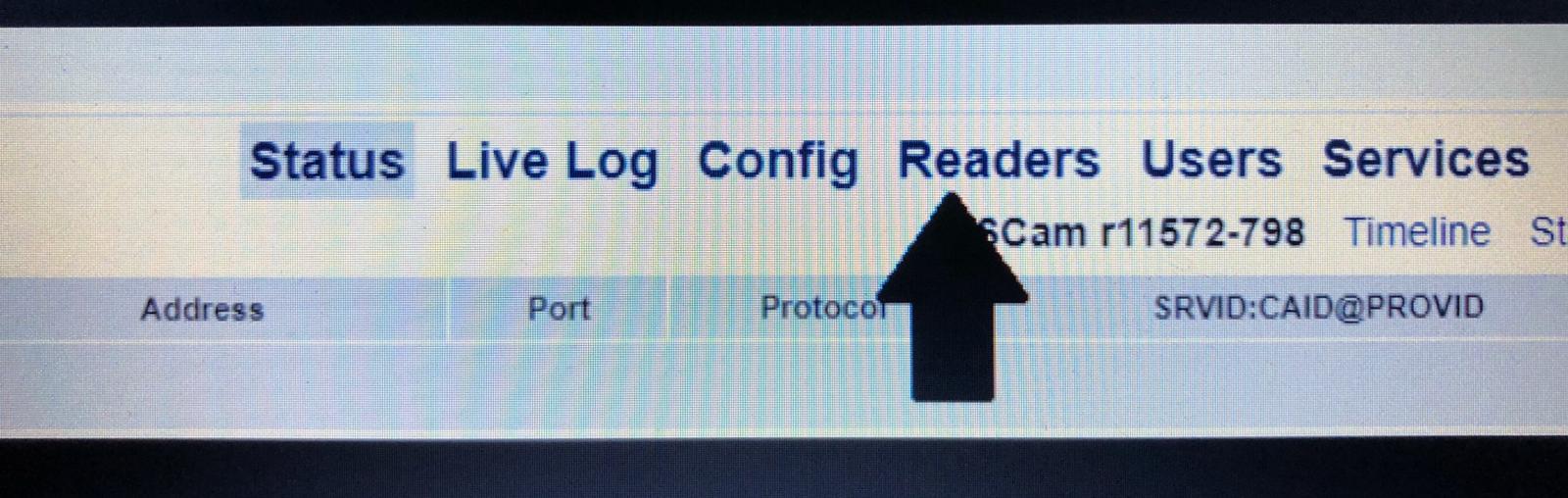

OK mine is now working, open the oscam panel on your box, go to readers -> your line and check the following two boxes:
Drop CWs with wrong checksum:
Skip CWs checksum test:
and then save. I did this and now watching sky1 HD
http:://YOURBOXIPADDRESS:83

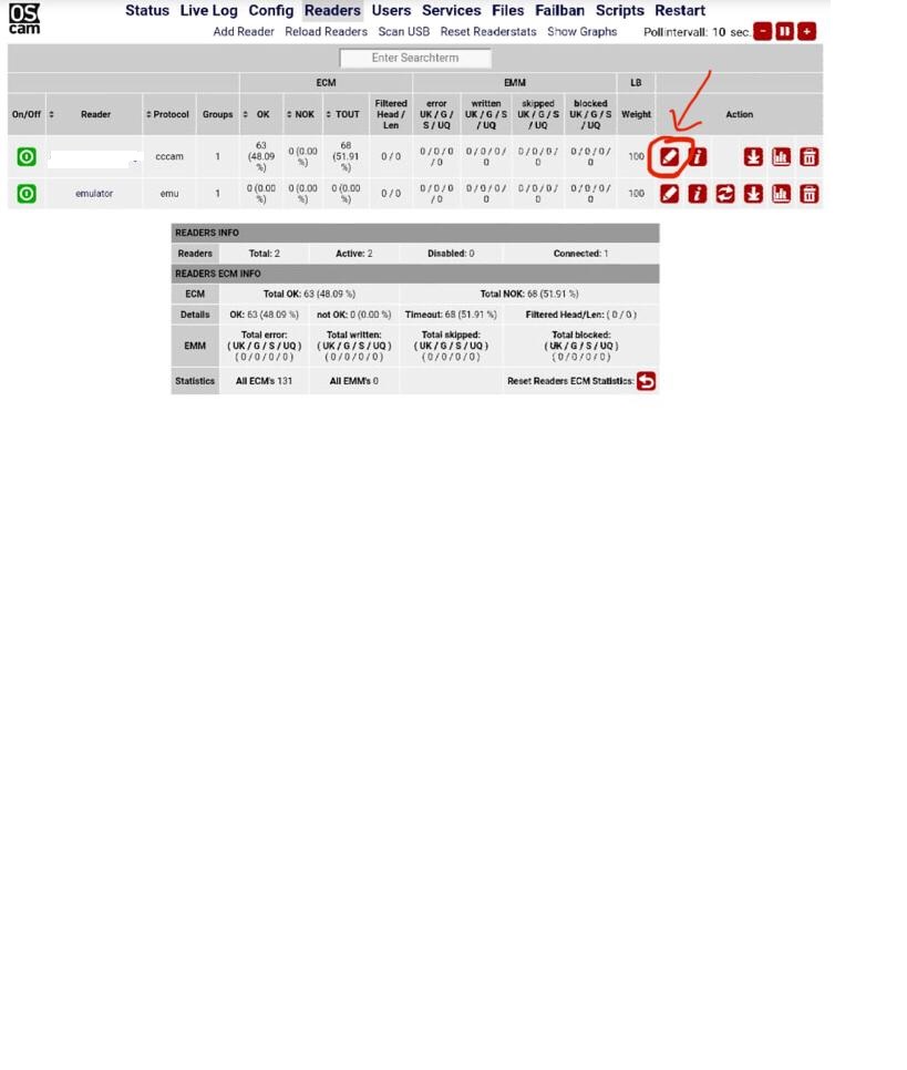

and then click on readers and 'edit' your line and then tick the two boxes mentioned above and save.

THIS WORKS ON CCCAM AND NLINE IF YOUR RELLERS IS ALSO SETUP TO WORK

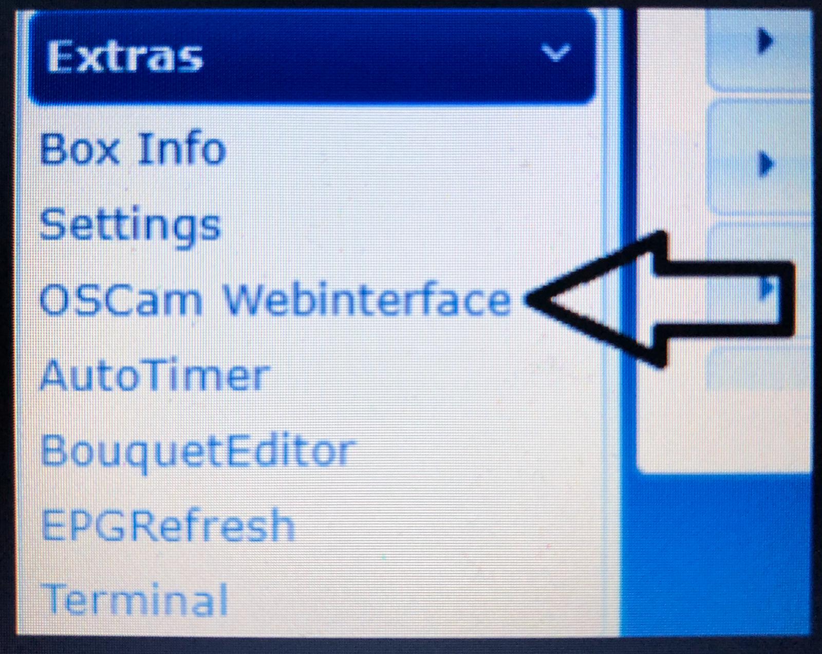

Use openwebif
Select oscam webinterface
Go onto readers
Edit
Tick those 2 settings then press save
Check channels on box and they should clear, if not straight away then restart cam
