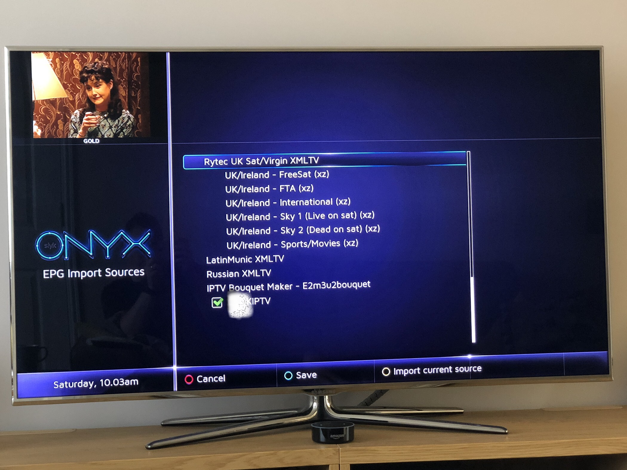

After putting my iptv line in the epg import is not using any of the sat uk options but the epg is not complete for some of the sat channels 5 days in the future.
By default which of the rytec uk sat/virgin xmltv options are supposed to be checked?
