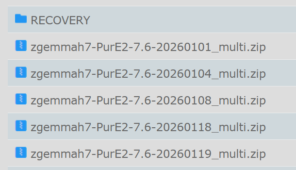

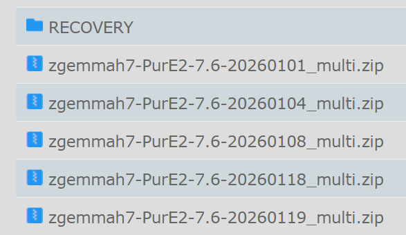

Thanks for your reply.
So should i have been using a file from the recovery folder in the image??
Is it worth my while trying again if so?

When you flash the h7s from a usb you can’t flash it again using a usb. You can only flash it using a recovery image and that deletes all the slots. With the Pure2 image there is or was a facility where you can flash on the fly using an image either on the hdd or a usb BUT the image must be unzipped. You then get a choice of partitions to flash. It may be possible to even flash online using PURE2 but as the image is ancient that facility may be blocked/withdrawn.
There is a multiboot option and that should be checked in case there is an image on another slot.
Flashing online from the recovery image has me gobsmacked as you can only get an online image from an image, like vix image manager, and press yellow gives vix, openatv, opnpli,openbh and that’s it.
Box is 3 years old with internal hdd and epg stored on internal flash may mean it’s ……..ed. Removing the iptv plugins and reinstalling the latest or better still use bouquetmaker may solve the problem.
I never took to the purE2 image it was to much like the old kodi for my liking.
Ooops my post may be misunderstood NB the image must be stay ZIPPED when copied to the USB or when downloaded to the USB, that's important as Pure2 wont see it.
I would stay away from pure2 for now you can always add it later BUT when you use recovery all the partitions are wiped and then partition 1 is flashed with the recovery image you used and you configure as normal. Then you have access to Vix image manager.
I was watching the footie when posting and Bournemouth scored so was distracted!!
And when using recovery you do unzip file.
