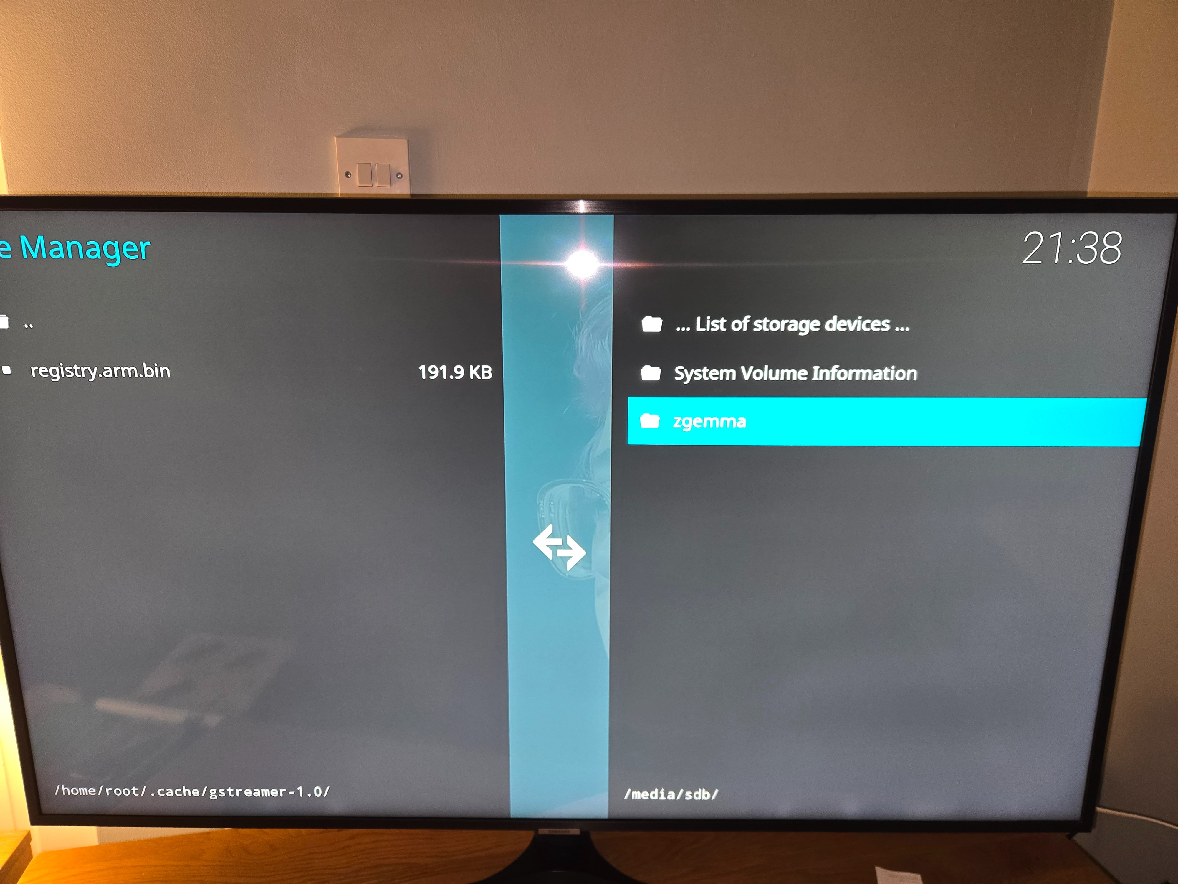

Something I noticed today. When I go in through menu/file manager I can see the usb and the firmware. For some reason its not updating.
Updating?

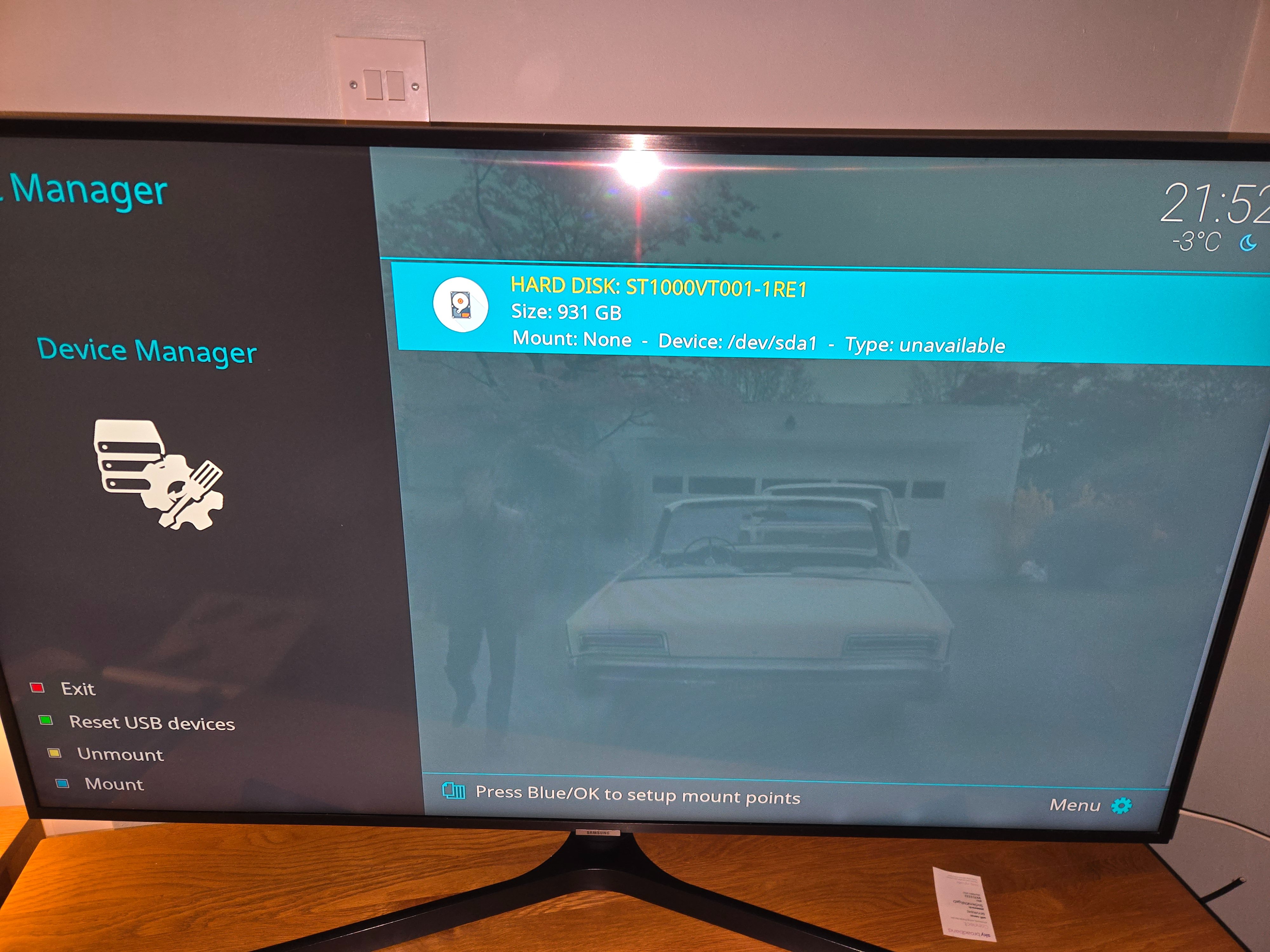

Not showing up there
Right, well like i said earlier, the box doesn't recognise the usb, so it's impossible to flash an image with it, regardless of what you put on it.
If you have any other usb sticks, try them in the box until one appears in that list.

Fair enough. How come the file manager sees it but the storage device doesn't. Confusing.

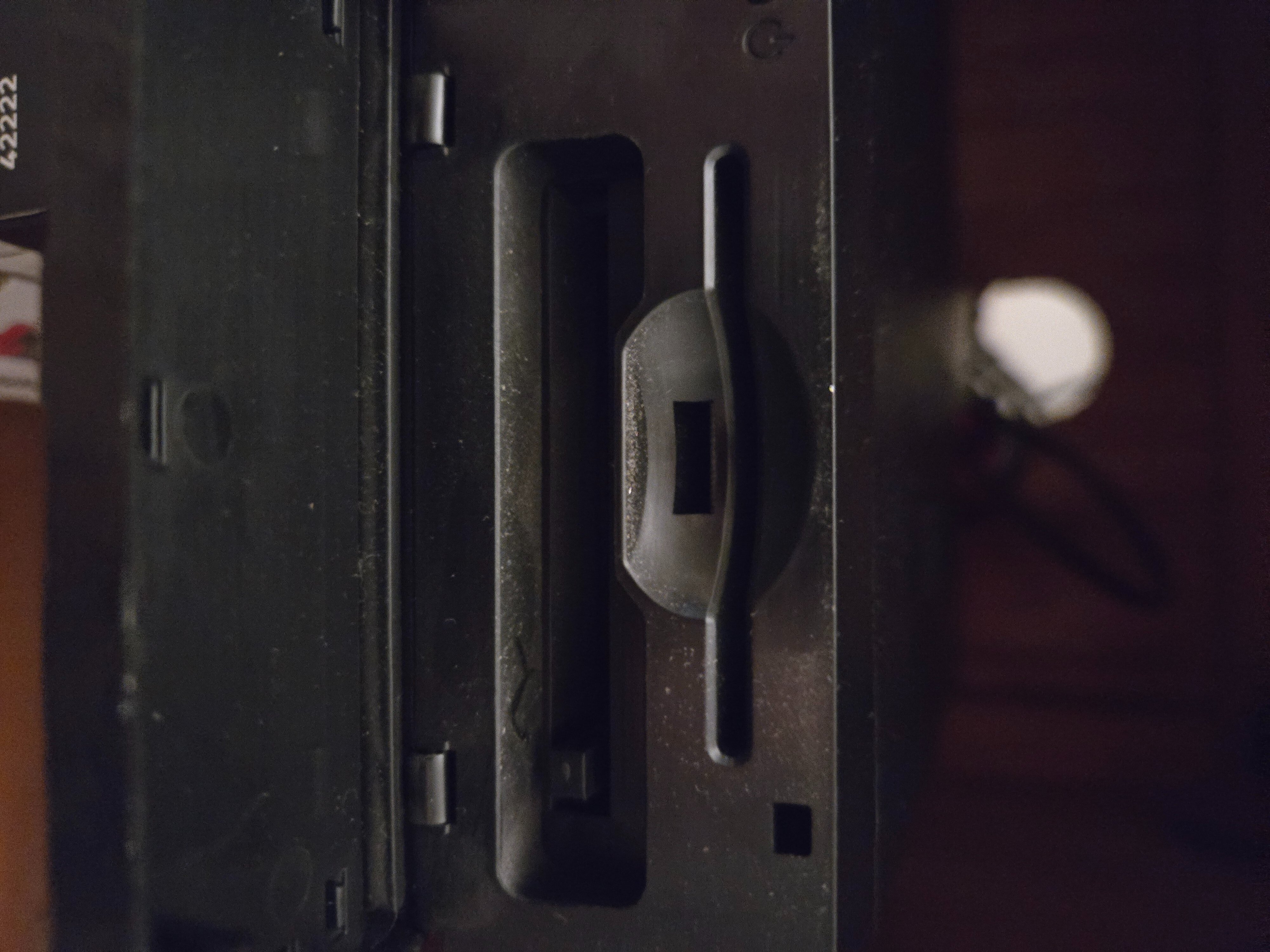

Is there not another usb under the flap to use and inserted when powered off.
Many years these boxes are fussy with makes and size of usb in use
Well smack my ass and call me rosey your right. Never spotted the second usb.
It's smaller then the normal USB. I really do have a dodgy box ??

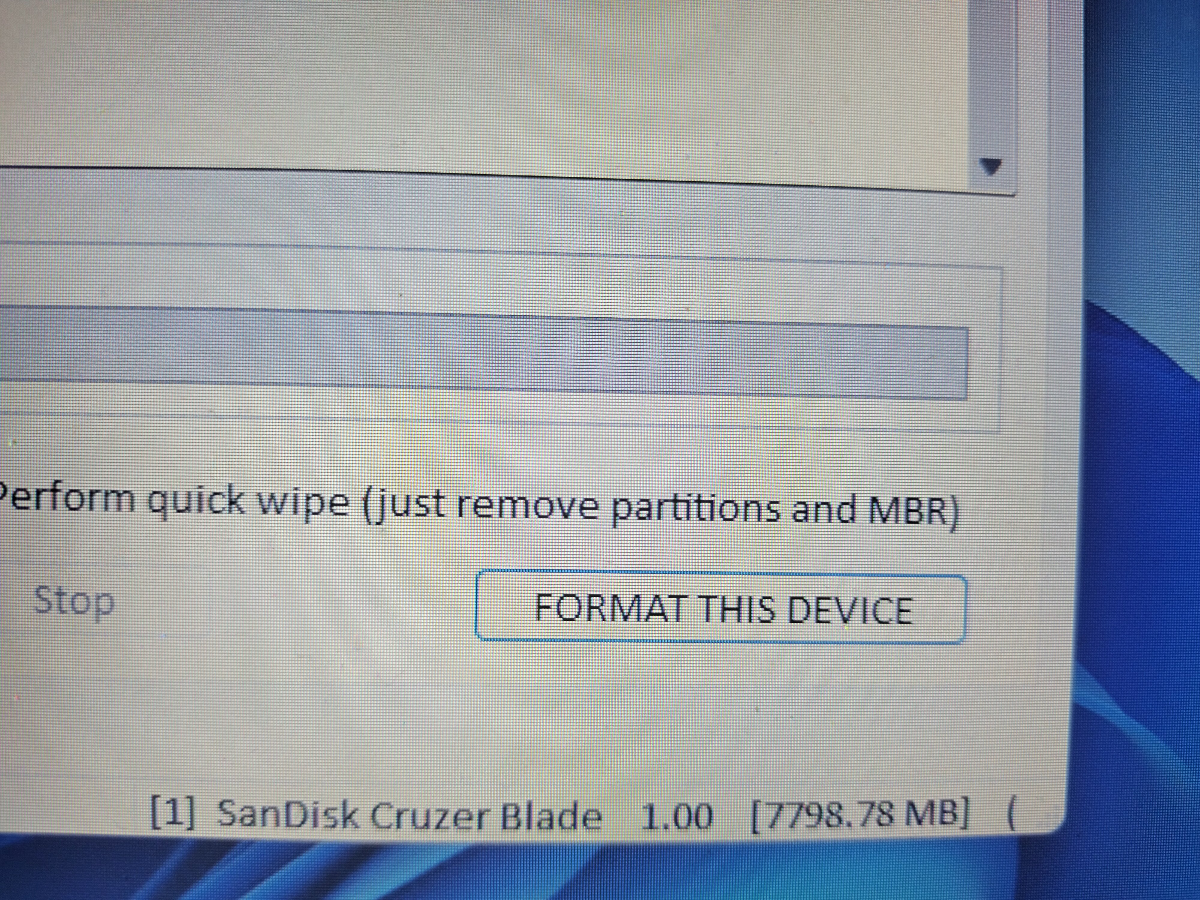

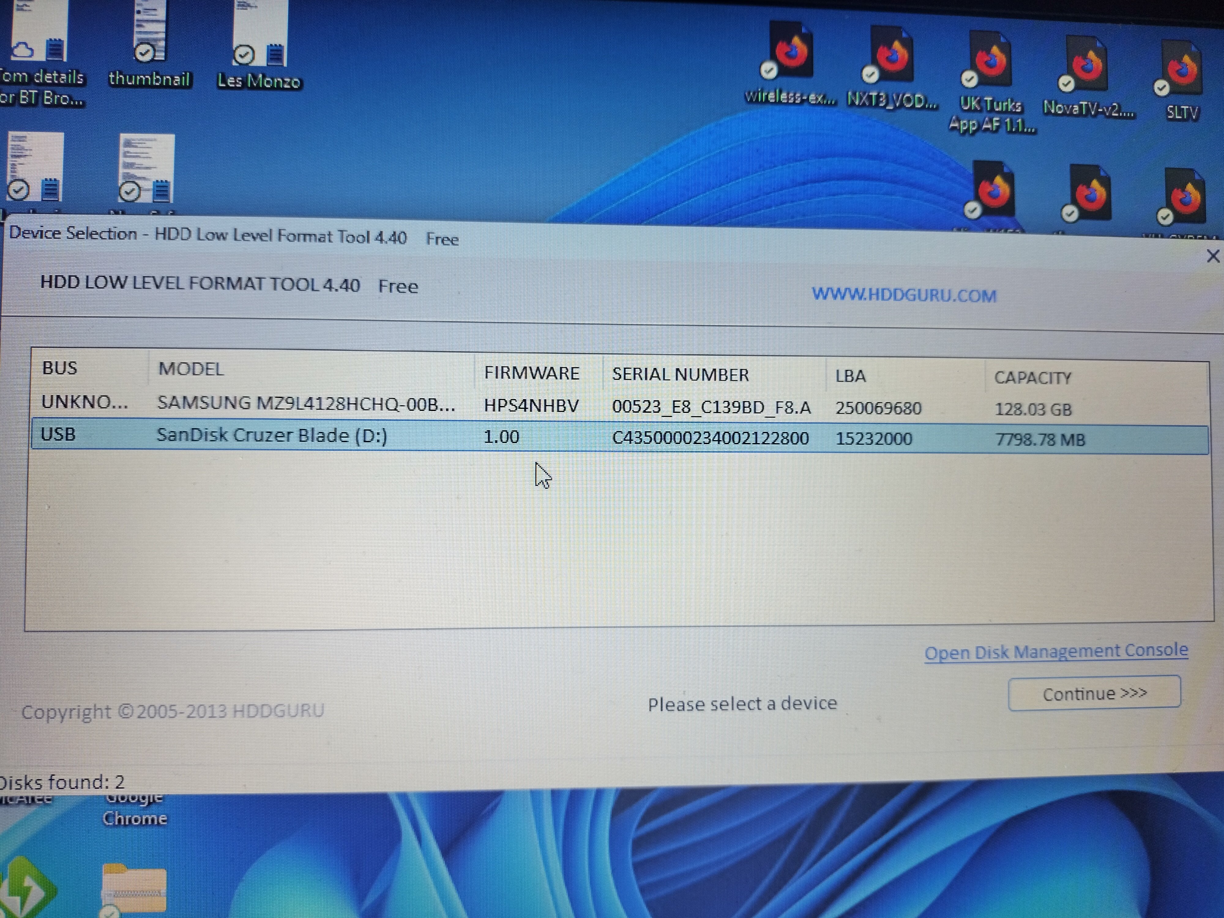

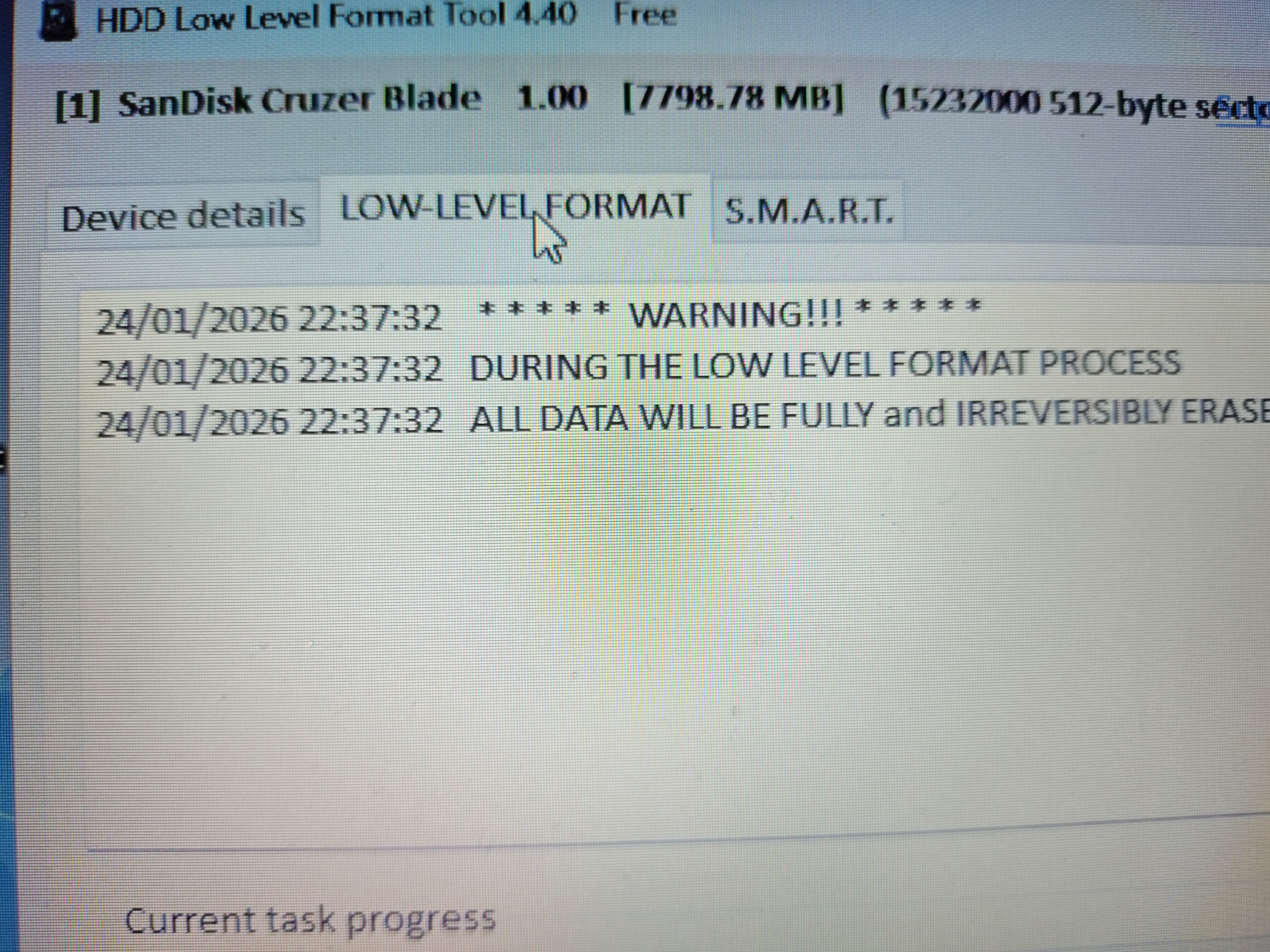

You could try a low level format with HDD Guru then fat 32 on those USB sticks
HDDGURU: Laptop and Desktop Hard Disk Drives, Tests ...
Install hddguru on your laptop.
Insert the USB into the laptop and see if guru picks it up.
If it does click on and highlight it in guru
Select low level format option
Then Format this device
The fact that you didn't know this was here doesn't fill me with confidence that you have been doing it correctly, this is where the standby button is that you are supposed to keep a finger on during flashing, you haven't been trying the remote standby button?
I know there was one on the back and used that one. The button on the face, behind the flap is what I pressed.
It's obvious the USB is not compatible. Ill get my hands on a new one and start again.
