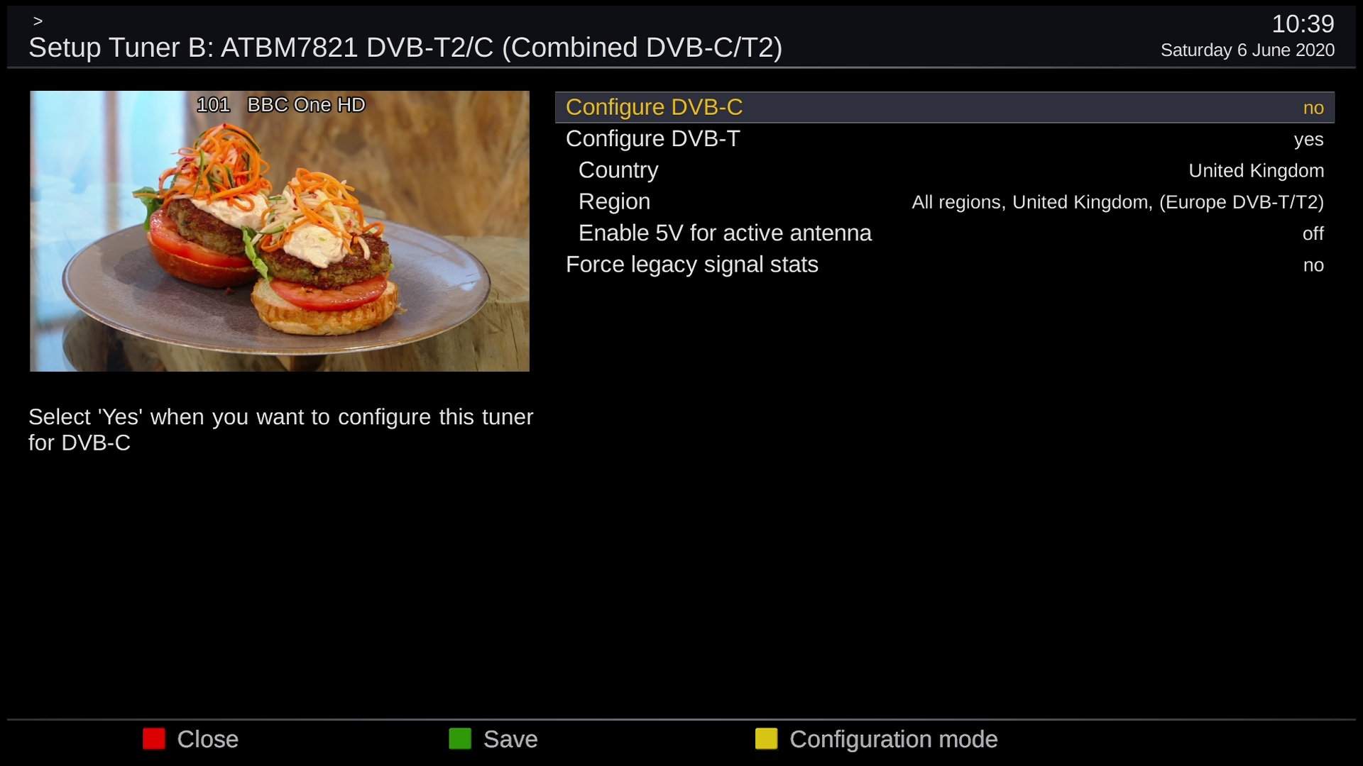

I have tuner B set to vm

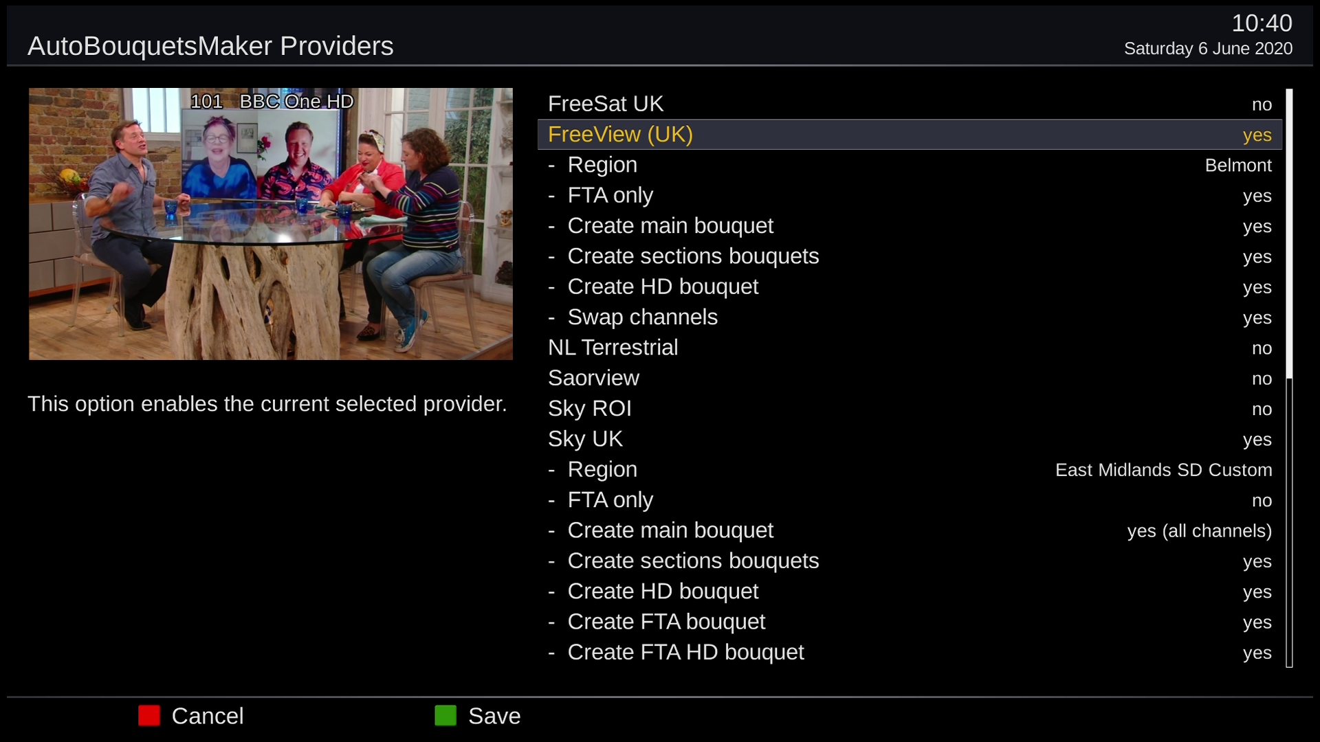

I plugged aerial into tuner c and set freeview Winter Hill in abm/providers
Scanned and got an error on tuner B for freeview.
I had to go to tuner settings.
In tuner B change dvb/t to not connected
In tuner C change dvb/c to not connected and dvb/t to freeview Winter Hill
Scanned and it worked fine

OpenATV is a proper arse to set up because, if I remember rightly, both cable tuners are also set up for terrestrial and you have to disable it.
Yes both tuners set up for cable and terrestrial at the same time.
You have to enable and disable one on each tuner to use cable and freeview at the same time
Autobiuqyetmaker
Failed to tune Freeview UK on tuner c
Edit
It hasn't got my Freeview region on it?
Autobiuqyetmaker
It hasn't got my region on it
you need to know what transmitter your ariel is pointing to. there is a checker on the freeview website where you enter your postcode and it tells you the transmitter you should be using
Edit I'm use the right one for my area
I done a service scan got the ch working but there all ch are mix up how do I organise the channels thank
