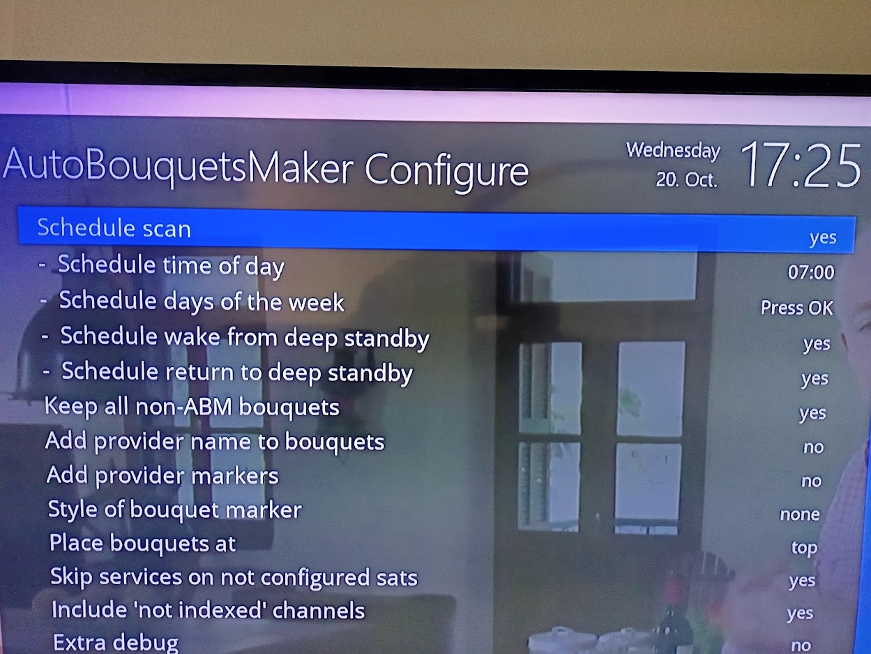

Is epgimporter set to download EPG data at 7AM?
Or autobouqutmaker set to scan for channels at that time?
skoolboy error ladSo I am a bit ashamed, because you got it right the first time. I was looking at the IPTV ABM but I wasn't aware that there is a separate ABM for the sat (not visible in the plugin section)... so sorry guys for dragging this so long, I finally found the culprit. A bit amazed that I never had this issue and only emerged after re-flashing the box.. ah well
