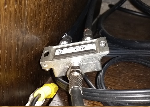

Ok, thanks for that. I've been having a look at the DiseqC switch that I have at the moment(never looked at it since the day it was installed, so bear with me).
I've attached a pic as well, which may serve better than my explanation, but here goes anyway!
So, in the picture you can see two feeds at the back of the switch(one for 19.2, and one for 13.0). At the front I just have one cable coming out of the switch, and this leads into my technomate box, providing channels from both of these satellites.
Just to reiterate I have 2 dishes, one sky dish at 28.2, and the other dish with 2 lnb's pointing at 19.2 and 13.
So, if I were to purchase a new diseq switch with a 3 or 4 way splitter rather than the 2 way that I currently have, could I plug one of my feeds from 28.2(to go with the feeds for 19.2 and 13)into the new switch, run one cable out of the switch to the zgemma(hopefully bringing feeds from the 3 satellites), and then finally plug my remaining feed from the 28.2 dish into the other lnb input on my zgemma, thereby still enabling me to record one channel and watch another on 28.2, but adding the other 2 satellites for good measure?

That's true enough, but I have a dual feed coming from my dish at 28.2, so with the hypothetical set up that I described if I had a disecQ 3 way splitter with my 19.2, 13.0 and one of my 28.2 leads all running through the switch, and have the other input lead from the 28.2 running into the 2nd lnb in, on the zgemma? Would this work?
Er, yes - I guess it would... I have never used a disecq switch before (I have motorised) but with a little tweaking with tuner config i'm sure it'll be doable.

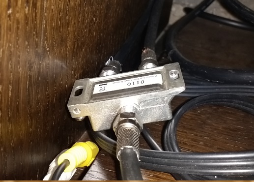

As you have said, you have 2 cables coming from 28E, (from a twin lnb I presume), then it will work,

Ah, that's not quite right. Probably the way I described the set up.
I've only got one lnb for 28.2 but it has a dual feed, so I have two input leads running from it, both of which go into my zgemma at the moment.
I want to know if it would be possible to run one of these inputs through the disecQ switch, and the other input into the zgemma, thus giving me 28.2, 19.2 and 13.0 on one lnb input on the zgemma, and my other 28.2 feed running into in the 2nd lnb in on the zgemma.
Still effectively the same thing, isn't it? From a functional point of view.
A twin lnb is an lnb with dual feeds.
Yeah but the second tuner on his box is going to be connected to the disecq switch. Though it seems to me, running the second feed from the first dish into the switch will, for all intents and purposes, be effectively the same thing as having one feed from one dish and one from another for 28.2E.

Just been outside for a gander and it appears to be a Sky quad LNB that I have(one LNB with 4 outputs), with two outputs in use.
It's the same dish that I used in the past with my old Sky+ box, where you needed two inputs due to Sky+ having two tuners.

As I said before there's no reason why a new diseqc switch won't work, here's one for lesss than a fiver,
