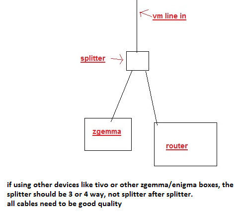

if you bypassed the splitter and plugged the incoming vm cable into the box, what cable is feeding the router?
Are there other splitters in the setup?
the setup should be like this:
38487
if you remove the splitter completely and put the single incoming vm feed cable into the box, then reboot the box, what's SNR then?
