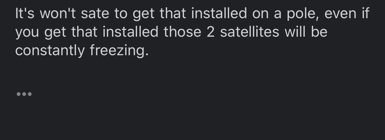

I was told by an installer it’s not possible to install 1.2m Motorized to get 7E and 10E it has to be a fixed dish is that true ?

I dont believe that,
for all practical purposes once the dish has moved to the position it simply acts like a fixed dish.
Would it make a difference if the dish would uve to be installed on a pole as I have no south facing wall
I have 1.2 meter dish and still stuggle to pick up some of the Feeds mike142 post's on 10 east,I can get them on 7e but 10e can be a struggle even though i can scan in all the KU band channels listed on king of sat.
ok,
sounds like he is covering himself that if you get movement on the pole and your sats keep freezing he cant be held responsible
fairly sound business practice on his part, and just letting you know possible problems,
but, thats a lot different from what you first claimed.
he basically doesnt want the hassle of you come crying if you dont get good constant reception
