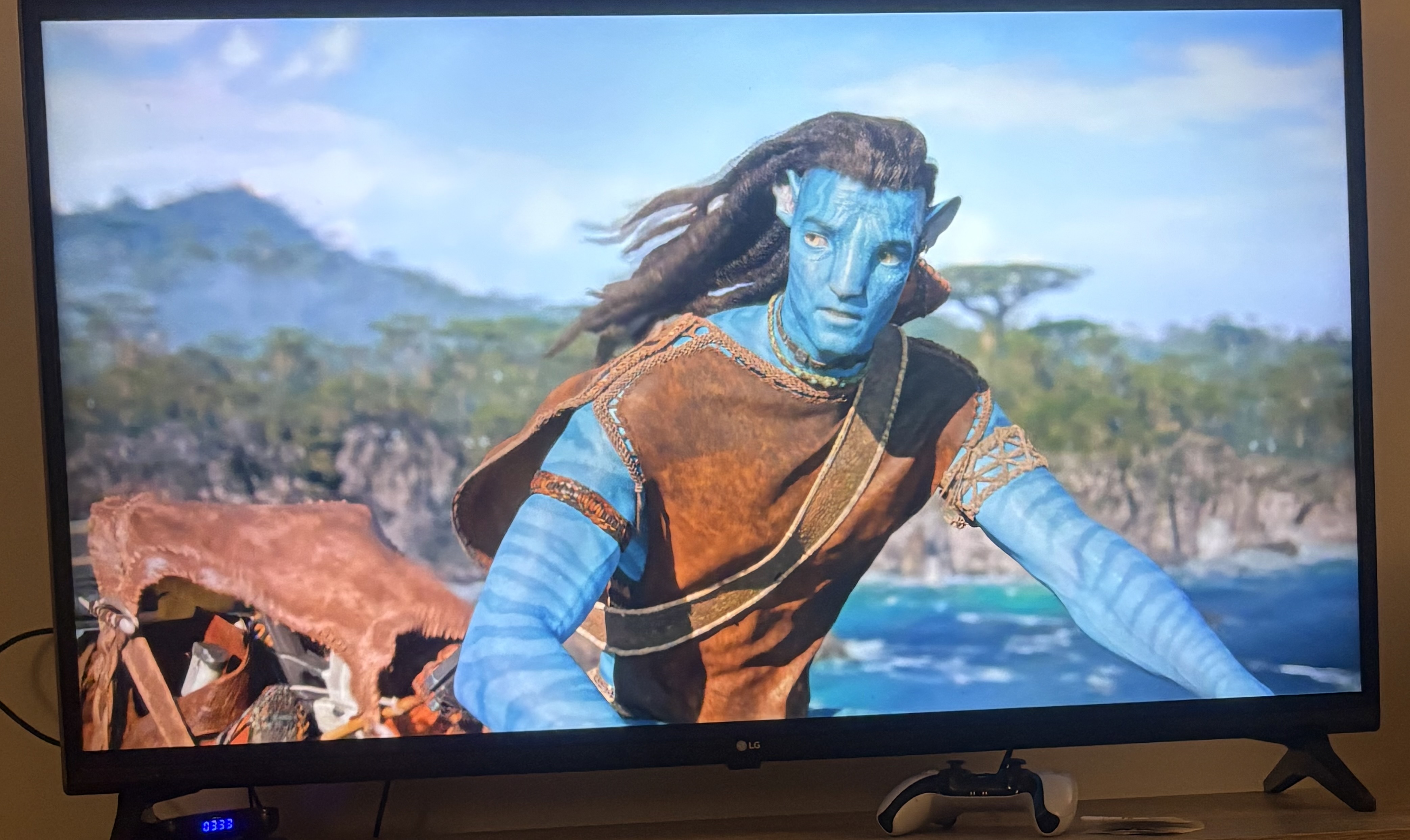

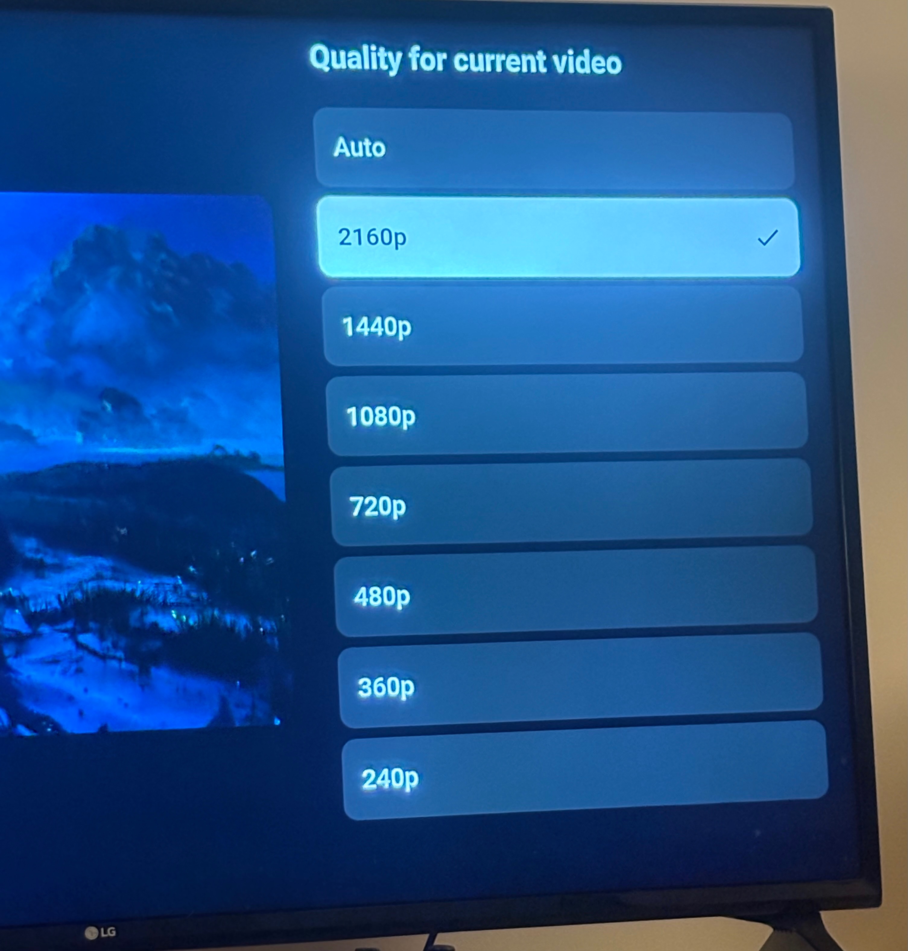

Can confirm this box doesn’t like 4k it’s really choppy. It plays but it’s like slow motion jittery
Unless there is something I can change
What went wrong you said it was good on uhd the other day?

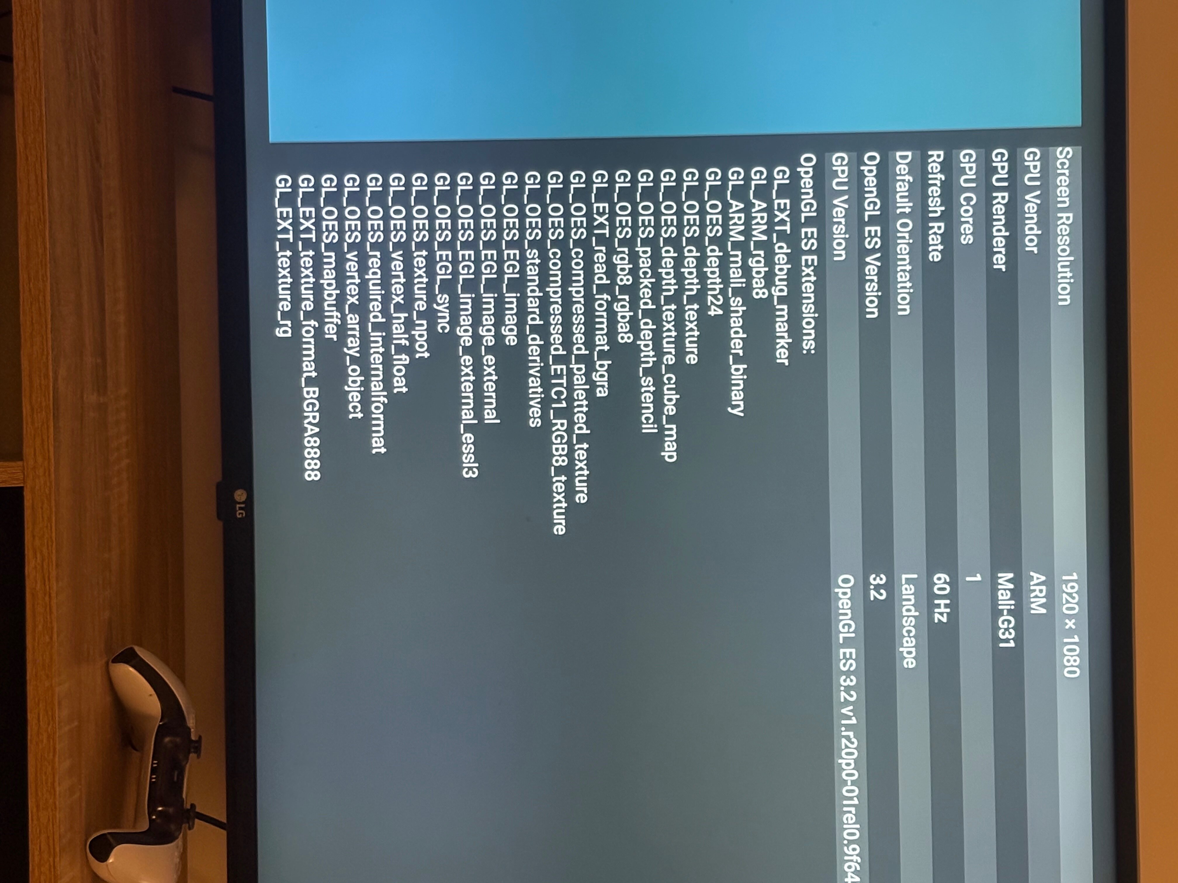

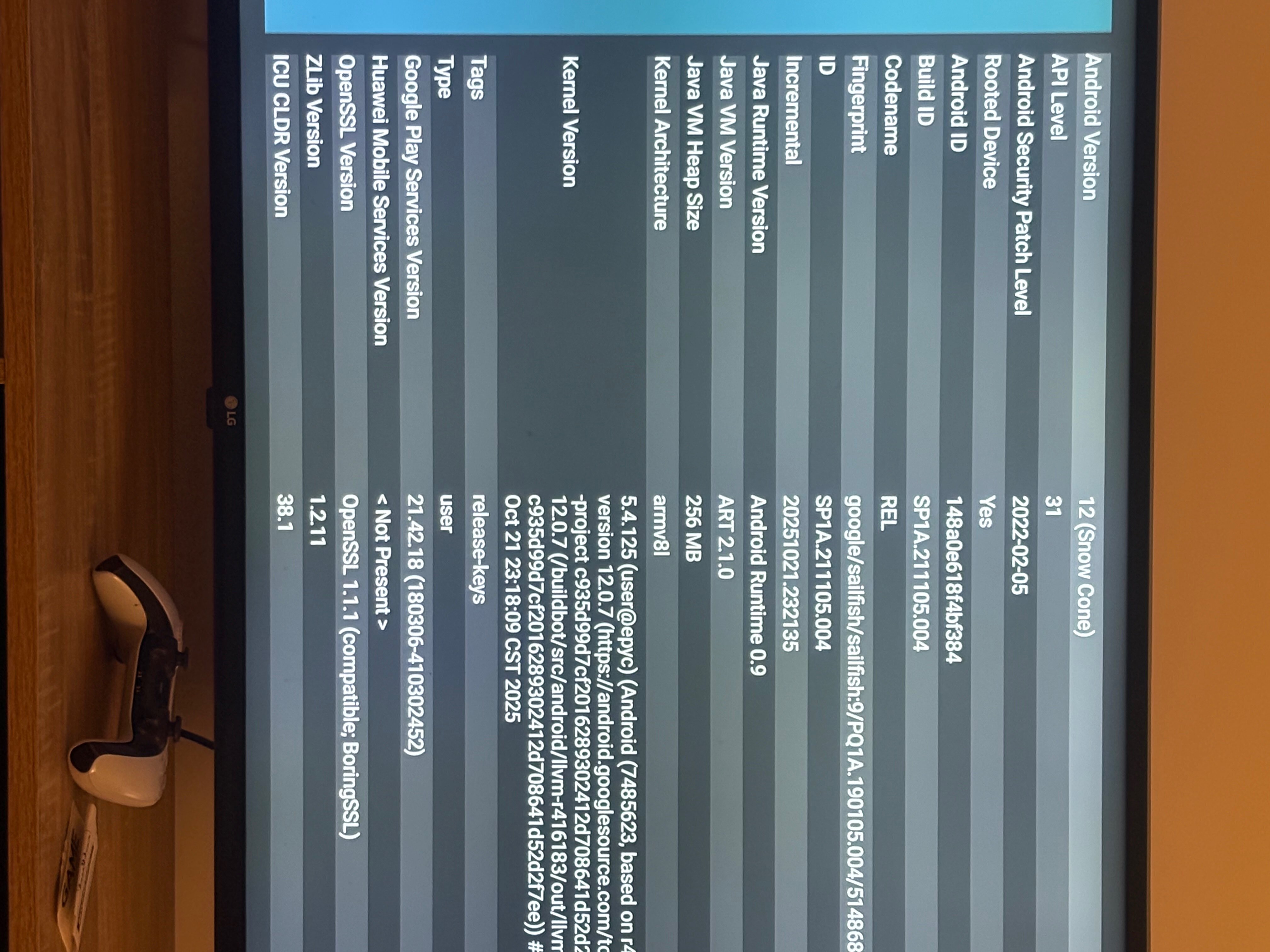

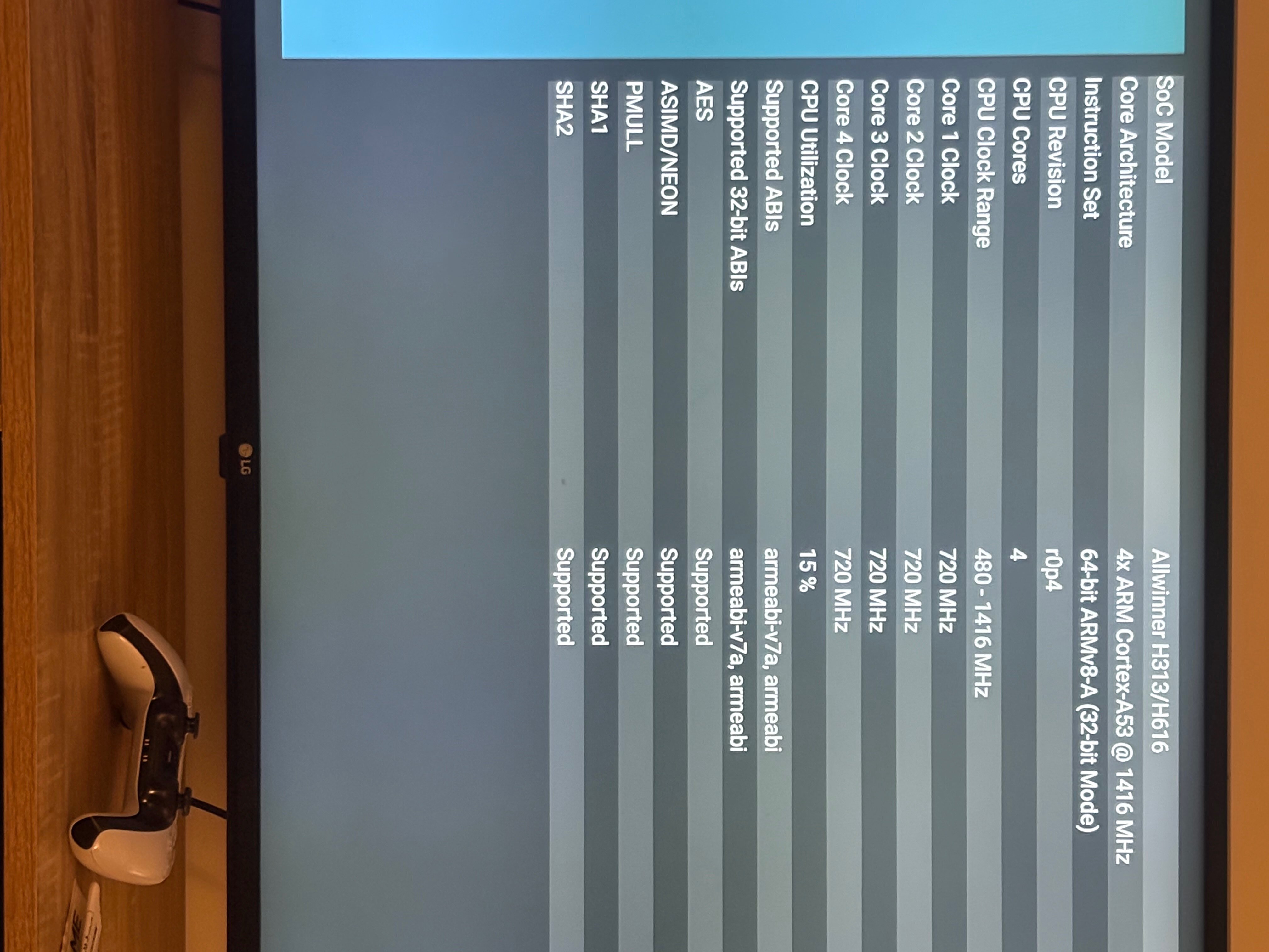

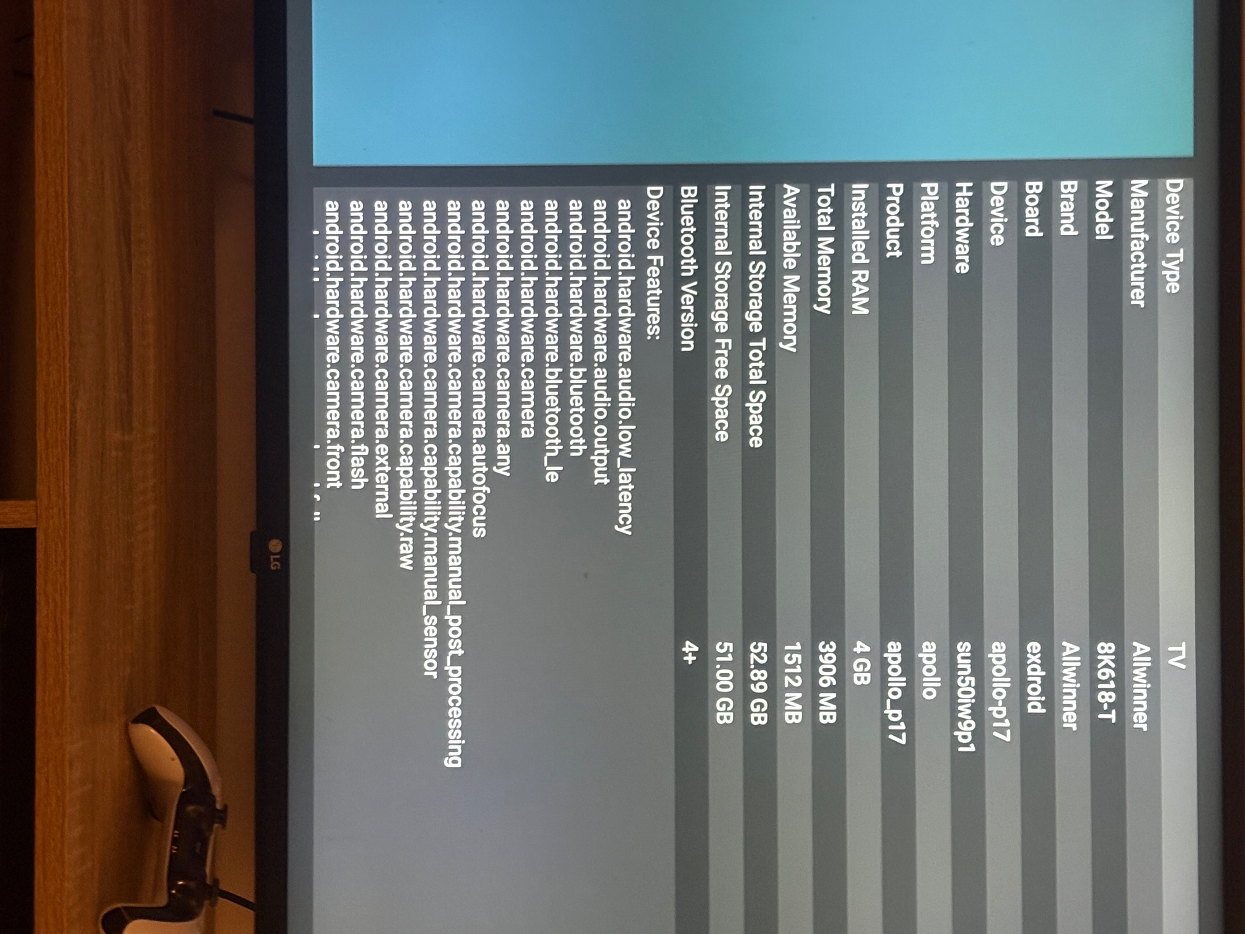

Run aida on it to check it over seems ok. Not sure why it sees two memory cards on internal one external

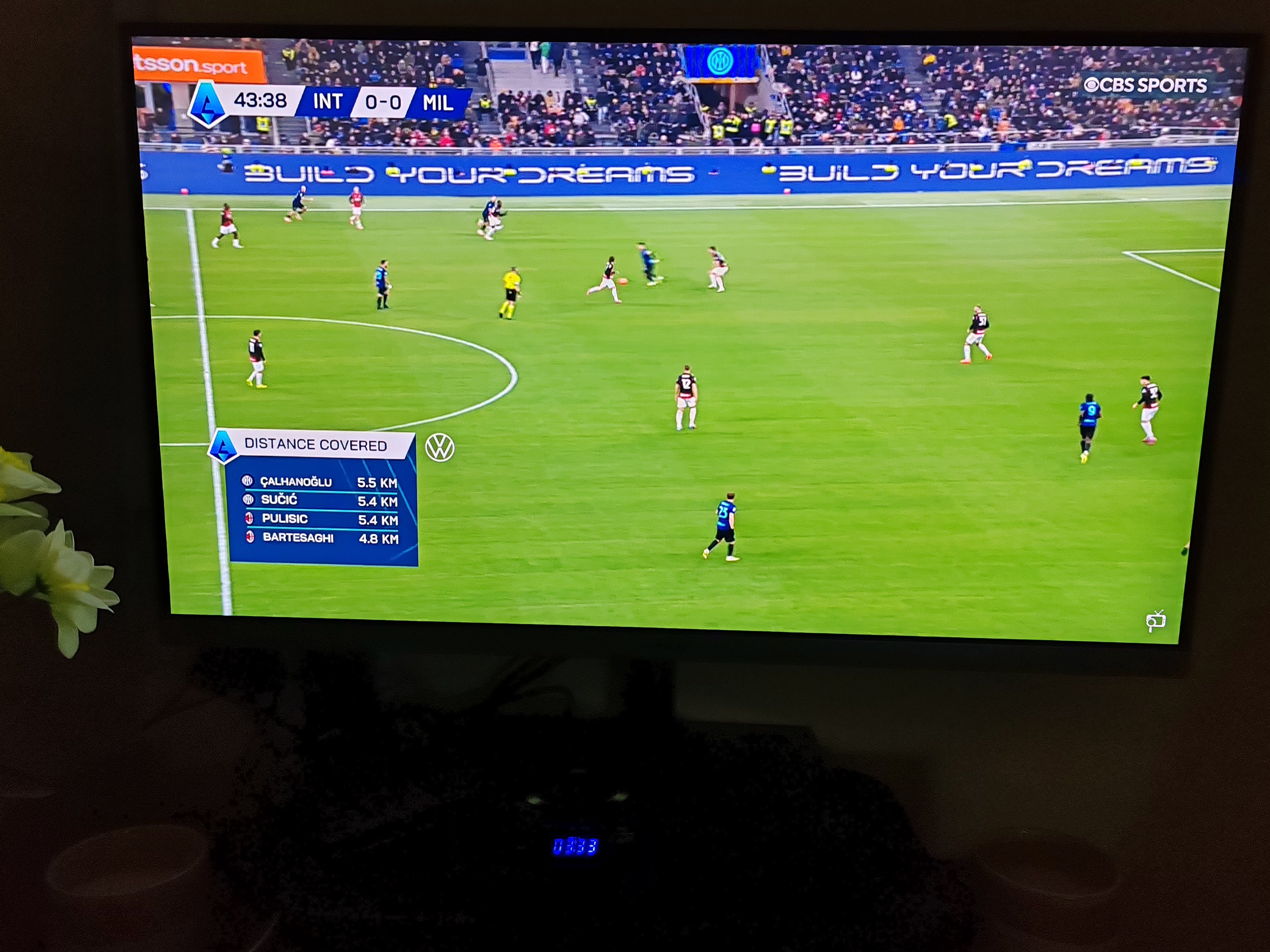

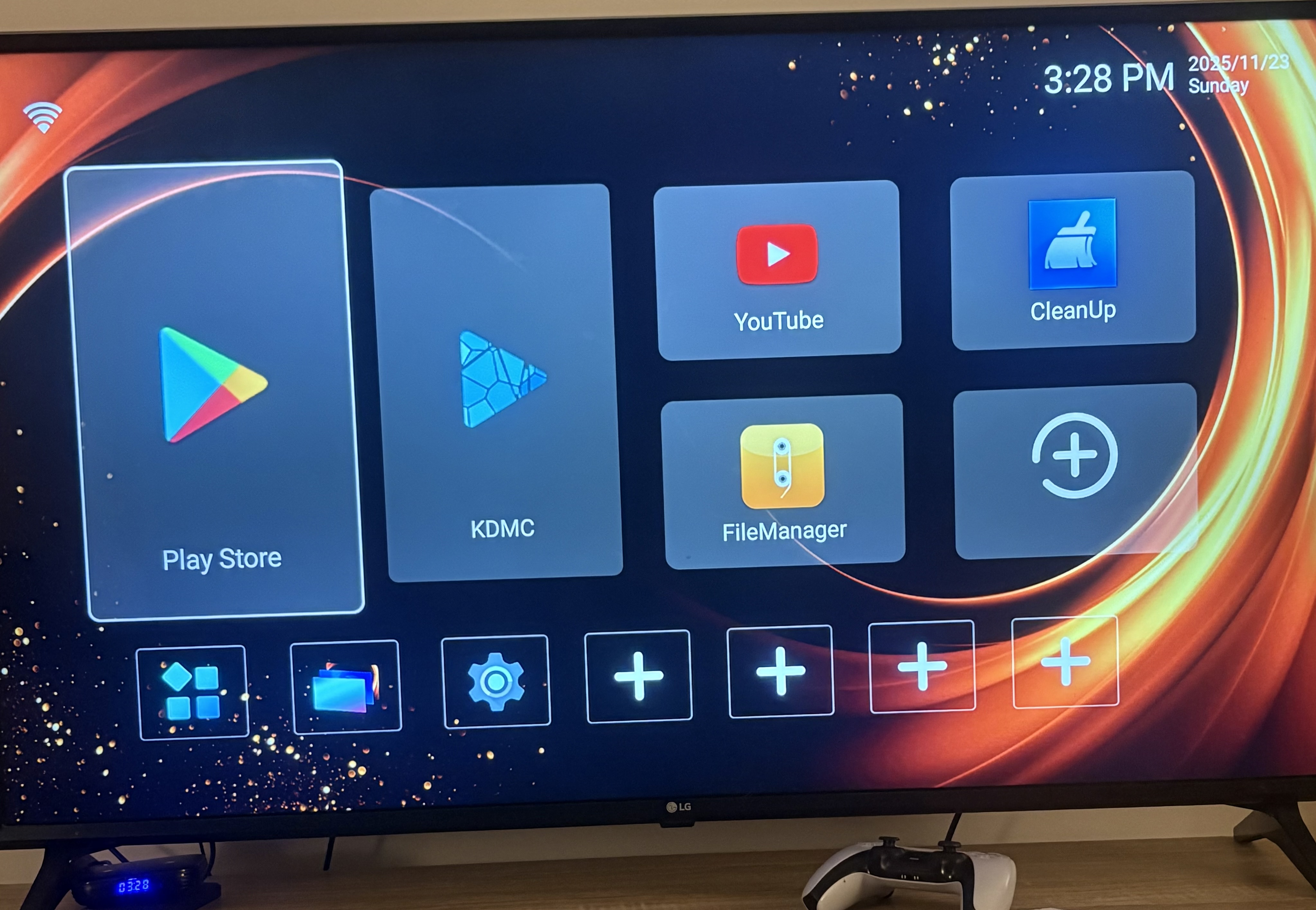

Mine connects fine to both 2.4 and 5 ghz you tube 4k plays Exellent although there's no fast moving items. Footie runs good and not choppy on mine, on vm in mowdem mode via Asus router.
