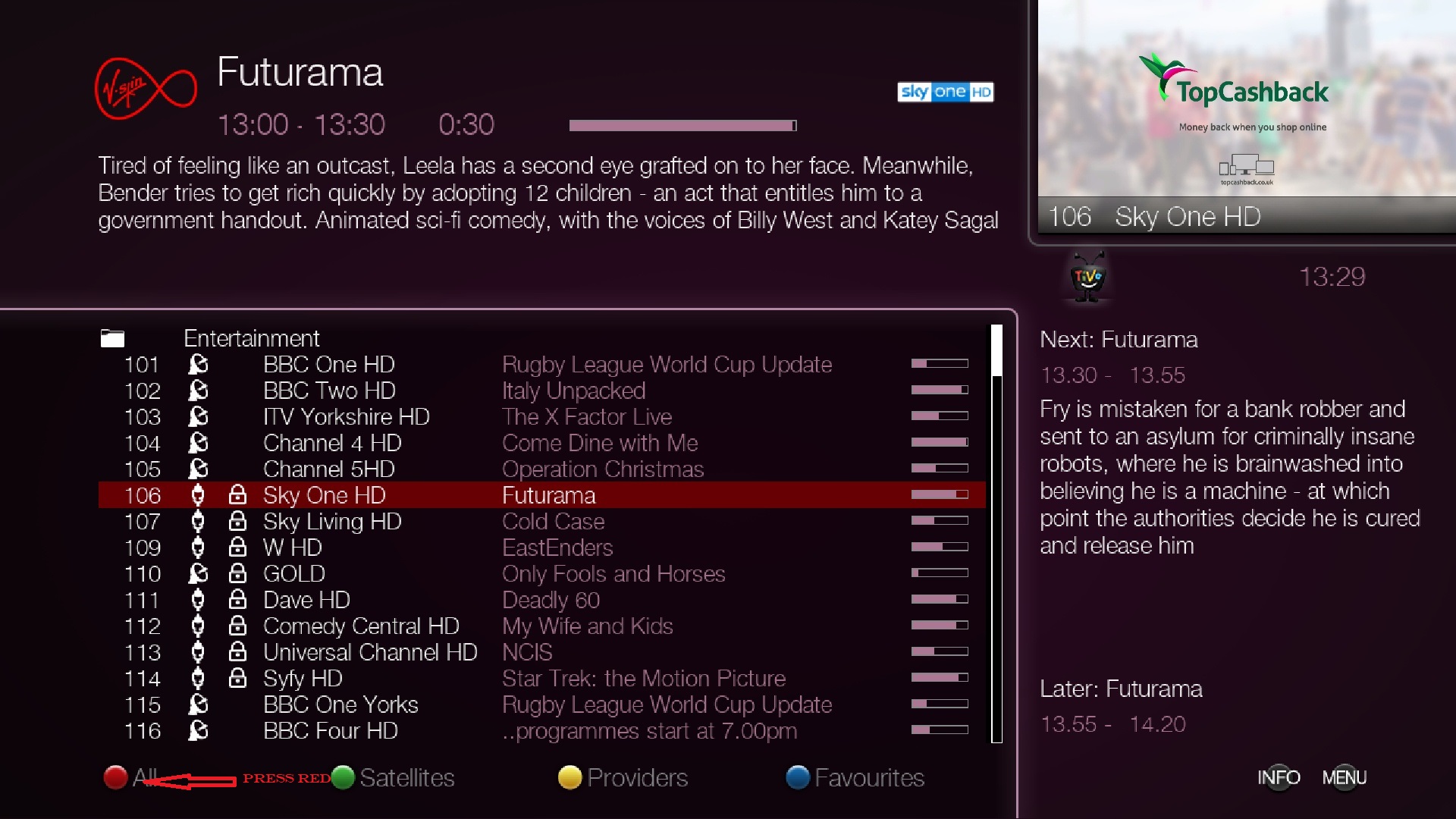

This maybe confusing for people using CustomMix to swap Virgin channels wth Sky, either find the channels in the latst All channels bouquet or wile on a channel press down button for channel selection
Wilst on the channel selection screen with the channel highlighted press red for all

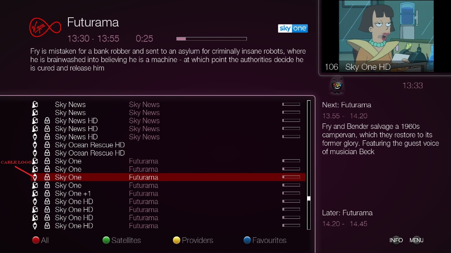

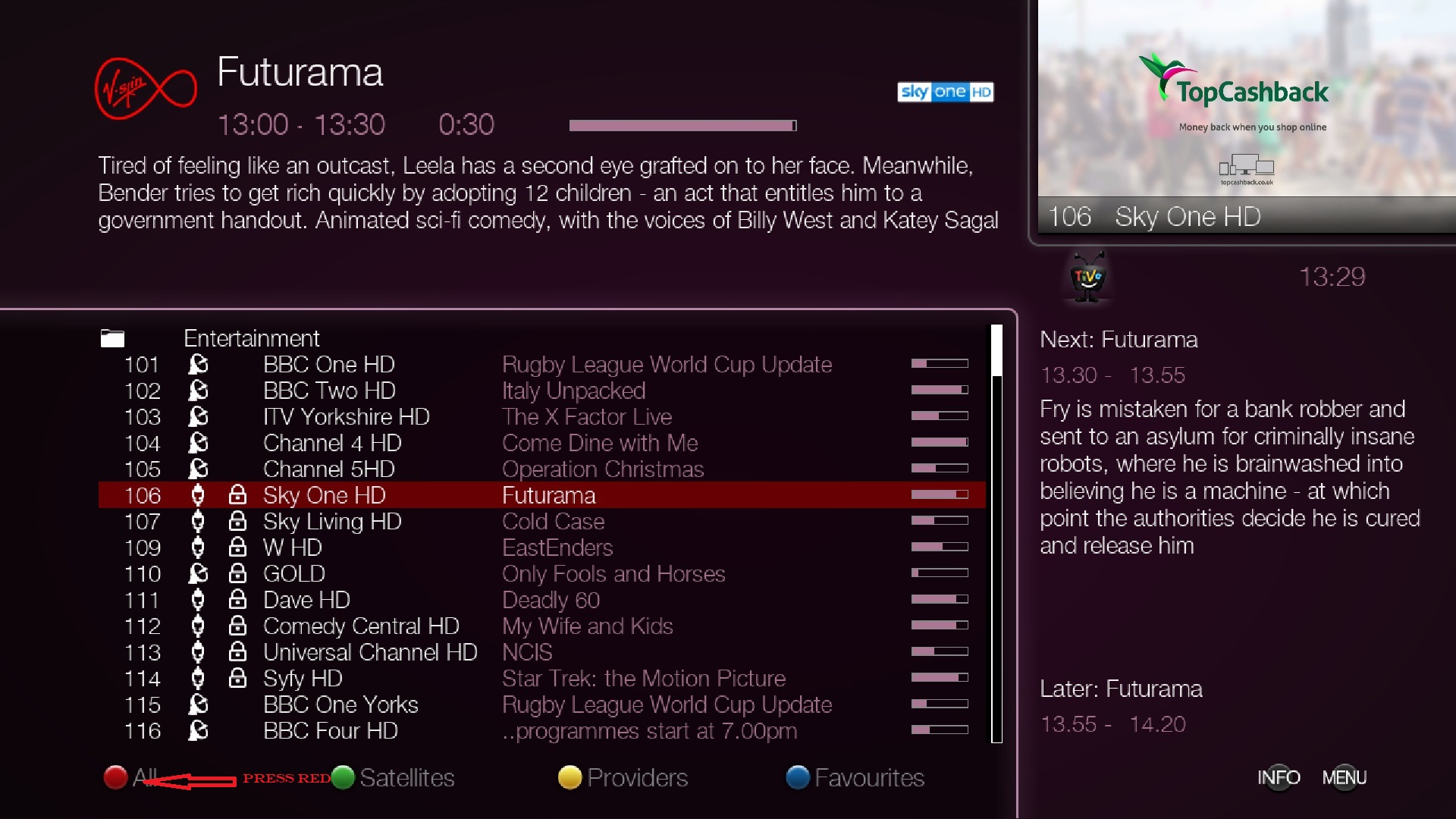

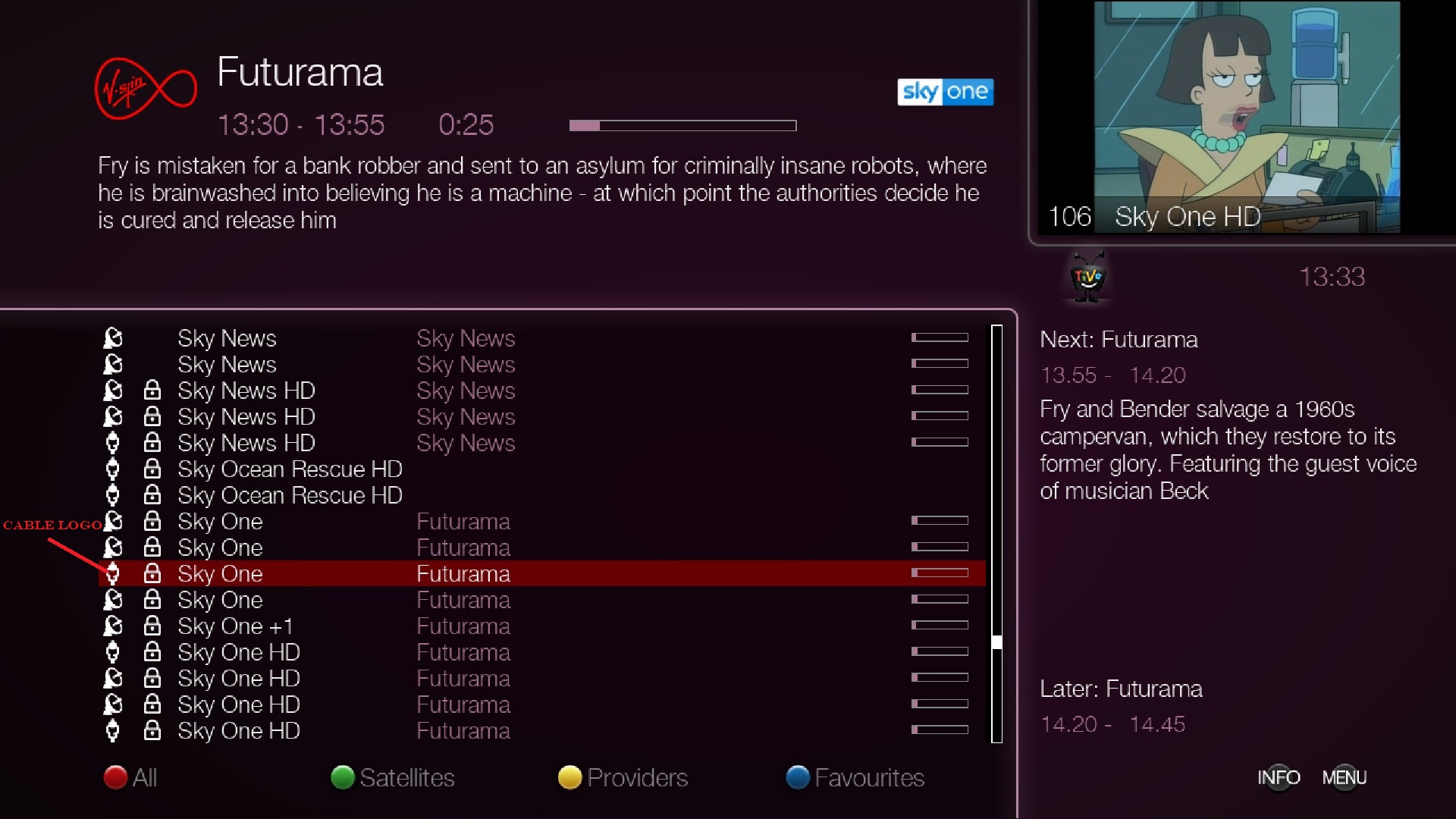

This will show all versions of the selected channel choose the SD version with the cable logo
