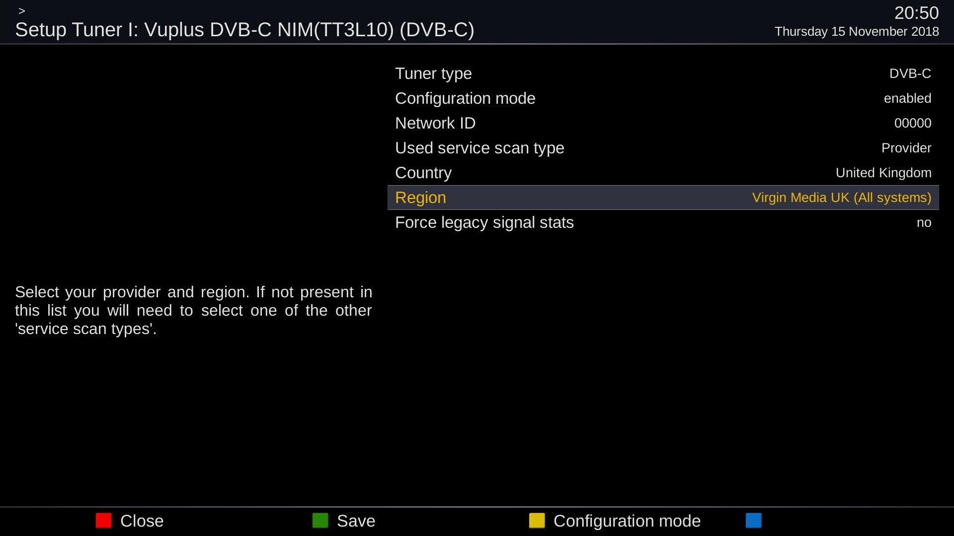

Set all Cable tuners to Virgin All systems. It does not matter what NetID you use in tuner config.

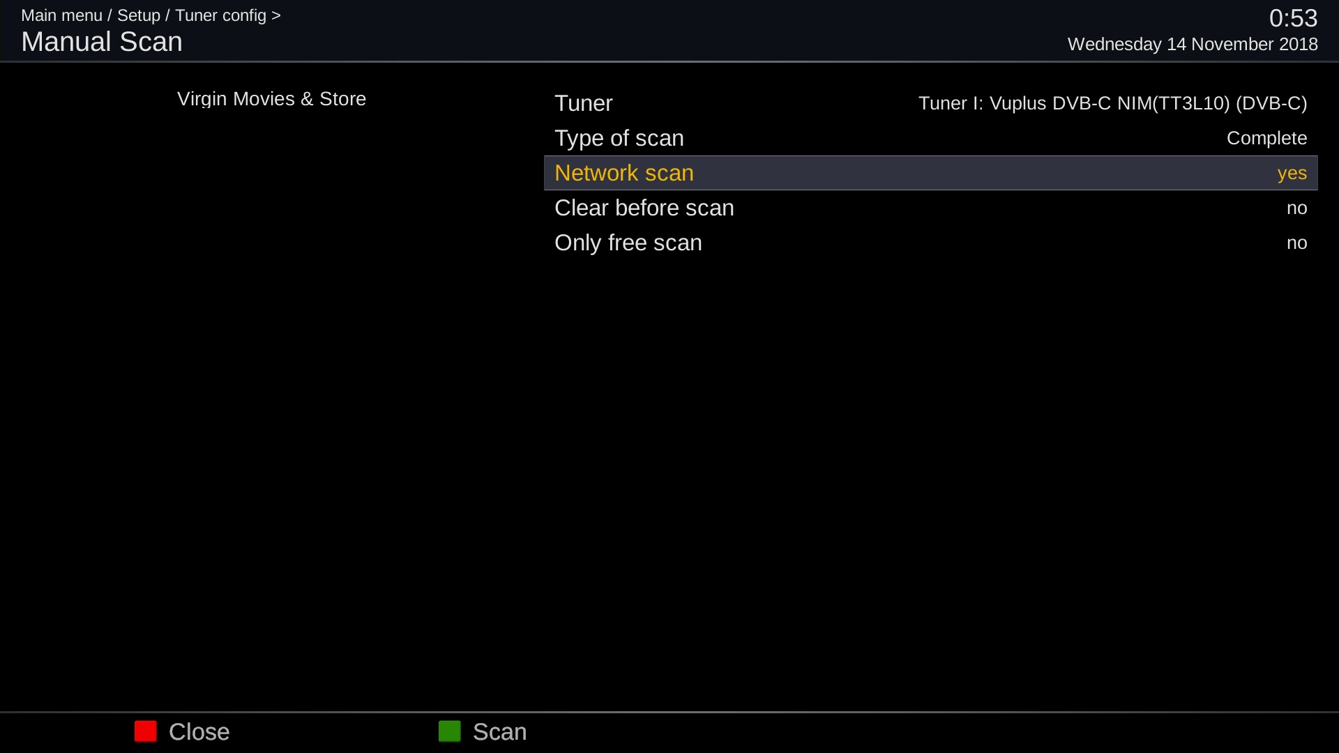

Perform a non-abm scan. Use manual, not automatic. Make sure you select complete. See the screenshot if unsure.

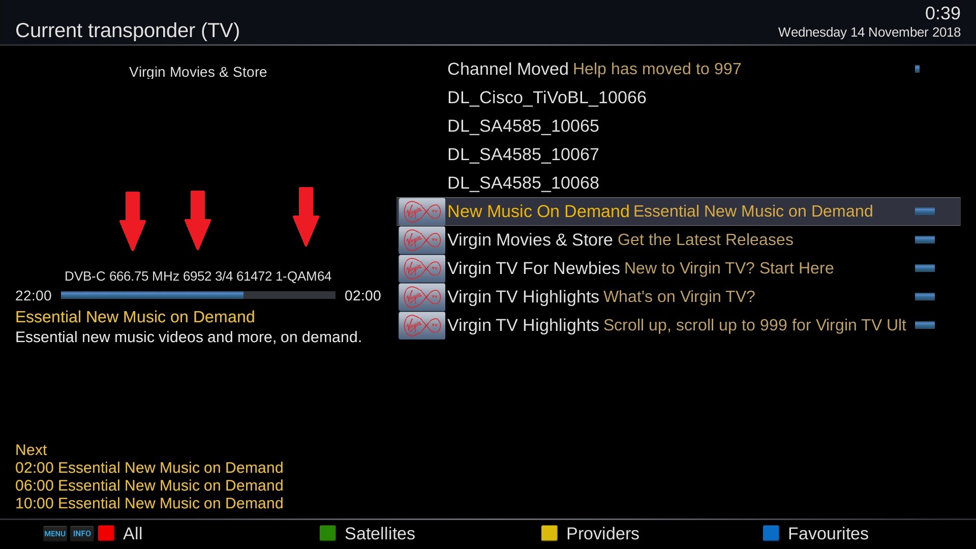

Once the scan has completed, check what the details are for "Virgin TV Highlights", "Virgin Movies and store". Most skins will show you the details. Picture attached.
Qam 64 = Modulation 3
Qam 256 = Modulation 5

To avoid ambiguity, please post a screenshot showing the frequency with the following channels: We can get the details from your screenshot. Also say what your NetID is.
DO NOT SHOW YOUR SERVER DETAILS
Virgin TV for Newbies
Virgin Movies and Store

Make sure you select complete when performing a scan.
