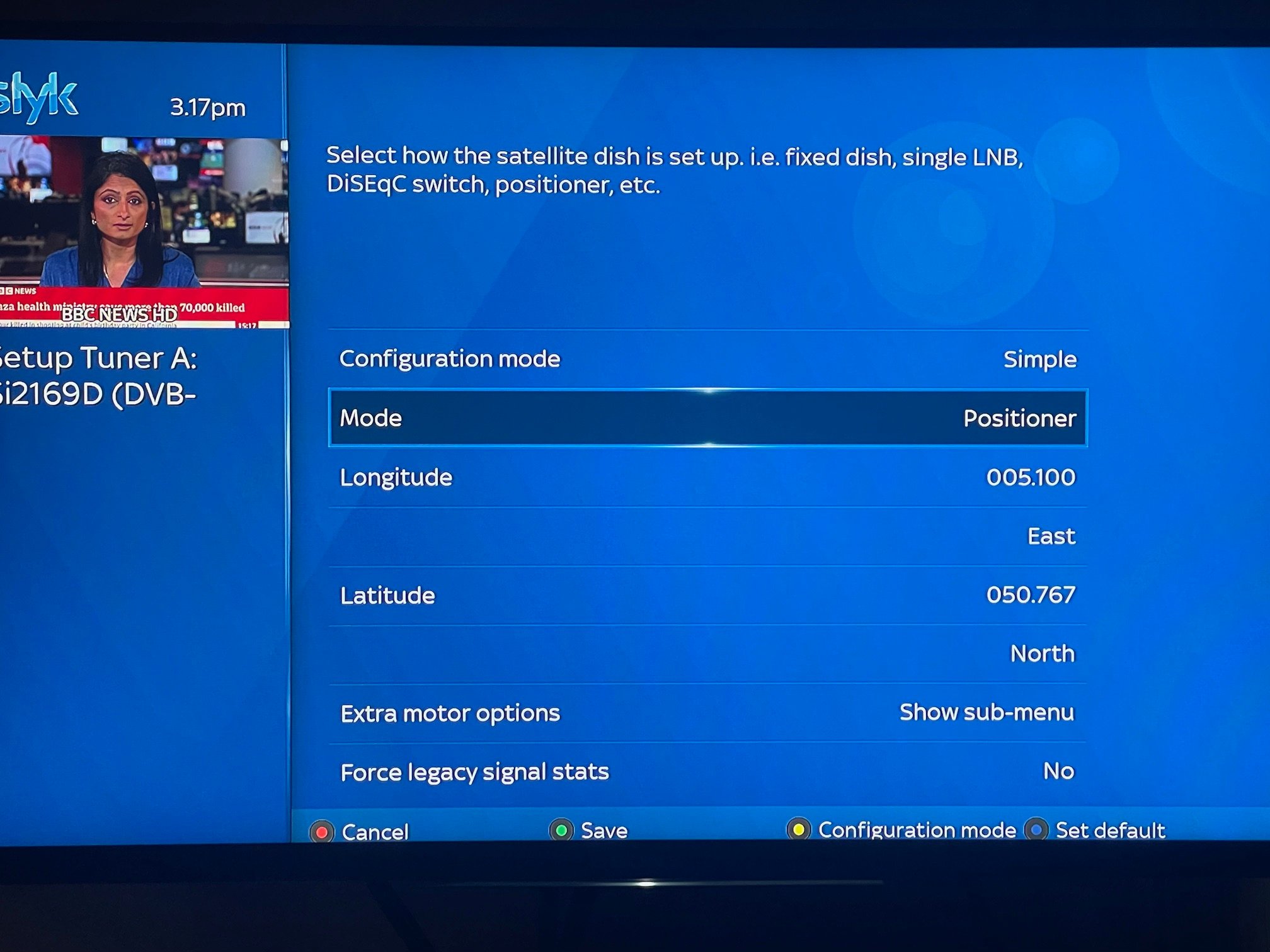

go to tuner B on giga and make it like pic but put in your values and west then save. under mode you toggle.

To use USALS motor controls, you set your tuner with the wire to the motor as pictured. Obviously adjust to your co-ordinates like you did on the Viark.

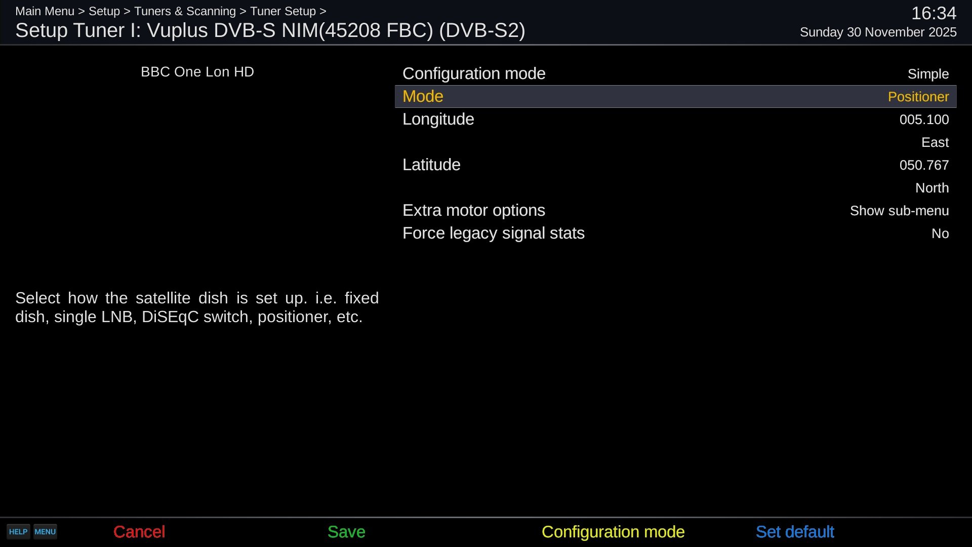

Sorry bud. Here are some photos/videos of my settings.
Software
OpenViX - 6.4 series (See photo)
Gigablue UE 4K HD
Tuner B settings
Config mode - Advanced / USALS set to yes
Looking at your photo above it looks like I need to switch to "simple"

Thank you guys - I think that is where I have gone wrong on my e2 setup, I have it setup weirdly at 1.2 as I thought that was the only way to select USALS...
Which begs the question.... why it moved in the first place with such a weird config!
Just need to try to set this up now and find a channel list
