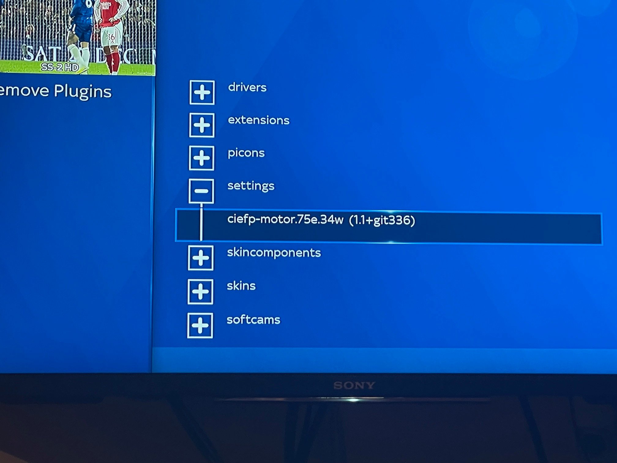

I wish you would go a bit slow!! I'm watching Chel V Ars but to flash the correct method is now called couch flashing, you go menu setup vix image manager, yellow, openvix select 6.8.001 and follow prompts. then when back go to plugins download from settings and look for file I posted above, load that and you will be good for 75e-34w.

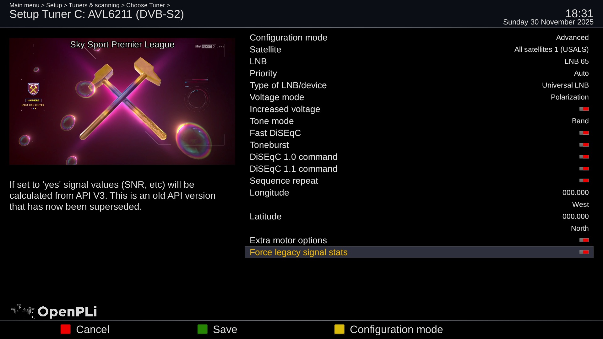

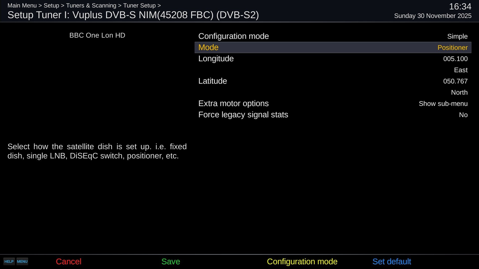

Nothing really. It's valid. In your screenshot, you are selecting advanced in order to select a simple configuration. More than one way to skin a cat.
Another option is "USALS selecting satellites". It allows you to select which satellites to make available.
Is the above config still different to what I posted i.e. isthe config I posted erroneous (as the above looks slightly similar)
I have just looked at your video, you are using different LNB numbers. You only have 1 LNB so it should be 1 for all of them.
You can do it in advanced mode if you want, but you then have to select it for every satellite. Correctly. Unless you do it like Pieeater.
Surely easy and simple is first approach to use for most things in life? Its less error prone. (You even made an error on just copying and pasting a command 🫣)
All good - I was just checking that my config was still the issue
And manic stop laughing!
I was keeping it nice and simple ie the KISS principle as I can gather user is no expert. Now that he is sorted I can reflect on the PIC by
pieeater2015 and wonder HTFck can you use USALS with a setting of 000 for longitude and 000 for latitude!!!​

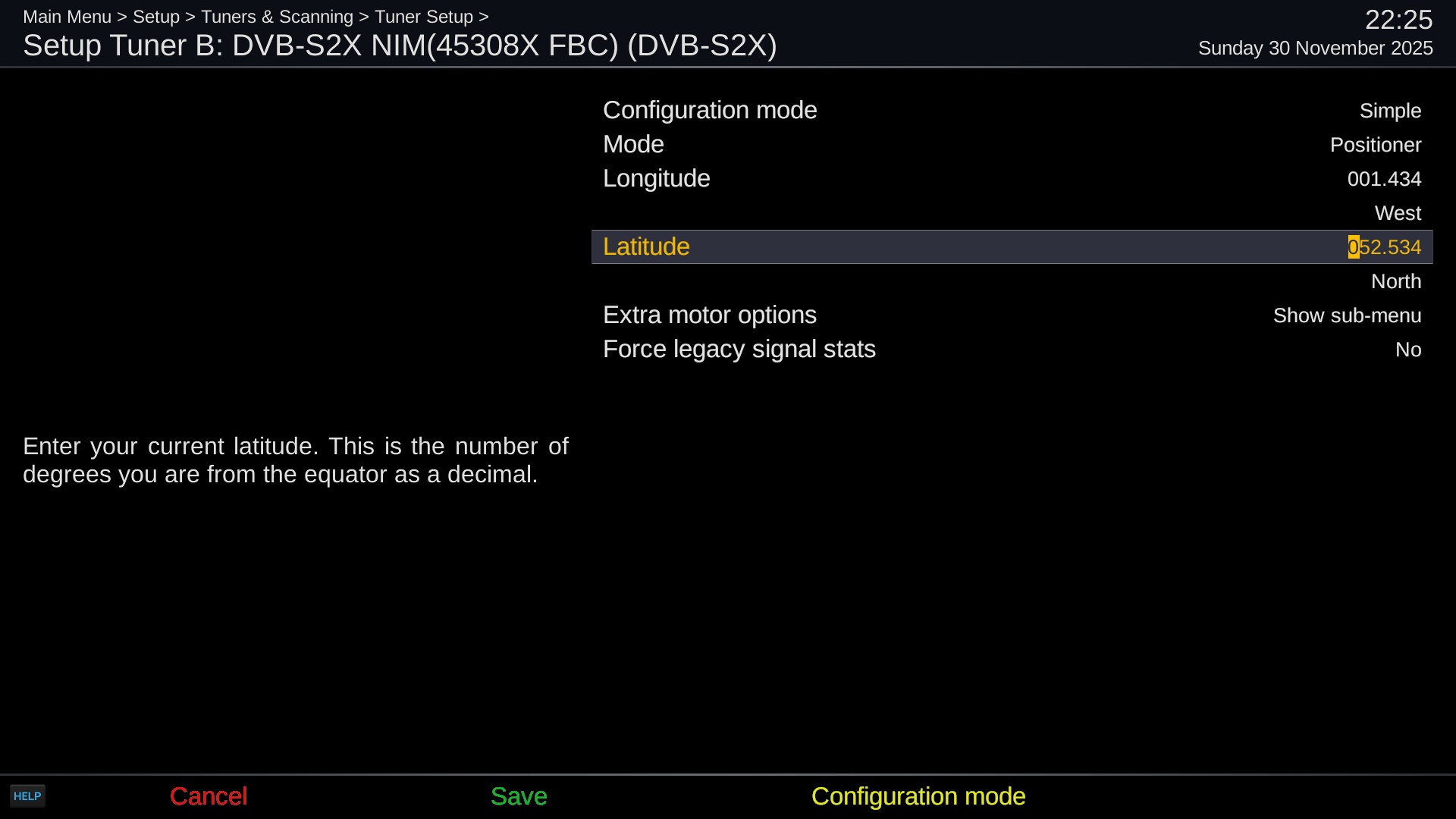

Ok. A short progress post before bed - very much appreciate everyone's help thus far. New VIX image installed (latest).
Current setup of "TunerB"

Reset tuner settings in "Tuner B" as above - removing old settings
I need to figure out where the dish is currently pointing and attempt to get it successfully moved onto a sat.

2. New settings based on simple configuration mode / positioner done

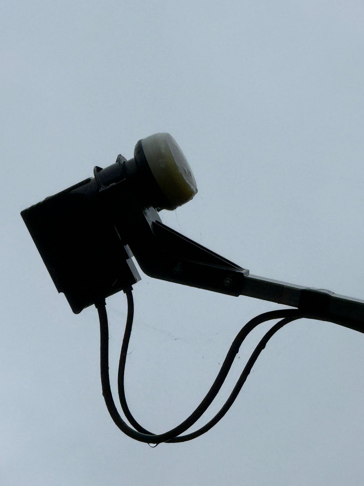

And I keep meaning to ask is that a dual lnb? I would use the giga to move dish and have spare cable going to Viark ie not use Viark.

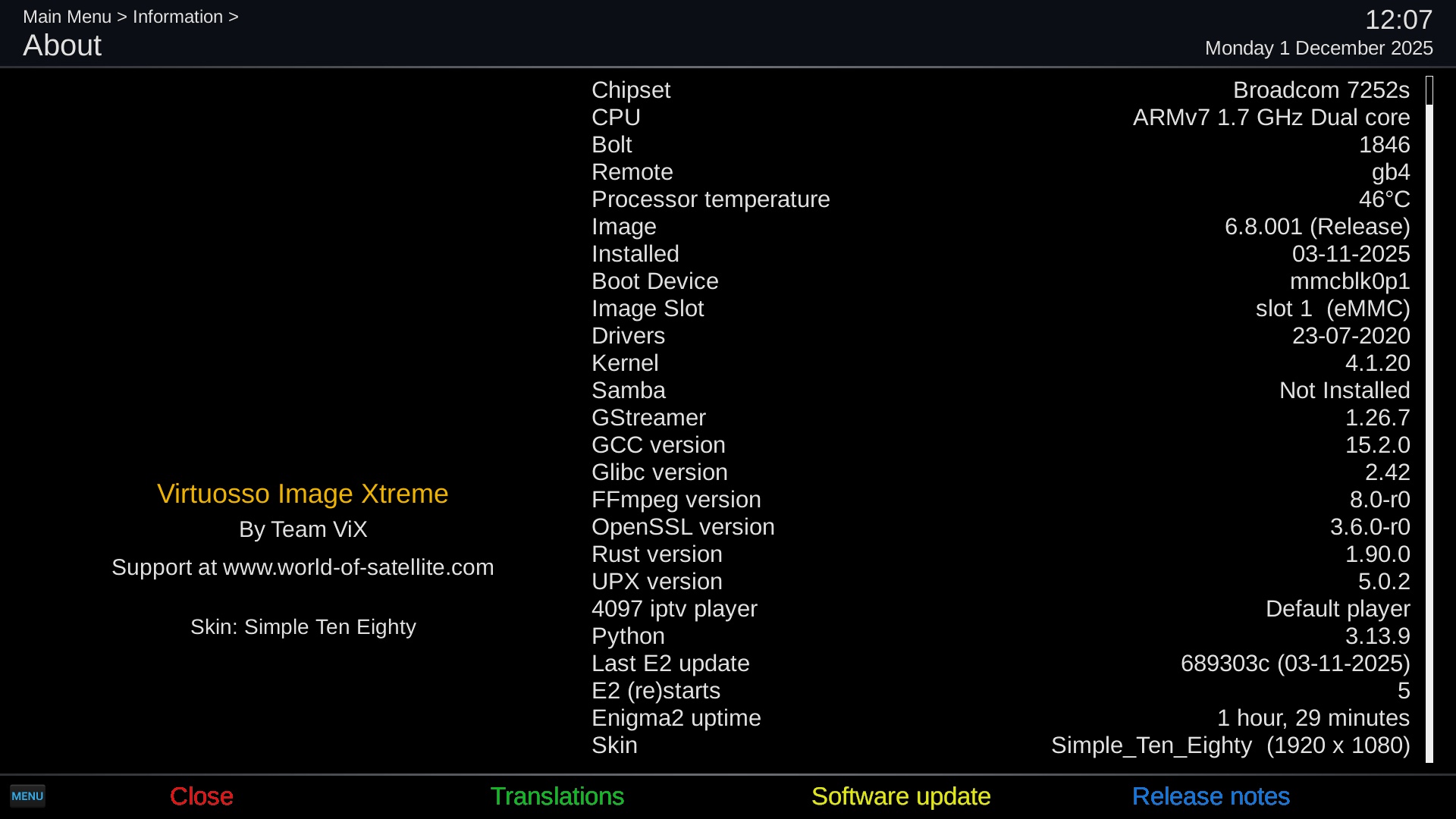

I have not changed the skin. It's the standard skin that comes with 6.8. Simple_Ten_Eighty (1920x1080).
I'm not 100% sure what LNB I have - here's a photo of my LNB - looks dual?
Skin / box info below:
