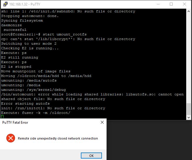

Appreciate the advice. I gave it a go and twice it has stopped at the same stage with Putty closing for no reason:
On the Formuler box there is an option to restore the WilloBuild. Any advice is appreciated.
I have a usb key permanently inserted. After both fails there is a system installed and showing channels, not fitting the screen correctly, etc, no bouquets but it's there. I'd just like to be able to run the full install without it crashing,
USB maybe corrupted what make is it
mymemory,com usb 3.0 used for a couple of years exclusively for this box. How can I check it? My other machines are windows.
Just initialise it before you begin, this will format it completely, not sure where it is in the Vix menus but in atv it's; menu, setup, system, storage devices, initialisation
Thanks. I retried but it gave:
Archive: latestvix.zip
inflating: formuler1/imageversion
inflating: formuler1/kernel.bin
inflating: formuler1/noforce
inflating: formuler1/rootfs.bin
unzip: write: No space left on device
unzip: inflate error

No space left on device means it can't see the usb device, use a different one, whichever one you use, you need to initialise it first
I initialized my one, just like you told me and it worked 100%. Do I need to do anything to it after it initializes?
