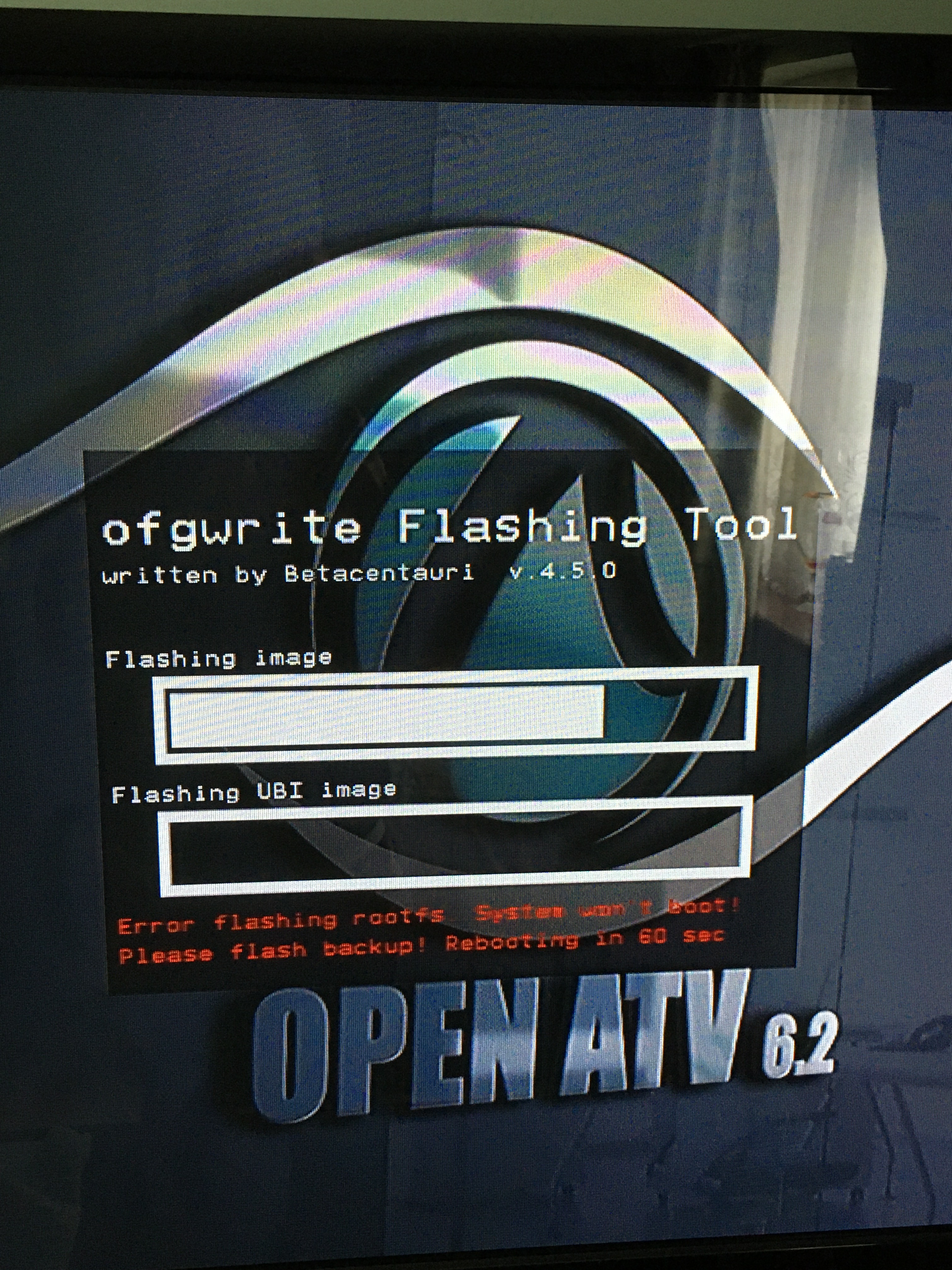

I am trying to flash grogbuild i followed the guide but i get an error. i have attached the screenshotIMG_1377.JPG. I had to also plug in a USB stick as the grogbuild could not find a drive any help please

tried the putty method still getting same error on my tv screen. i have open atv 6.2 do i need to update to 6.4 then use grog?.
