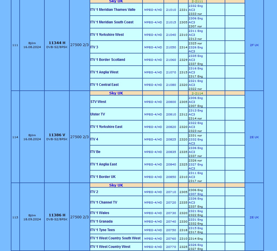

they have changed frequency itv2 hd is 11386H 27500 2/3 DVB-S2 8PSK and scan be and other may appear as well.

STV HD is also on 12168 V 27500.

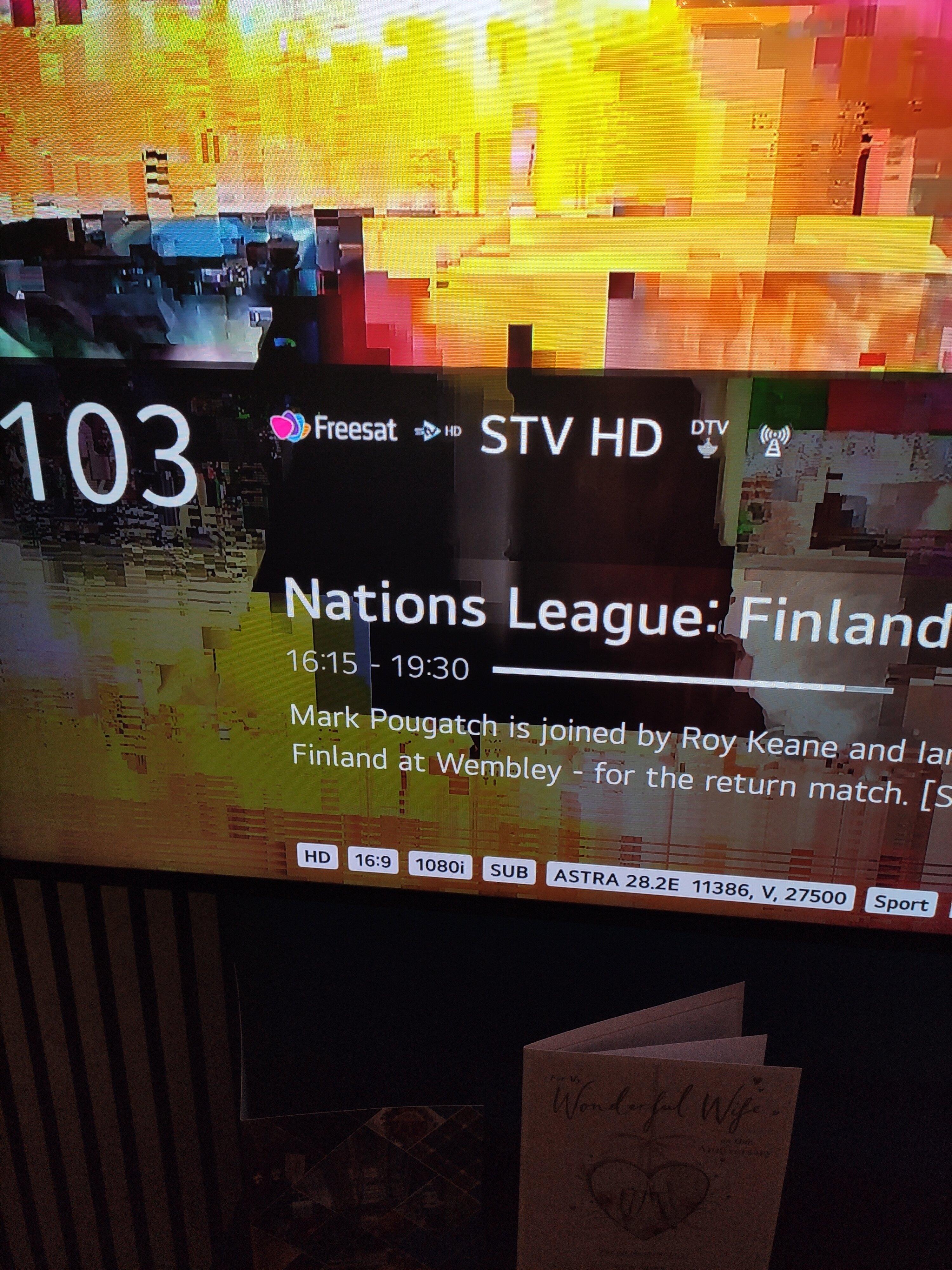

Yes using inbuilt satellite tuner in LG TV which uses Freesat....also have a zgemma box using whooshbuild connected to another TV connected to same satellite dish .....same problem on both with ITV/STV channels....I understand frequencies have changed but as been advised above thought Freesat tuner would update with new info automatically....

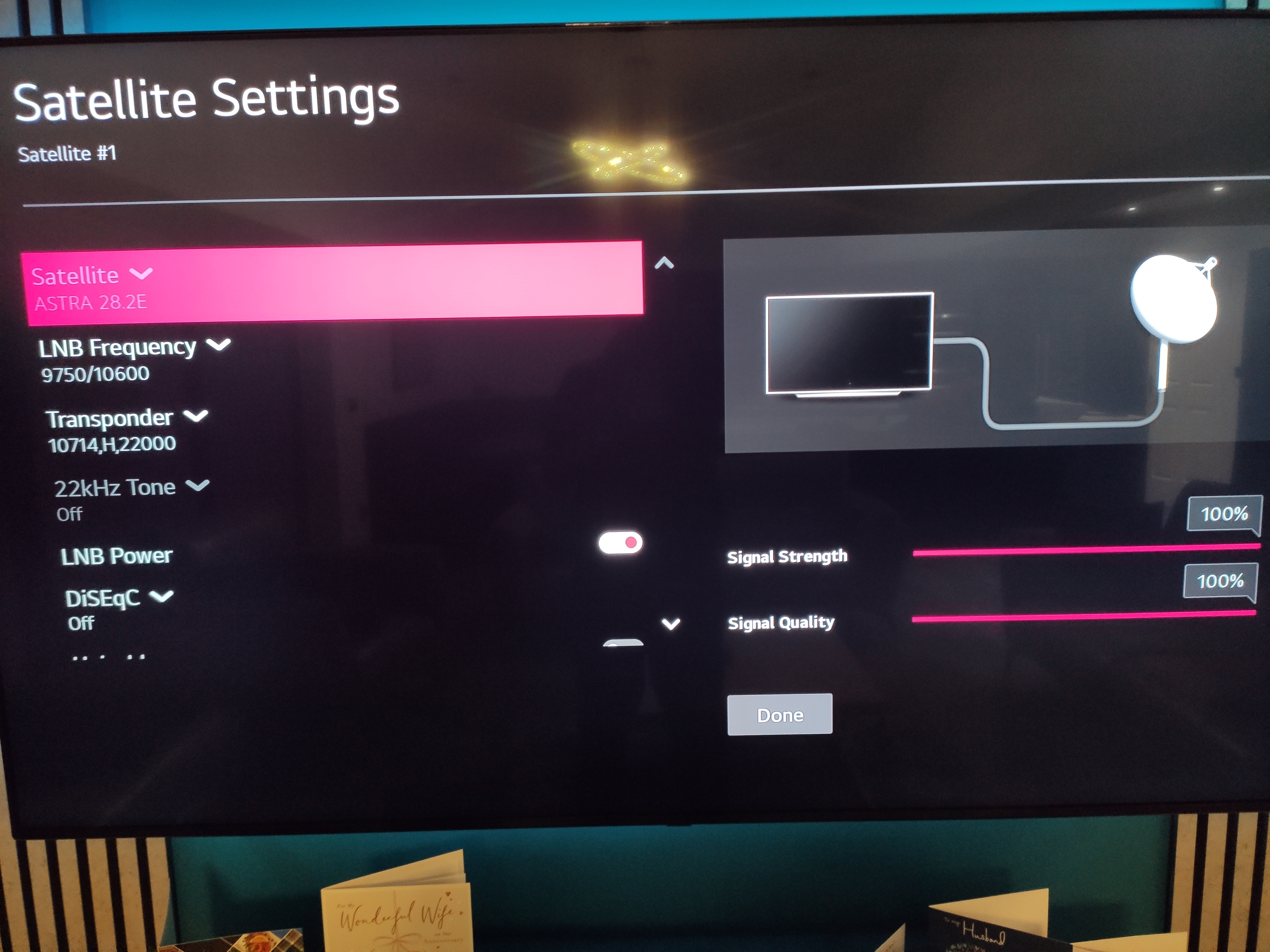

Current settings on my LG TV for satellite, do they look ok?
Would a slight move in dish position only affect ITV/STV channels, would it not affect all channels?
yes but go down to transponder and toggle it to change to new itv2 frequency, it may already be available then see if you get signal, or enter details manually and its dvb-s2
