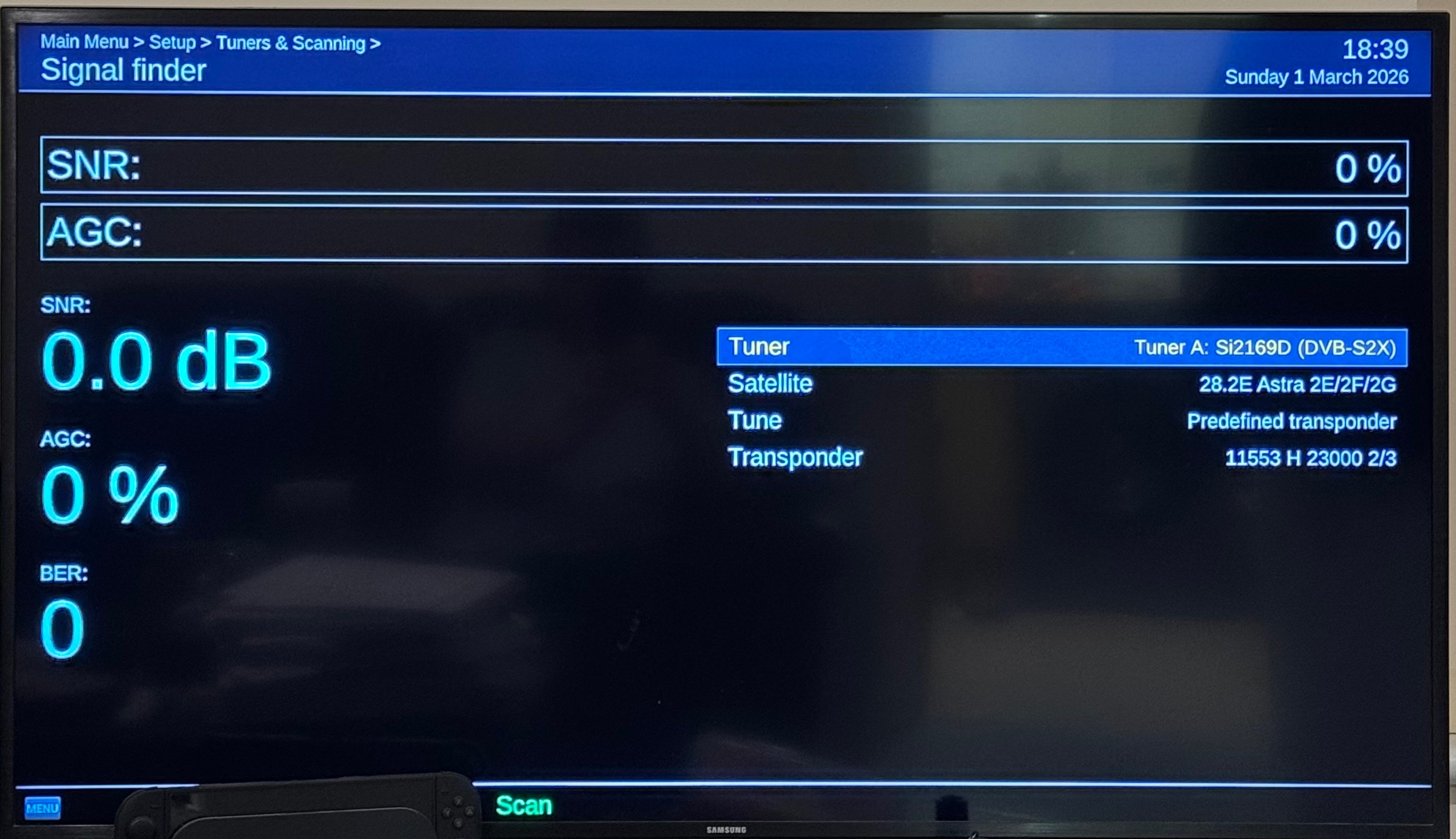

5USA stopped and froze when i was using my zero in kitchen in client mode for some unknown reason ??
Checked my H7S and also not working and no signal with signal finder 0%
Et10000 upstairs still working but unsure on what sat dish feed was coming from as have fixed with an octo lnb and motorised on another dish.
updated files and reran ABM no difference and rebooted the H7S and channel returned .
Scratching my head if lnb was going wonky just using 1 channel which i doubt.
I know over years other feeds have been lost possibly by connections on lnb or rodent chewing on cables ??
