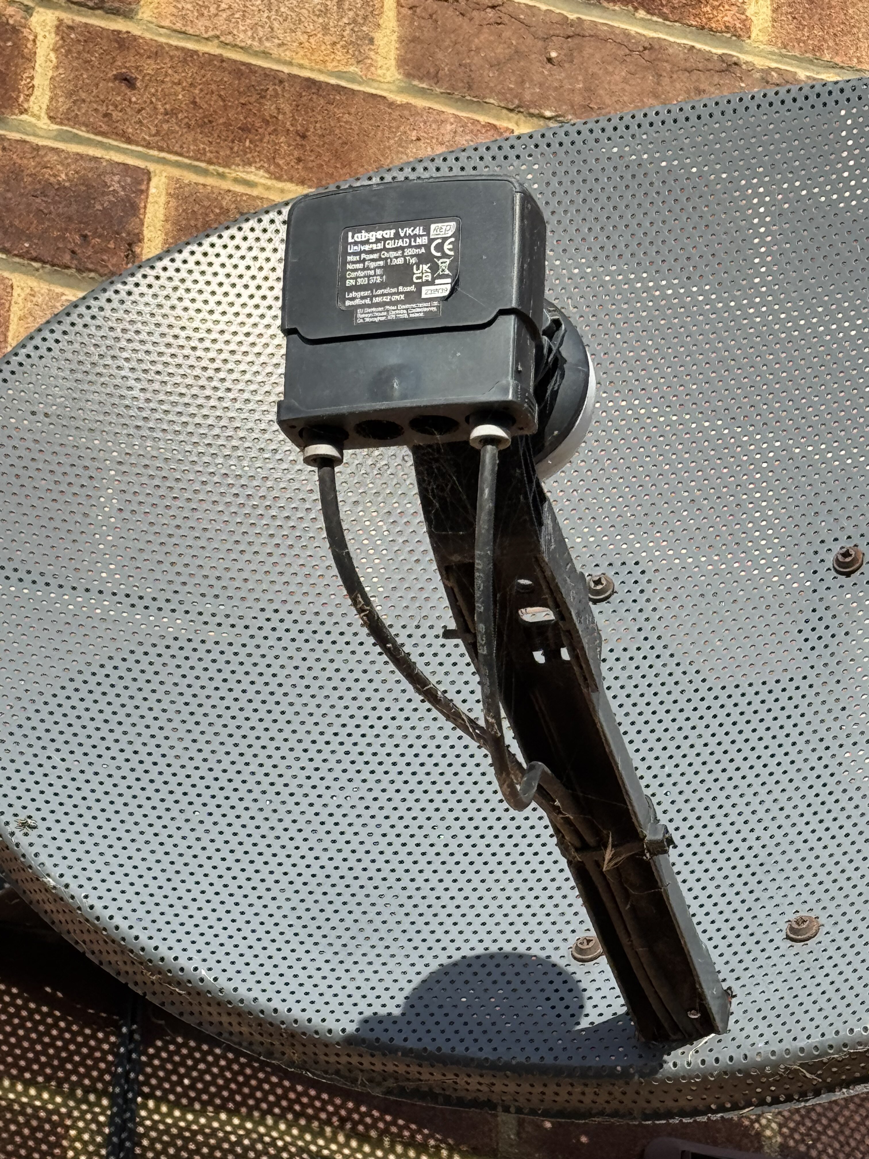

What type LNB Are you working with as as far as i can see reading this topic you fail to mention or provide a pic of your current LNB ??
i am not entirely convinced it is indeed a Universal LNB whatsoever which may explain why no signal lately and you have yet to provide any proof or evidence to suggest otherwise your "Pro" installer may still get signal if it's a Sky Q LNB on his sat meter but you will never get a signal unless you are using a SKY Q Box if indeed it is a SKY Q LNB which would be logical and meaning there is nothing at all wrong with any of your boxes whatsoever 🙈

I had an engineer out today and checked the lnb which is a universal wide band and getting the signal on his scanner/device but when connected to the zgemma box there is no signal. I've been using the box for 6 years moved to a new home and working there for 2 years up until now. apologies my questions and input aren't enough thank you for your advise and help.

If its a quad lnb try swapping the ports over

Universal wide band.
Ahhh so at the dish end how many fconnectors are they ?
Universal wide band LNB's have ports for SkyQ and Universal Ports. Is you Zgemma connected to the correct ports ? The gold fconnectors are sky q the rest are the universal f connectors. Your boxes need to be connected to a silver f connector.

This what I got from screw fix 2 years ago. Today the engineer put those to cable in the middle.
he connected the device on both cables then connected the cables inside which gave a good signal tone.
