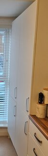

hi, just wondering if anyone could tell me if i could possibly add a tower oven in these units? just take the door off and use fillers etc, or would it be a whole new oven unit requirement? thanks in advance

Firstly,check the width of the unit you plan to install the oven in.They need to be 600mm wide units with approx 560mm inside measurements
for a standard oven to fit.
The oven would need its own power supply ie the 6mm core cable those that come with a plug on them is just for the light ect.
