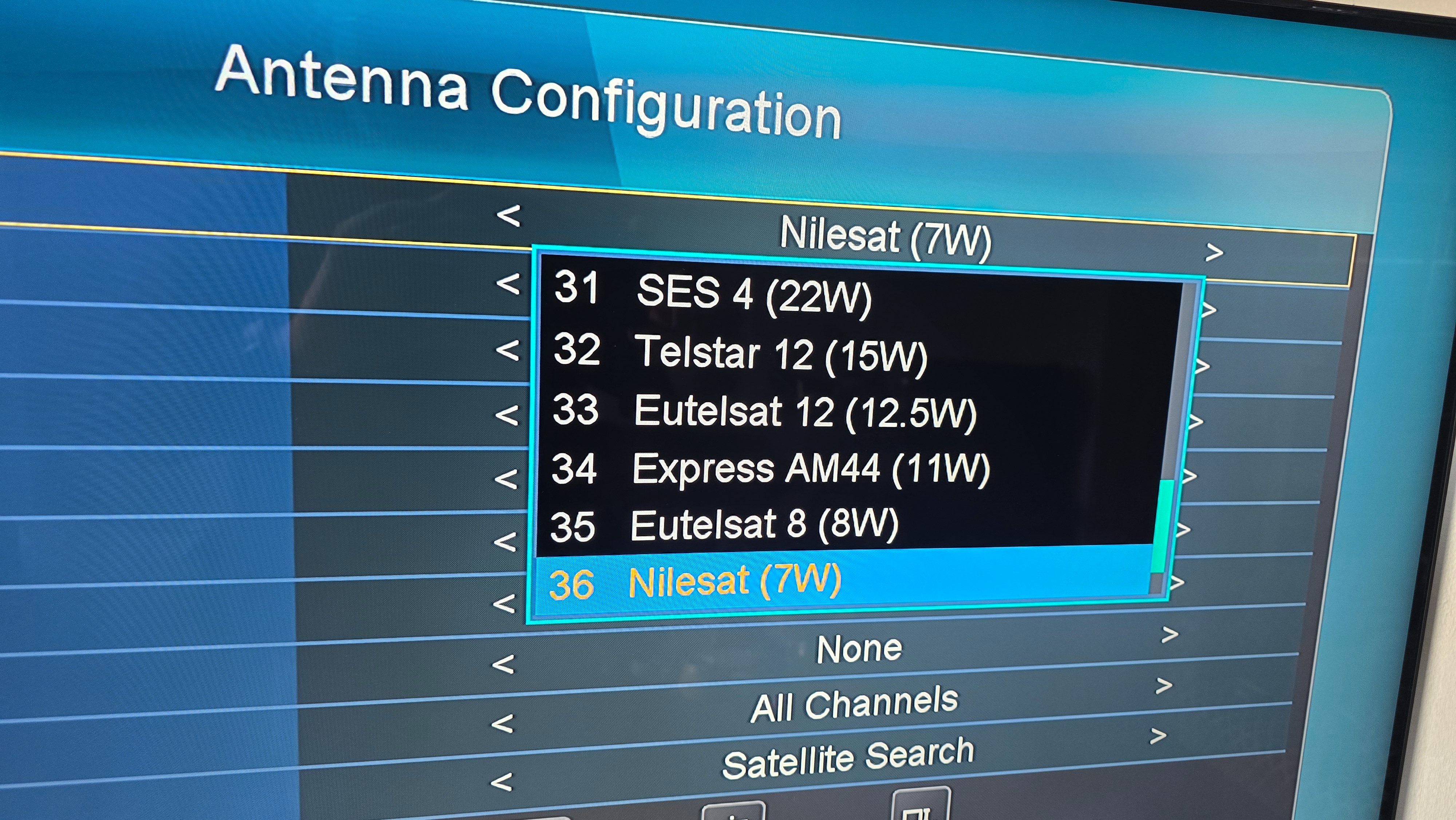

How do I move the dish to 8w though as it’s not on the menu they only 8w I have is the Thor 8w
That I can't tell you, as I don't use the viark to control my 1.2m dish.How do I move the dish to 8w though as it’s not on the menu they only 8w I have is the Thor 8w
On my list it’s missing 5W is there but not 8It is there mate, you may need to enable it
Add it thenOn my list it’s missing 5W is there but not 8
I added it now but they don’t go green ? Do I need to add the bein transponder for 8w in 7W ?Add it then

I’ve added 8W to my satellite list and I have the other bein channels on 8w but they don’t go green like they do on 7WAdd it then
Same difference.Thought he had v8
Because as I said above, you have to trick the box into scanning them as if they are 7w and not 8w.I’ve added 8W to my satellite list and I have the other bein channels on 8w but they don’t go green like they do on 7W

I added the transponder of bein 8w to the nilesat7w but I get 0% quality signal. Only when I’m on the 8w in satellite menu I get good signal but they not going green. How do I achieve this trick ?Because as I said above, you have to trick the box into scanning them as if they are 7w and not 8w.
Yeah you need to nudge the dish manually under Diseqc1.2 to 8w while your menu is at 7wI added the transponder of bein 8w to the nilesat7w but I get 0% quality signal. Only when I’m on the 8w in satellite menu I get good signal but they not going green. How do I achieve this trick ?
So in order to watch the 8w channels I have to nudge the dish every time to get the signal.Yeah you need to nudge the dish manually under Diseqc1.2 to 8w while your menu is at 7w

No you store it at the position that works.So in order to watch the 8w channels I have to nudge the dish every time to get the signal.
Thanks all sorted now by adjusting on Diseqc1.2No you store it at the position that works.
