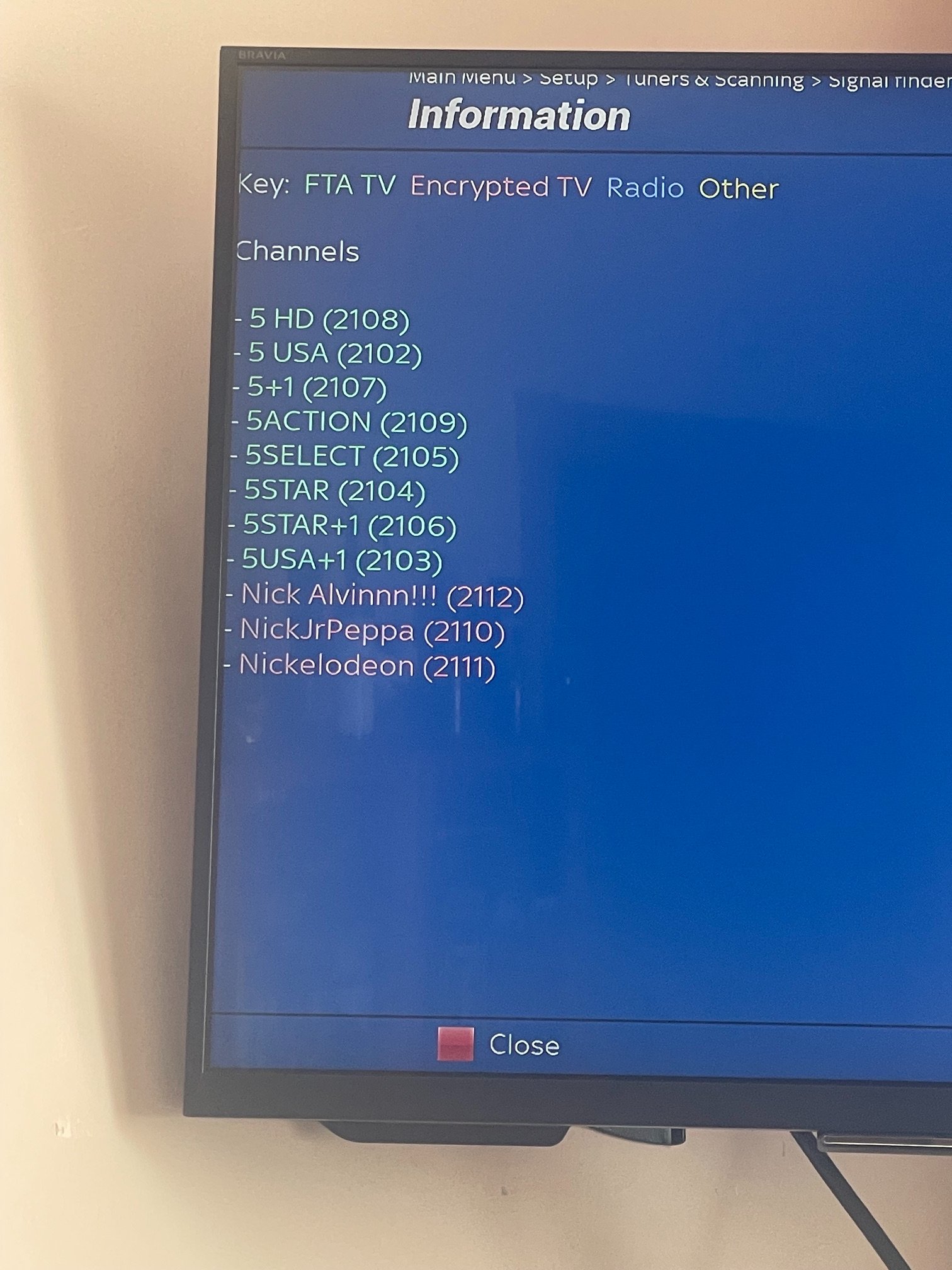

CH5 have changed parameters, so just scan it and if you have abm set correctly it will replace existing, in signal finder put in 11307H, 27500, 8PSK DVB-S2 and that's what's changed dvb-s to DVB-S2, green to scan. This is what you get. job done

I have now scanned both Gigablue (both satellites) and now receive channel 5. I did check XML and may of used that although not knowing what it was used for. My other problem may have been the numbers on gigablues. I have changed 1 - 8 with sitting room and bedroom 9 - 16.
Thanks Abu and bmitie
Hope we can have Manhattan now receiving channel 5?
