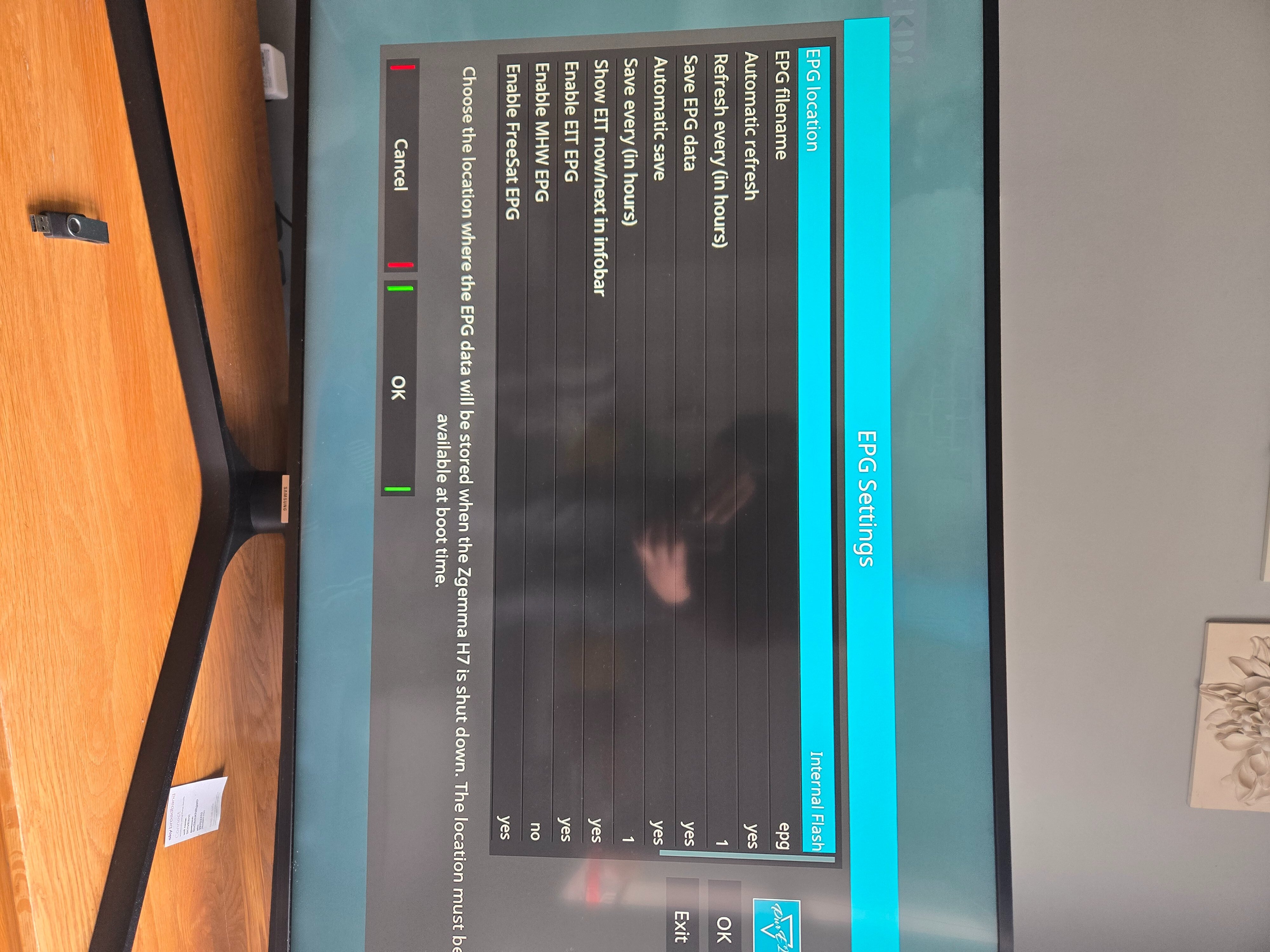

Abu image not changed since 2023 so nothing on box its version 6.5 and it’s now 7.6 and epg was located in internal flash. Box is old model internal hdd.

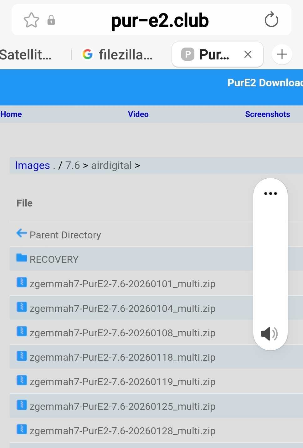

No don’t use recovery version that’s for usb ie a rebuild just use ordinary image 7.6 and go slow.
This one??

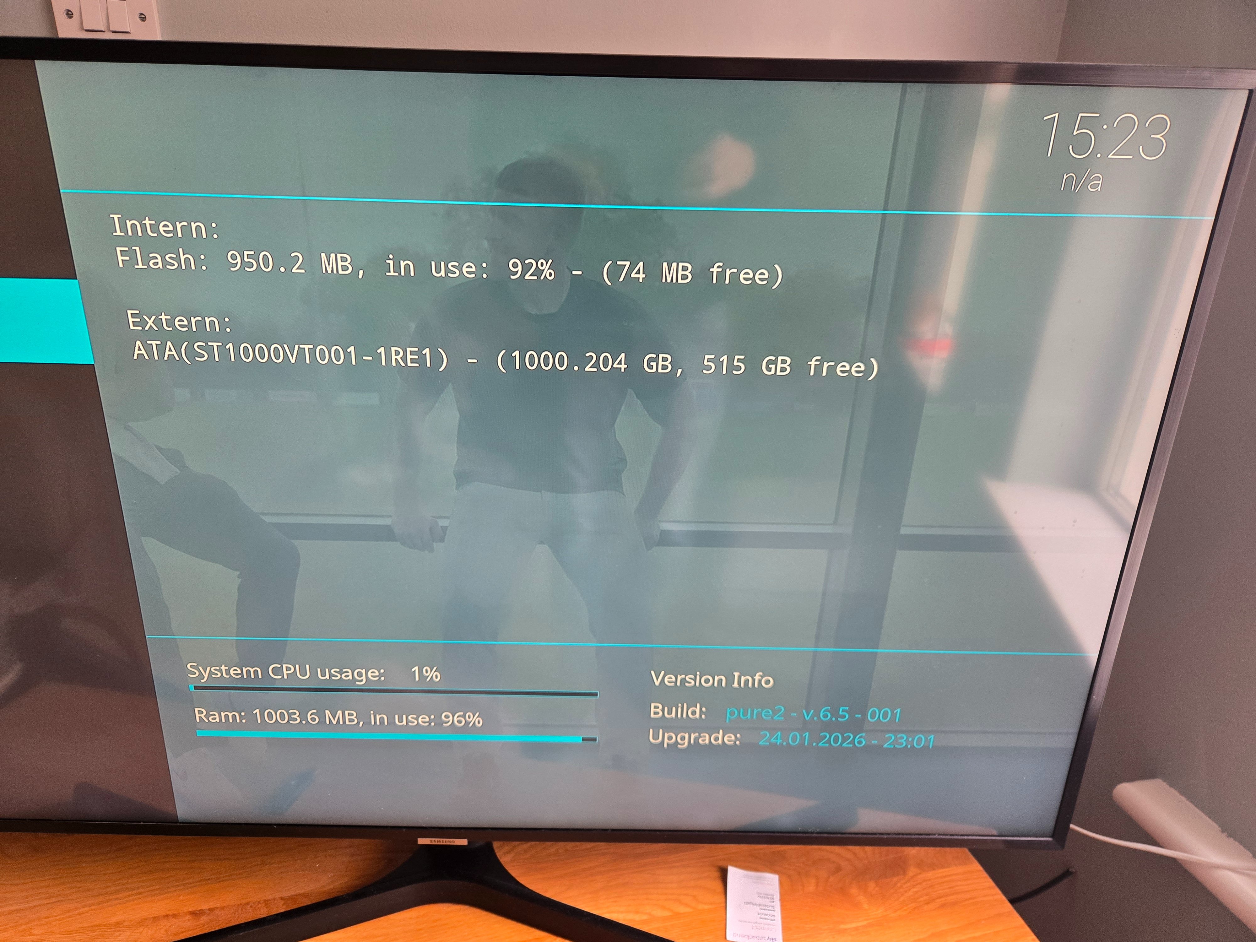

Hi all.
I have a Z-gemma H7S which is starting to take a few seconds to change channels and move between IPTV channels and folders.
I have notice when i try to do an update on the zgemma it tells me no updates are available. It on pure 2 version 6.5 build 001.
It hasn't upgraded since 2023.
Not sure if this is the issue or how to fix it.
Any help would be appreciated.

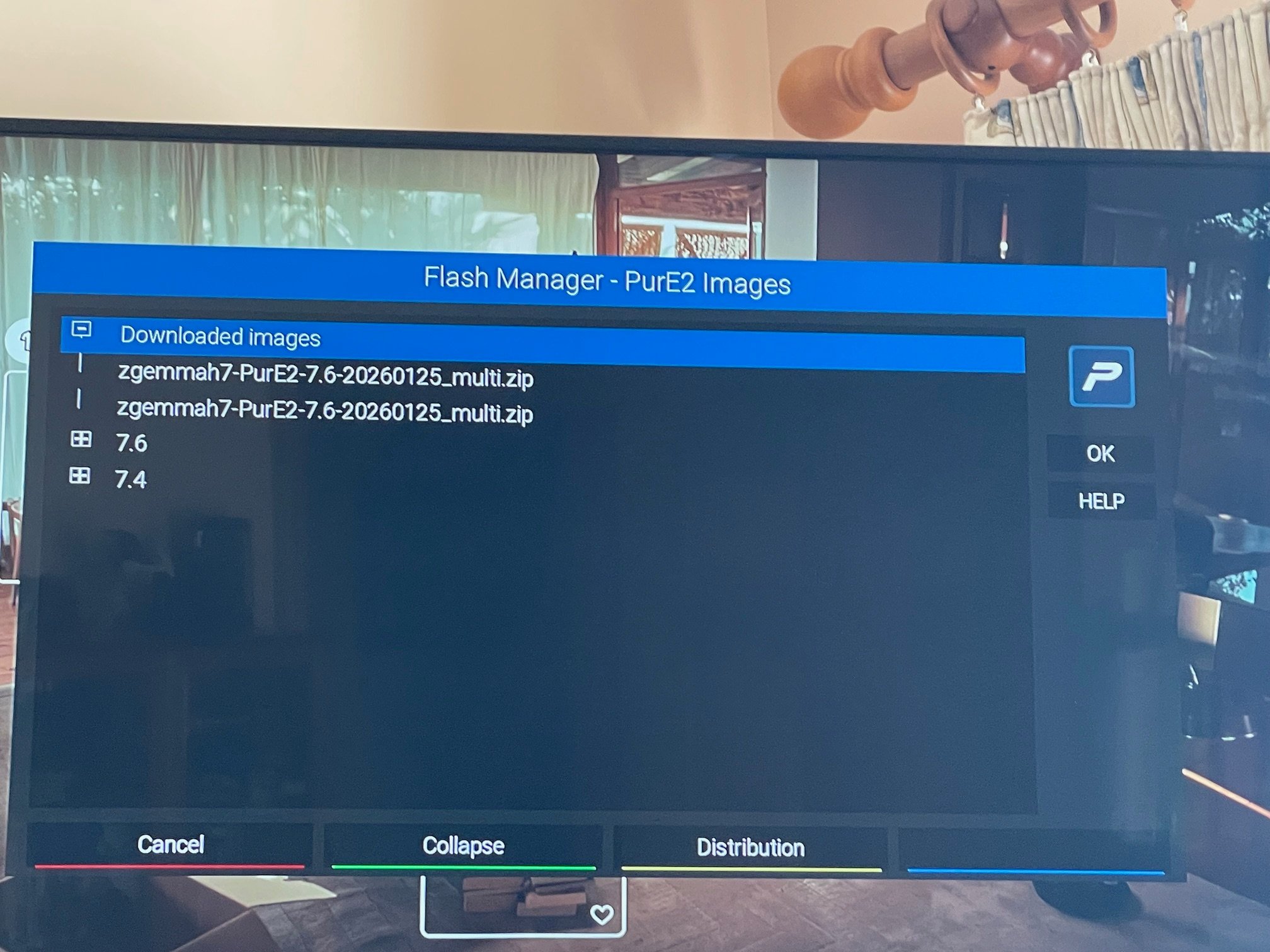

What happened?? I could not stay awake:laughing:. If you got sorted or dropped off like me, !! It was 7.6 you needed. I'm putting 7.6 on h7s now and it may jog my memory!! oK got 7.6 set up and all works as it should. on the fly shows images downloaded and yellow button that says distribution shows 7 other images apart from PURE2 and it has VIX .

just use the latest one ie look at dates use bottom one its 28 jan or 28/01

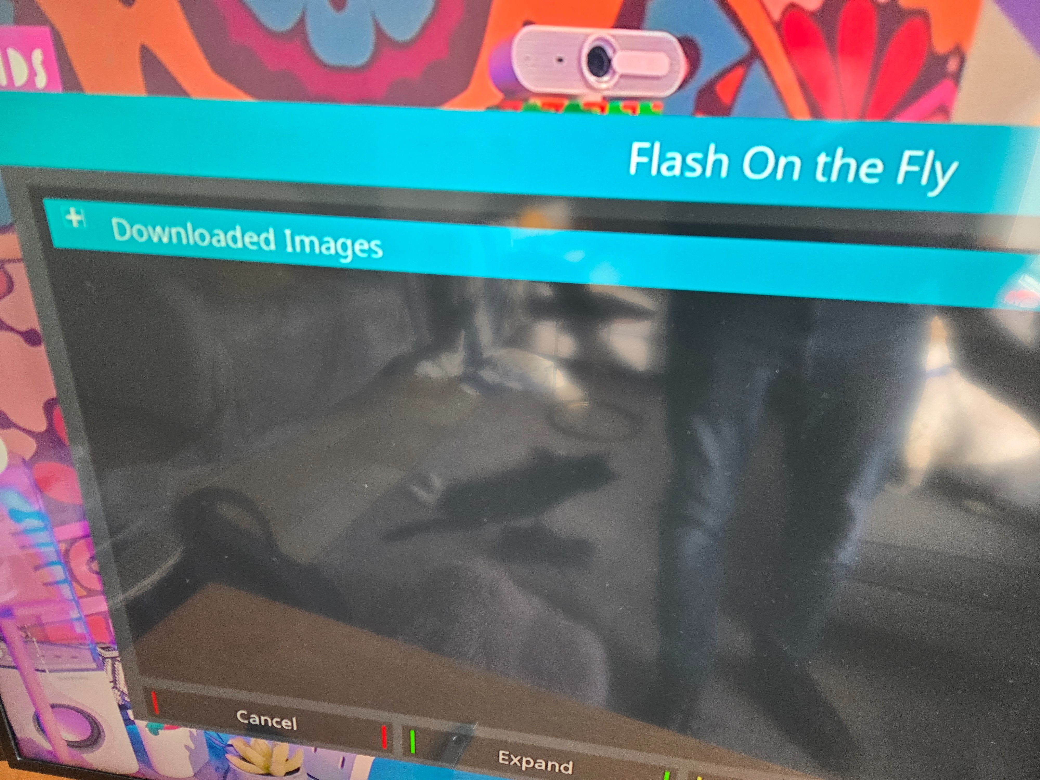

click on that one and your image should appear. this is what i get when i expand the folder downloaded images the reason you see 2 the same is I have it on usb and on hdd. Im waiting to see if you get slots.

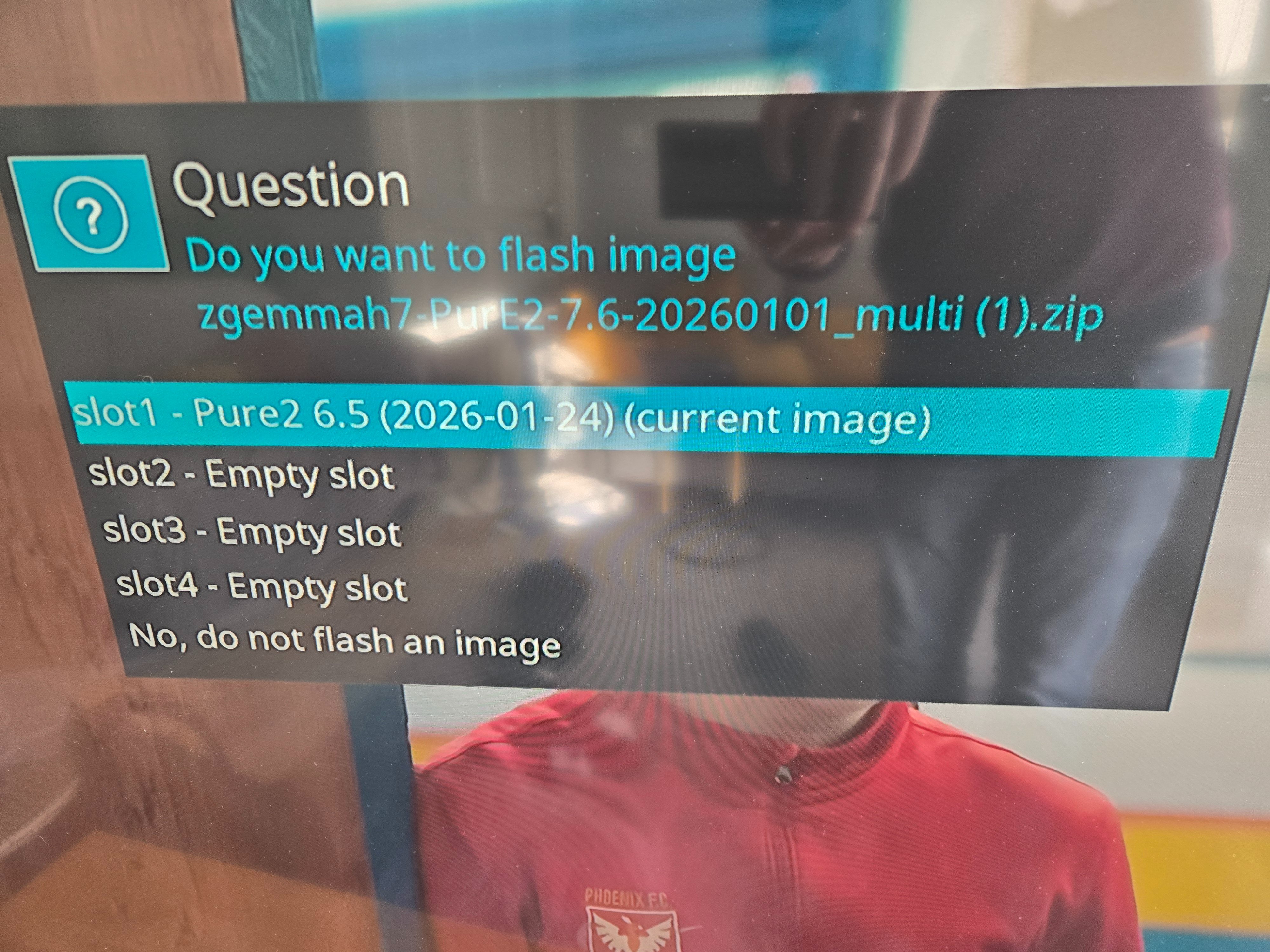

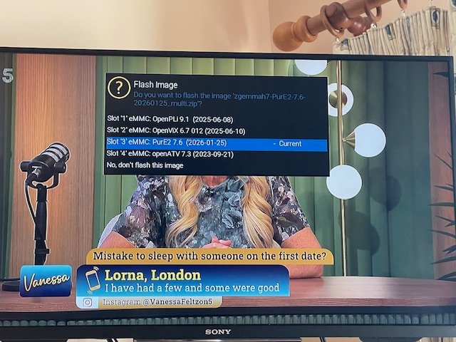

Ah a pic would have been nice so now you have 4 slots showing so yes select slot 1 or one thats empty and flash, green button NB make sure its not current it must be an empty slot, look closely at screen
NO use empty slot look at messages:laughing::laughing::laughing::laughing::laughing:. You are nearly there and its all from scratch, dont restore anything, arrow down to slot 2 then green

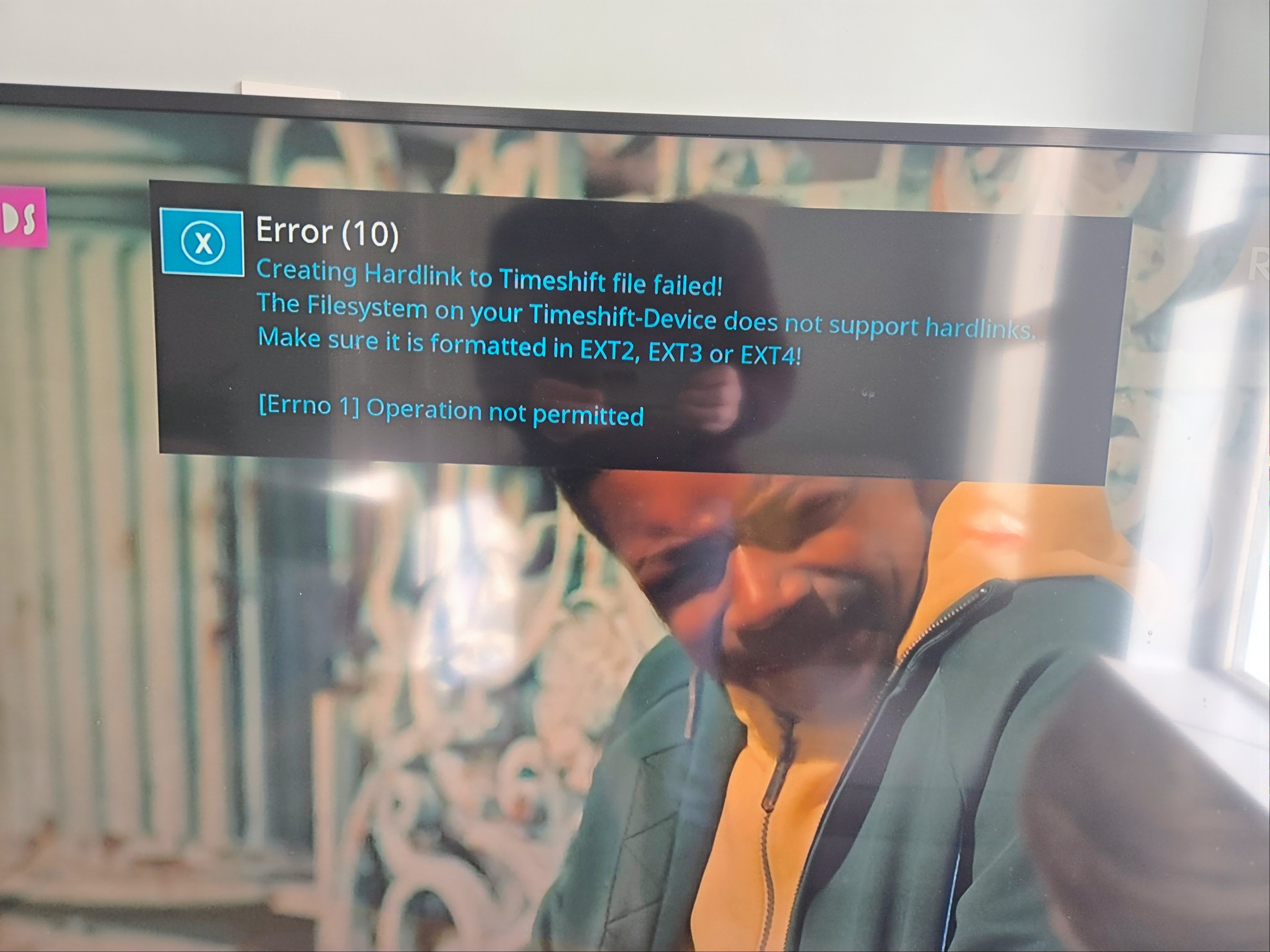

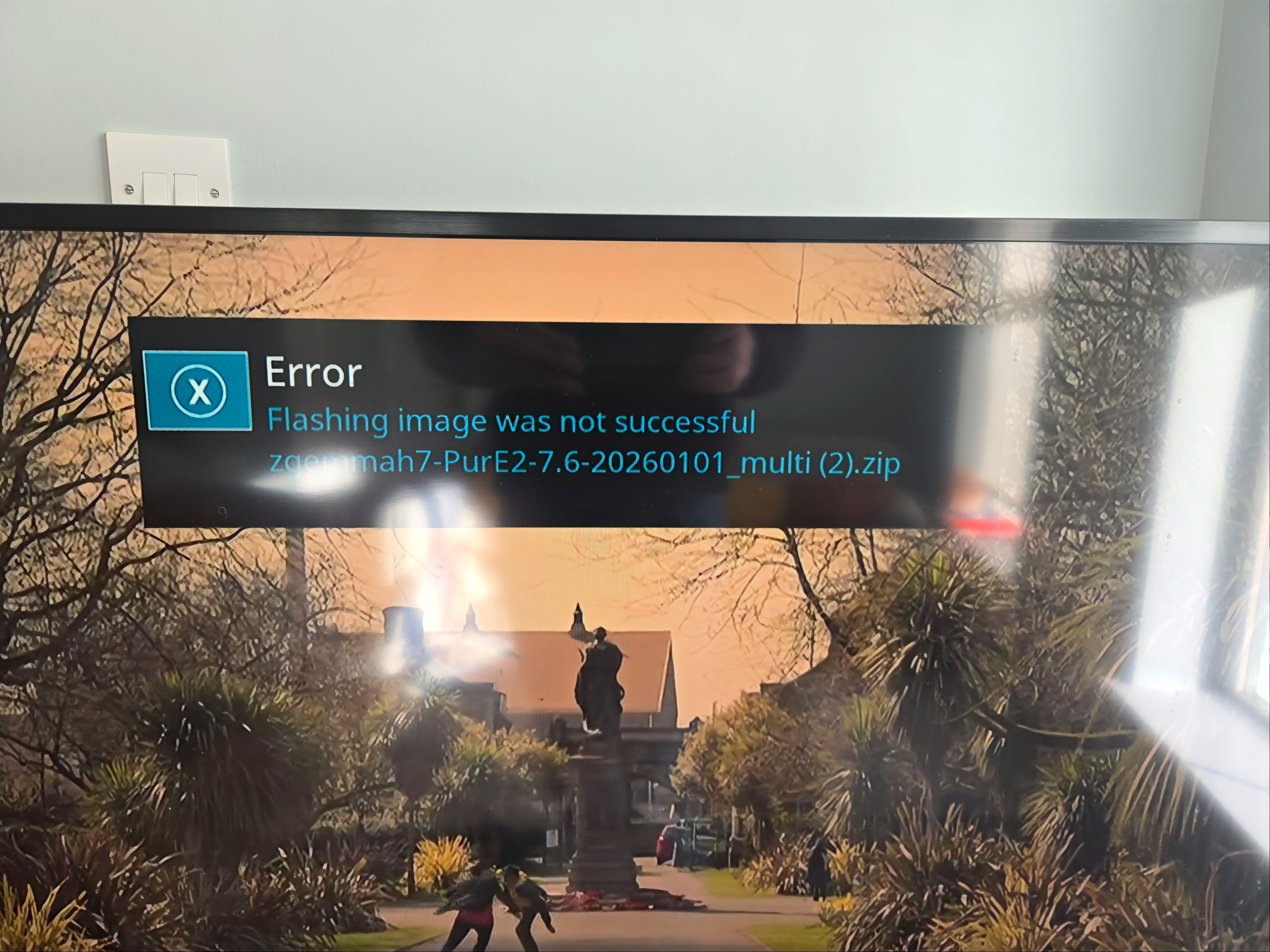

So these two error popping up now.
Irritatingly close

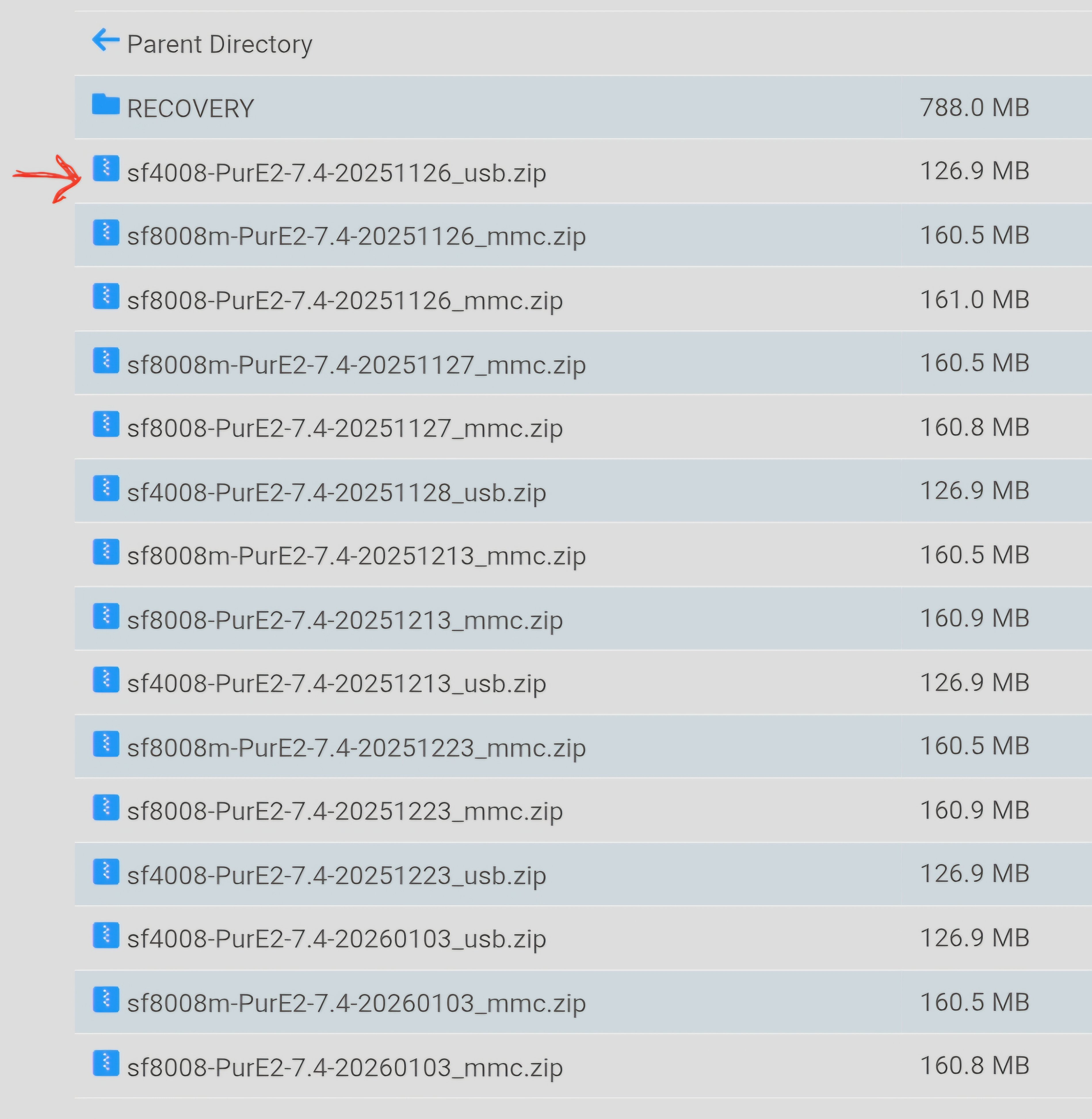

You are having a lot of luck. Try this get the latest pure file the one at the end that says 20260128 and try that. And try a different slot. Have you many recordings saved?

No it came up on previous pics. Have you the HDD internal or is it external via USB? And have you many recordings, you can reformat HDD to ext4 but it deletes everything.

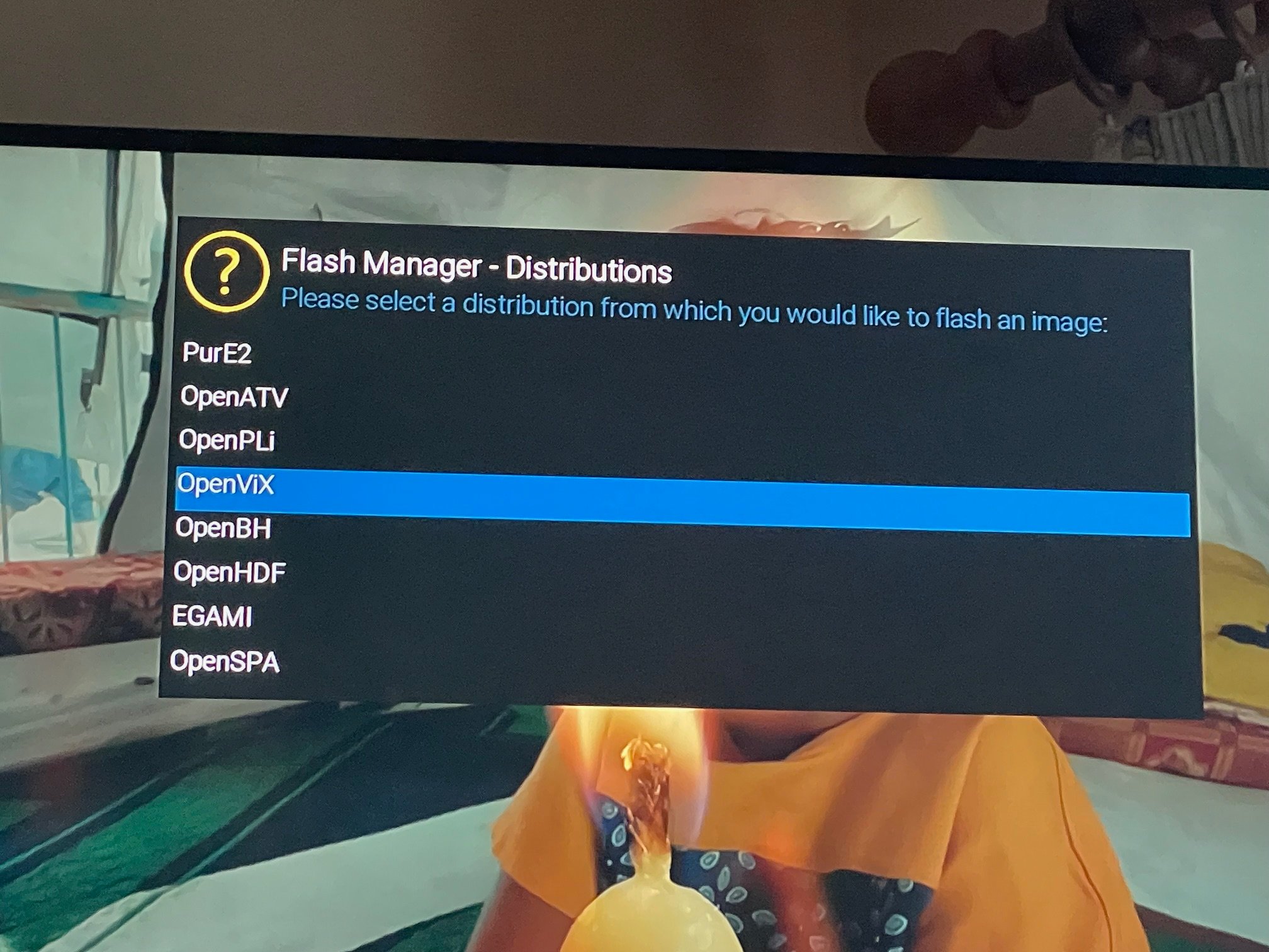

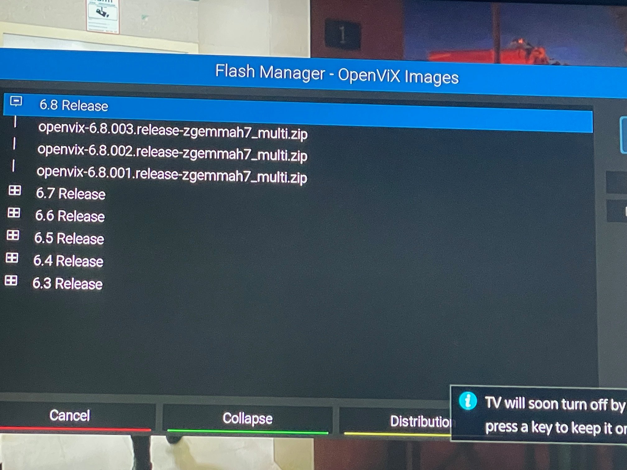

Or try this go back to flash online by menu setup software management flash online and yellow should say distribution so press yellow and you should get this but wait as it downloads, then you are going to select openvix, click on it and flash file at top, green button to empty slot 3..
