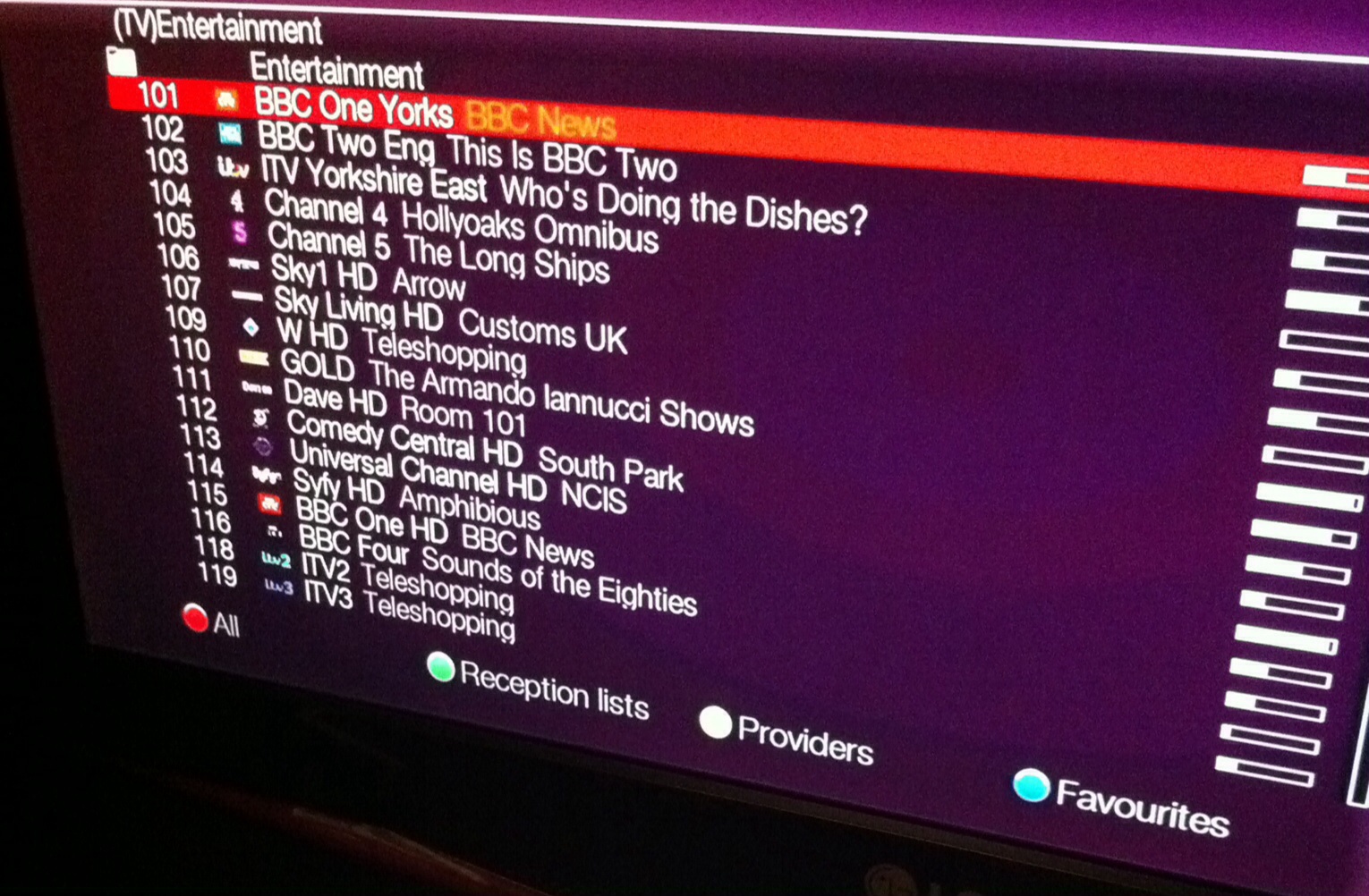

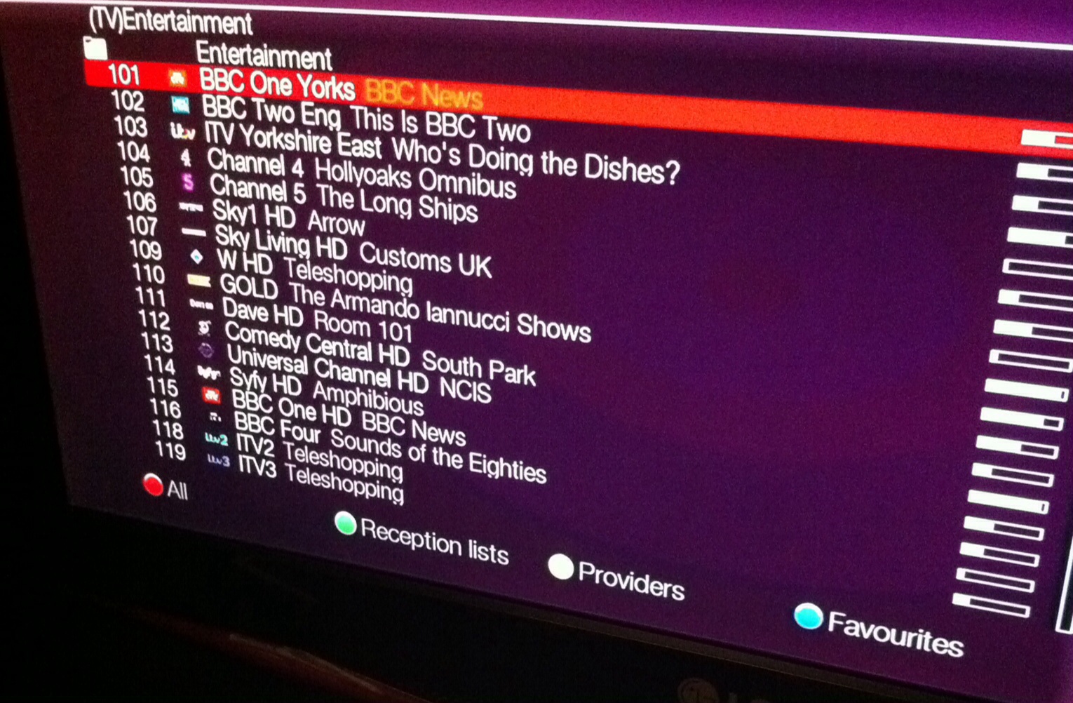

image.jpg O how do you make this screen alittle bigger carnt see picons on the menu what was your osd display settings on your last version 5.3 thx gigsta.

View attachment 22580 O how do you make this screen alittle bigger carnt see picons on the menu what was your osd display settings on your last version 5.3 thx gigsta.
Try pressing menu on that screen then settings under show picons in service list you should see service picons downsize try changing it to 0 green to save.
Also you might want to change show columns to 200 pixels wide
Hi dsayers tryed your explanation to no success on service picon downsize could do with it going other way to +8 other wise a setting that says service picons upsize and the show columns made it worse was loosing programme description the more I increased the setting was worse thx.
