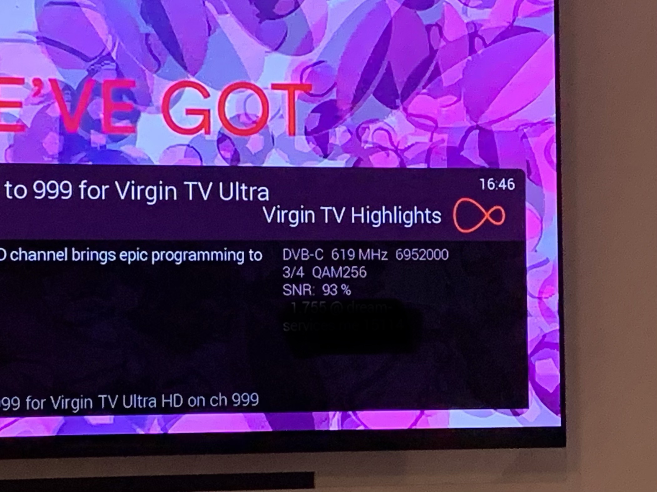

Failed to tune ABM

Ok download the attached zip file unzip it and drag the cable_uk_virgin.xml to desktop.
FTP the cable_uk_virgin.xml to usr\lib\enigma2\python\Plugins\SystemPlugins\AutoBouquetsMaker\providers delryr the providers.cache file and rescan ABM.
If it works ill submit a pull request for it to be updated via Update config/provider files
worked a treat, thanks for that mate, much appreciated

Net ID 40984
I changed modulation from 3 to 5.
Autobookmaker now scans and missing local HD channels are back.
