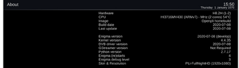

I have openly homebuilt image from 2020-07-08.

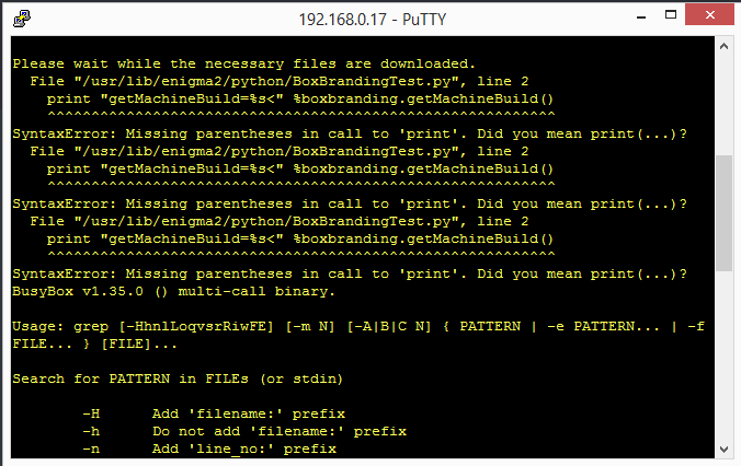

Hi again,
is the command line still working for flashing Grogbuild? I saw this while executing.
wget: server returned error: HTTP/1.1 400 Bad Request
cp: can't stat '/media/hdd/grogbuild/grogbuild-files/BoxBrandingTest.py': No such file or directory
python: can't open file '/usr/lib/enigma2/python/BoxBrandingTest.py': [Errno 2] No such file or directory

Looks like there is an issue with the server. http://flashmybox4.me just loads a blank page.
It's not happy about something anyway:
View attachment 83631the
What is on the box? if a py3 system then the script will not work as the BoxBranding module is written in py2.7, I'm sure I've already said it wont work if you have py3.x on the box.
flashmybox4.me will be blank, there is nothing there apart from the files for e2 boxes, and I don't want them downloadable via browser so they can only be accessed via command line.

Aaahhh ..... I vaguely remember it needing boxbranding now you mention it and the blank page makes sense now. I think it used to have the script on it.

if you have atv 6.4 on the box then it works, boxbanding has detected the box fine as can be seen in the image url.

I've been trying to get this to work for a couple of months now, don't know if you've seen te rest of this thread. Posted this in #29.

to be fair the following is going to be the issue
Code:
If the files aren't being downloaded then BoxBranding wont be found. Looking at the screenshot, your date is not set, are you sure the box is connecting to the internet as normally the time/date is automatically fetched from interent to ensure time is right
01/01/1970 is Unix epoch, if this is the case, the box has never been connected to the internet since it was flashed
