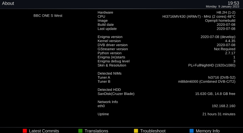

I didn't flash it - bought second hand and this was the image I guess that was flashed to it.
On the setup menu there is a flash image option - when I try to use this - cannot find images please try later. I've unzipped the open atv file and it creates a folder on the usb stick with a name of h8 and files within that folder.
Screenshot
Power off the box at the socket.
Make sure the usb is in the box and power it on while keeping a finger on the standby button and it will flash openatv

Just like to say thanks for everyone's help - finally got it to flash through usb. Previously tried two usb sticks without success (which previously worked on the zgemma h2s), the one that worked was an old Sandisk cruzer micro 2gb. Now got open atv working on the zgemma h82h. Regards all
