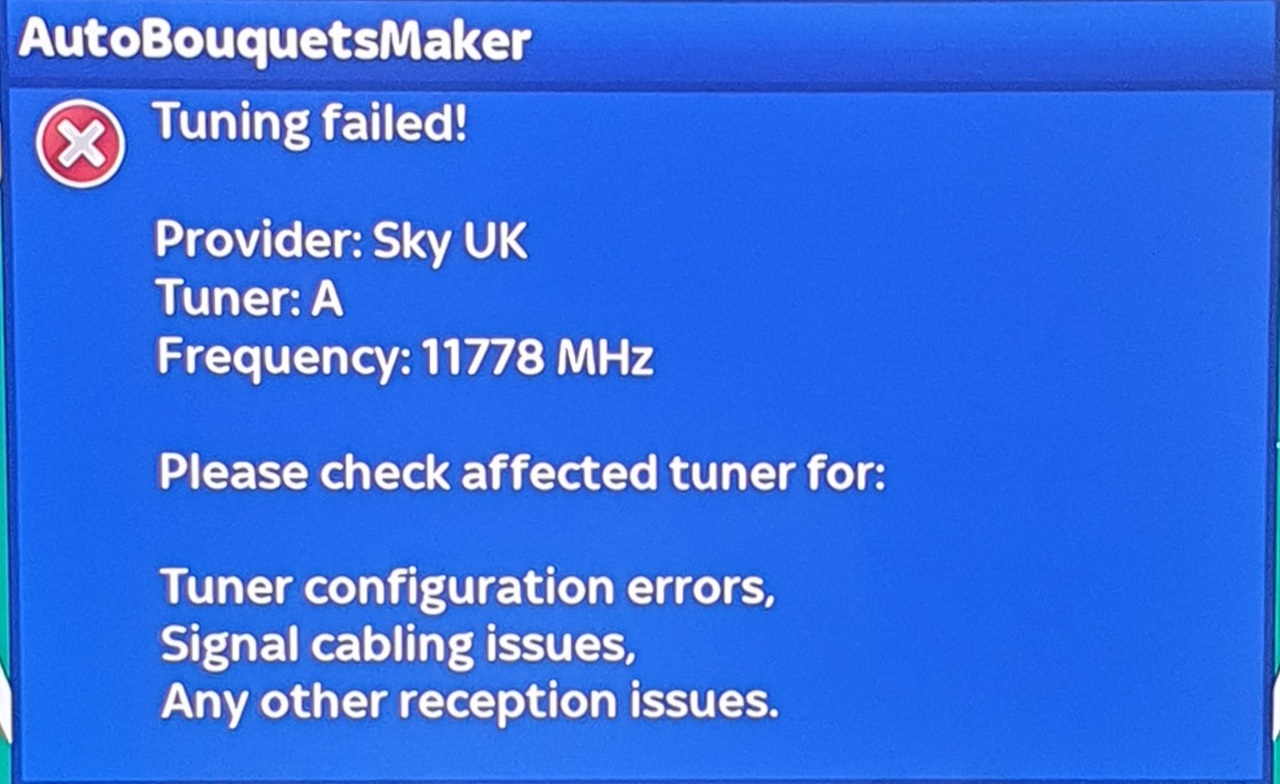

I also noticed after loading wooshbuild infinity an error came up stating "Tuning failed" Turner A frequency 11778 MHZ" (Please check affected tuner for : Configuration errors, signal cable issues, any other reception issues.)
Could have lost both my tuner settings when doing the upgrades? If so can anyone please tell me how I go about setting this back up on the box so I can at least get my FTA channels back up and running. If tuner setting this is NOT the issue then all suggestion are well and happy to give it ago... Thank you in advance.

Hi Urie, thank you very much for you help again. The turners seem to be setup correctly. When I go to setup the Auto bouquets maker it shows zero channels found for sly service then shows an error code for tuner A pops up. This is where I am getting stuck. I also can't get any of the vermin channels to work either? I'm a totally lost here and unsure what to do in order to resolve the issue...?
Virmin is gone ages ago. you would be better posting screenshots then members would get better idea of whats is wrong. also have you tried signal finder in reception section.

I have tried signal finder and its showing zero singal strength. I have also included a screen shot of the error codes I get after doing a ABM search.
The box was working fine before I did the reflashed to atv 6.4. I am currently getting the error code below when running ABM...? I've checked F connector and its working on my other box fine.

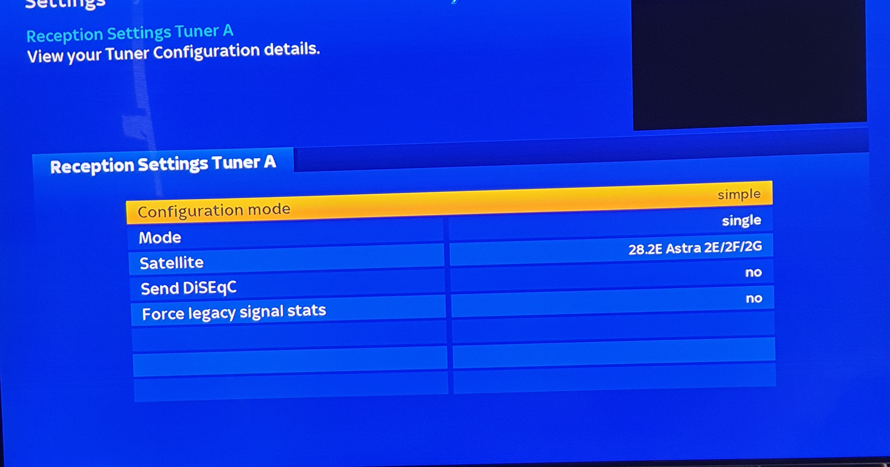

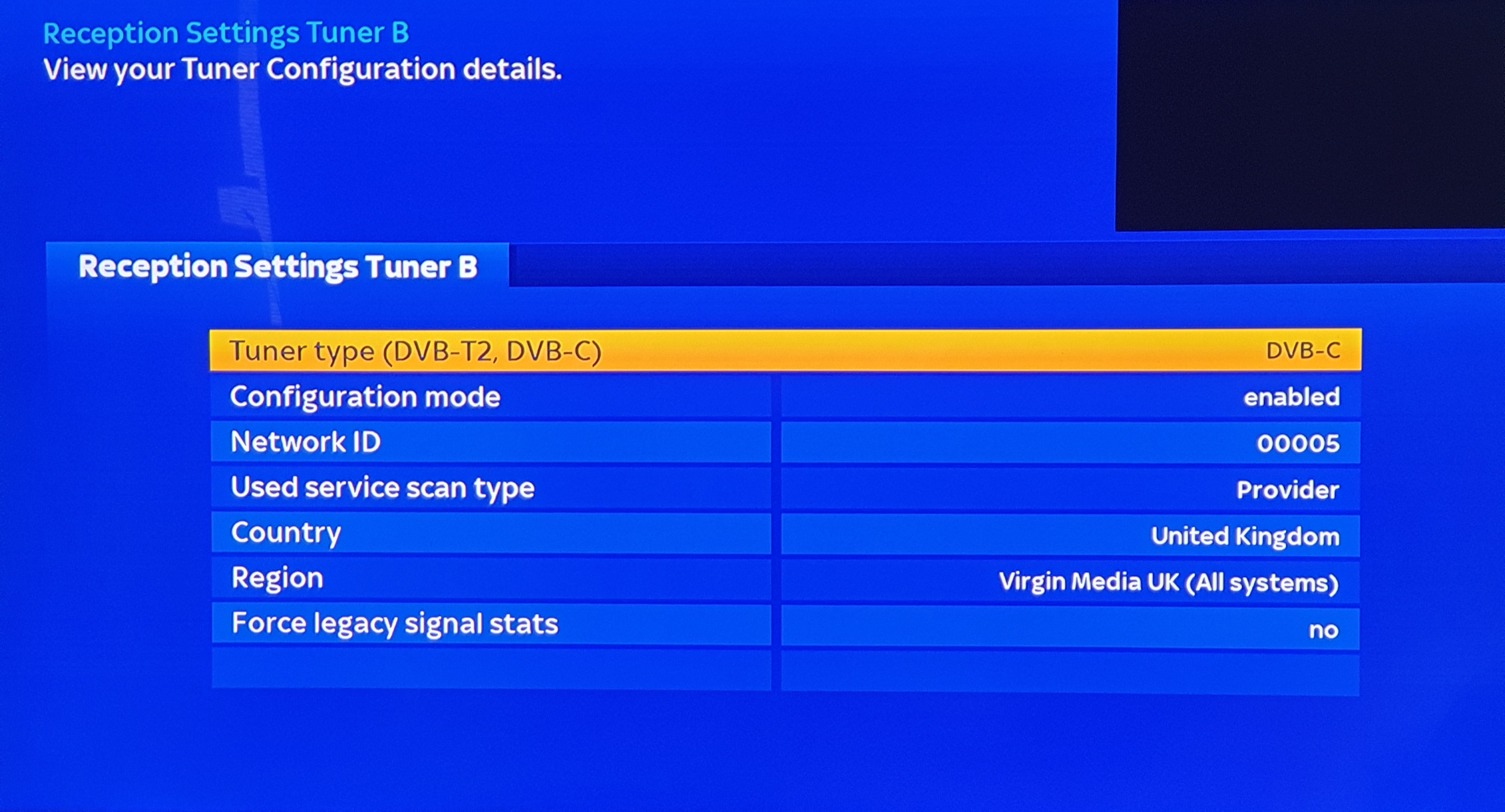

Ok double check the f connector for sat incase it's became loose when flashing. Can you post a picture of your tuner configuration
Please see screen shot of tuner settings.

Vermin is showing a good signal strength but no channels coming though not even the FTA ones? Sly has zero signal strength and zero channels showing when you do manual/auto scan. Totally baffled by this...? Any help would be much appreciated.
