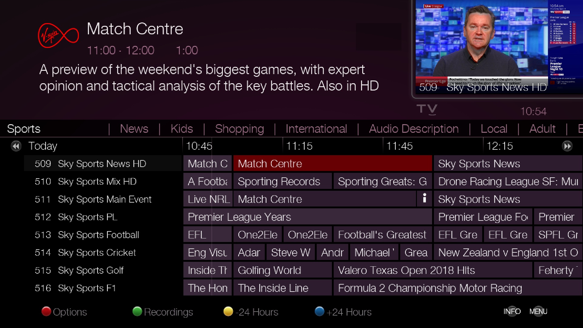

Modern boxes have one touch recording, full 7 day epg, HD channels and you can use different skins (backgrounds) to make them look like Sky or Virgin on the screen, like this:

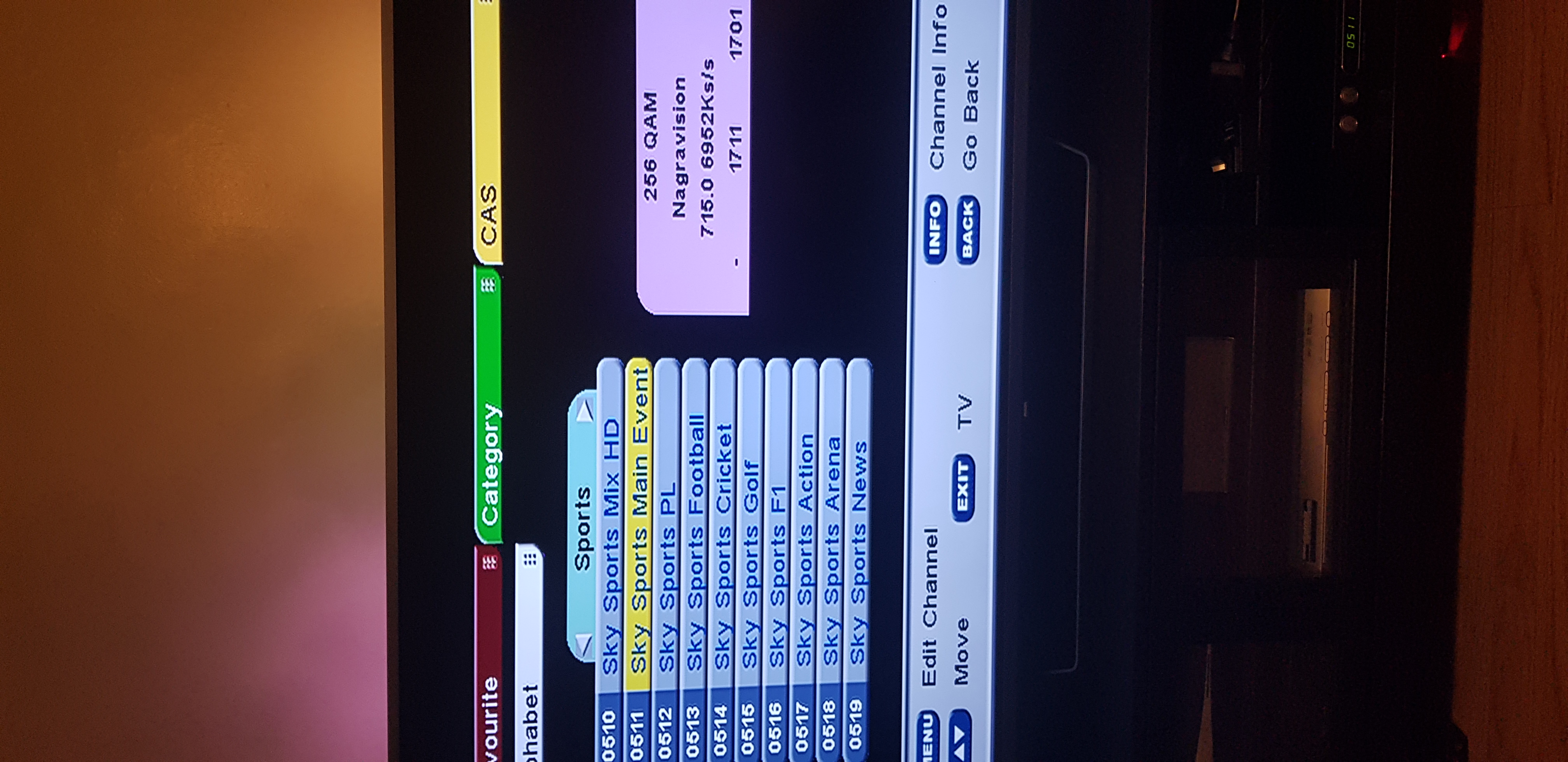

When I'm scanning I'm seeing some channels being scanned into Radio Channels section. Is that what you're getting? I've found all the missing sports, kids channels etc they're all under the Radio section. So all I'm getting is the channel sound with a black screen as its scanning it as a Radio Channel rather than TV channel!:
Snap mate! Exactly same problem. I’m gonna wait and see hopefully in the next few days sorts itself out
