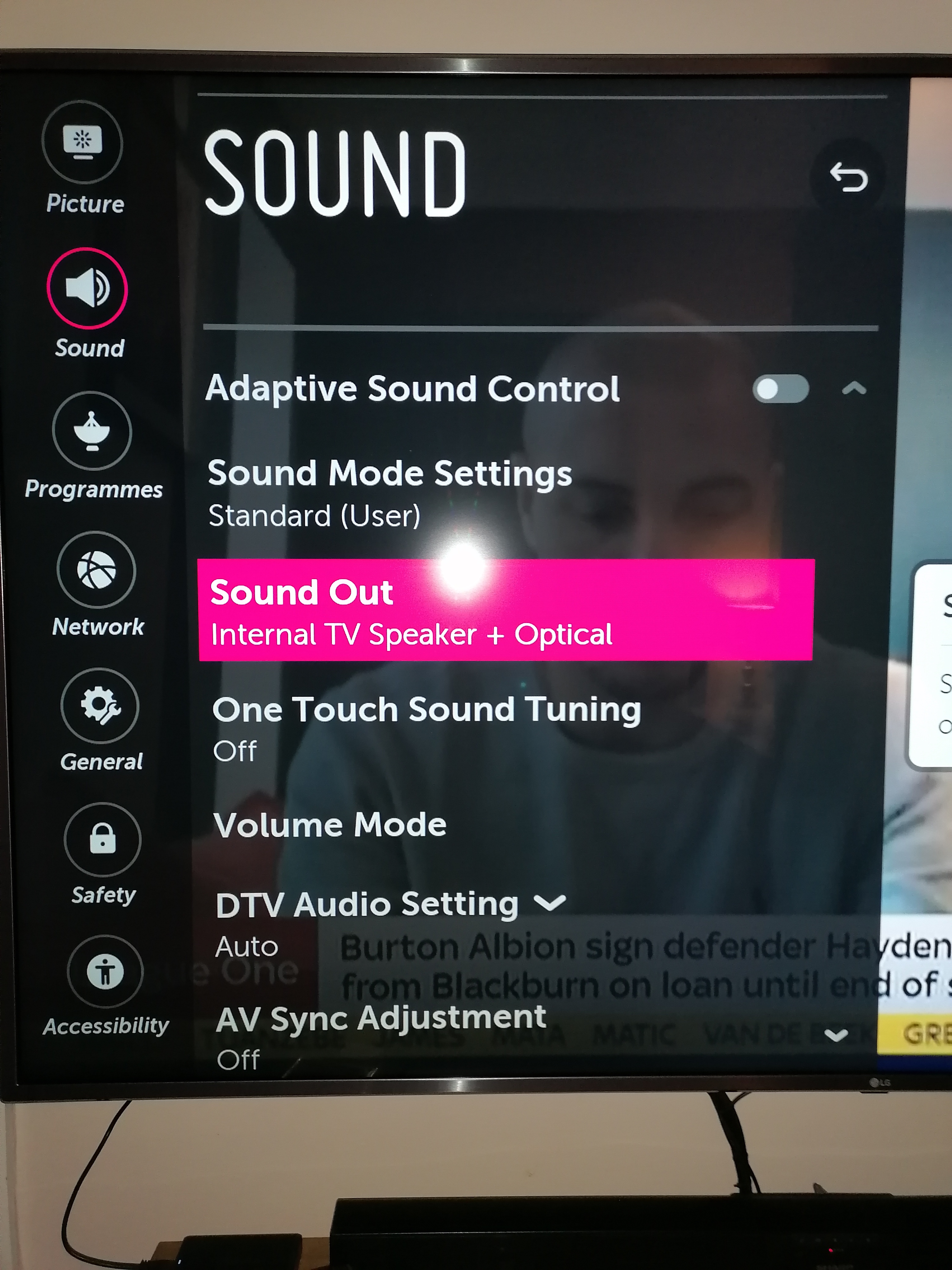

I have an LG 75inch 4k, have soundbar connected with optical cable.
In sound settings got it set to internal and optical.

I can only get tv sound, hdmi/arc or s/pdif. It wont let me choose anything else on the menu. Obviously something is on/off enabled somewhere else, I cant see. But its not letting me choose both tv and soundbar together at moment. Its s/pdif(soundbar) or the tv
