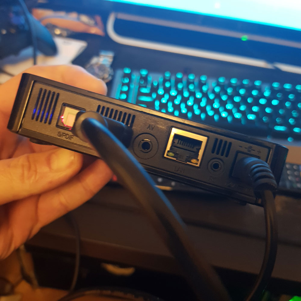

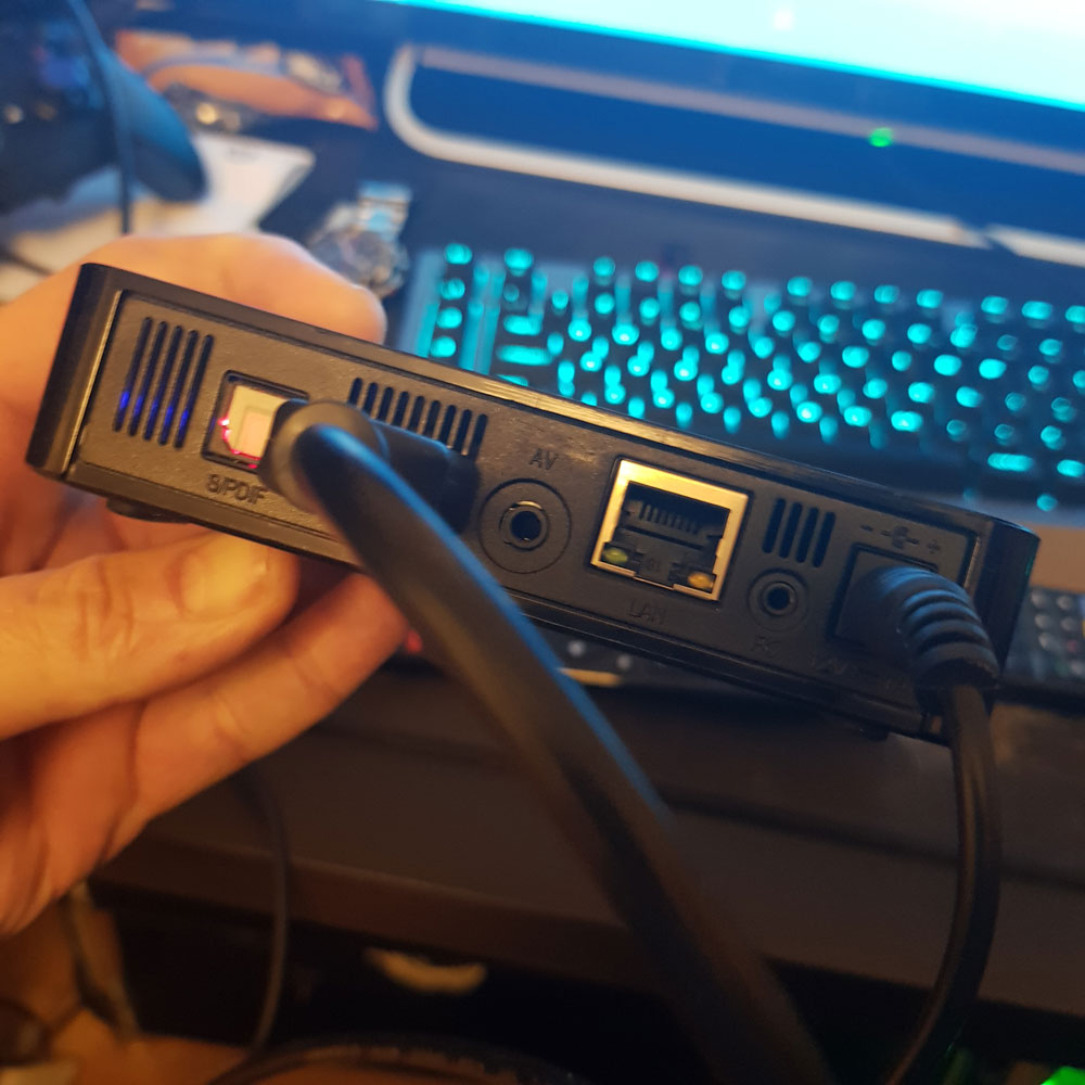

There may be a wifi adapter in the rear usb port. Remove it if there is and try that
I'm good mate I've done mine I'm just saying 254w1 has no rear sub only front.
I did mine on a 16g stick formatted on pc and in front sub port. All worked fine as per your instructions..

I have looked at a few 254s this evening and the basic model has the rear usb port, The 254w1 as you quite correctly report has none.

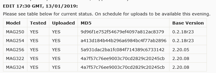

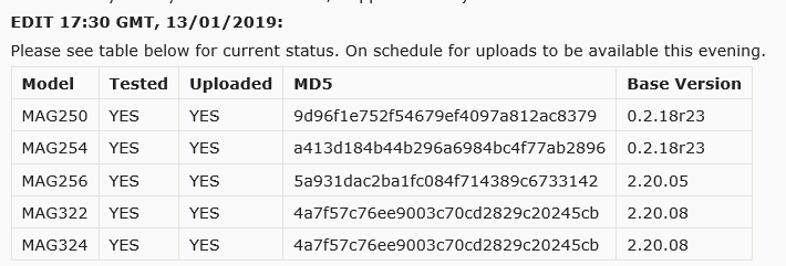

Pending approval, I'll link to the firmwares I released yesterday that don't lock you in to anything, but do remove the block completely.
EDIT: As now run by the mods, the files for the boxes in the table below are all in a zip located here: https://anonfile.com/w39c38qdba/NoBlock_zip
EVERYONE has my full permission to redistribute these as you see fit. If anyone has any questions, problems or suggestions than let me know and I'll respond as fast as I can!
Versions and MD5 checksums for what I have are below - all built from the latest official Infomir firmware
