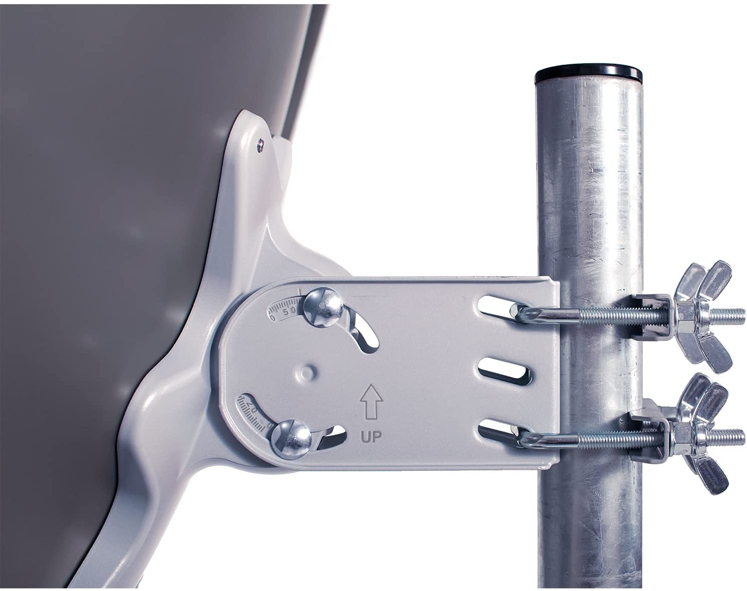

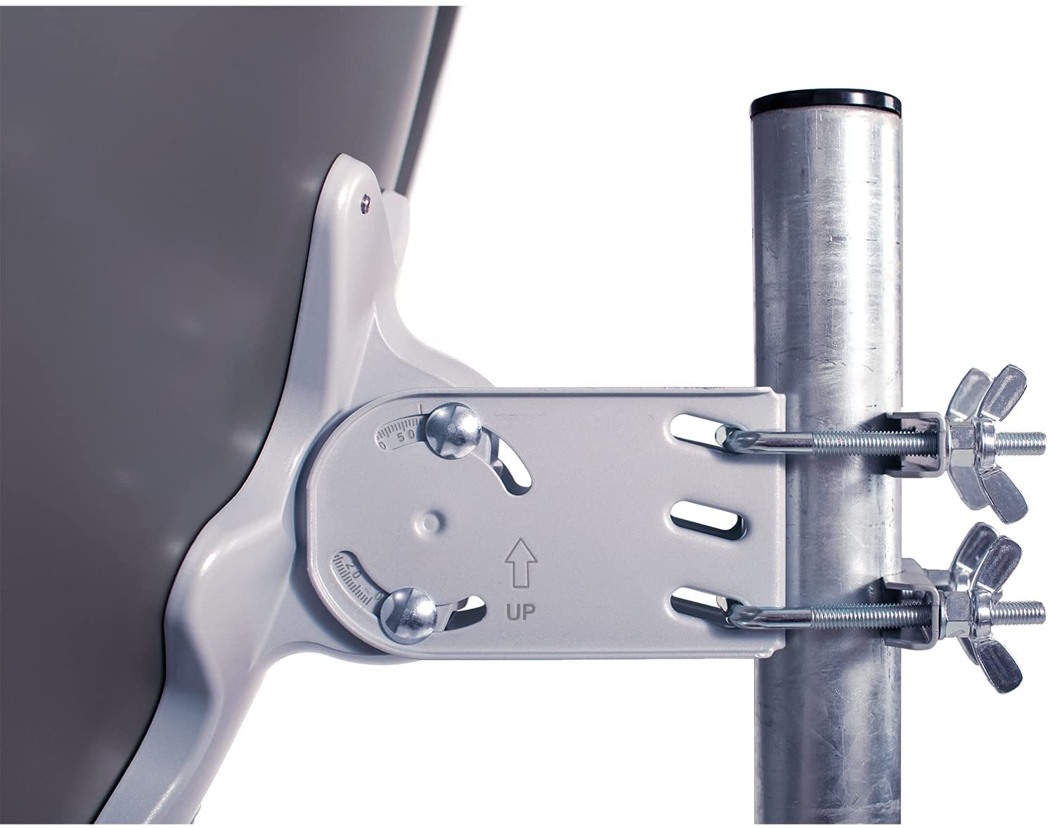

When doing the elevation, is that easy to adjust on your own or do you need a second person?
@urie is the elevation adjustment on your technomate's backplate similar to the triax or more like the one below?

My 80cm Triax wasn't difficult at all to assemble. I had it done in about half an hour.
It's elevation is also really easy to adjust. It's mesh but it still feels really light. Before I stuck the motor on it, I'd mastered moving it by hand from 0.8w to 42e, tuned perfectly, in around 3 minutes. My technique was to do it in baby steps by stopping at 13e and 28e along the way. It only takes one person.

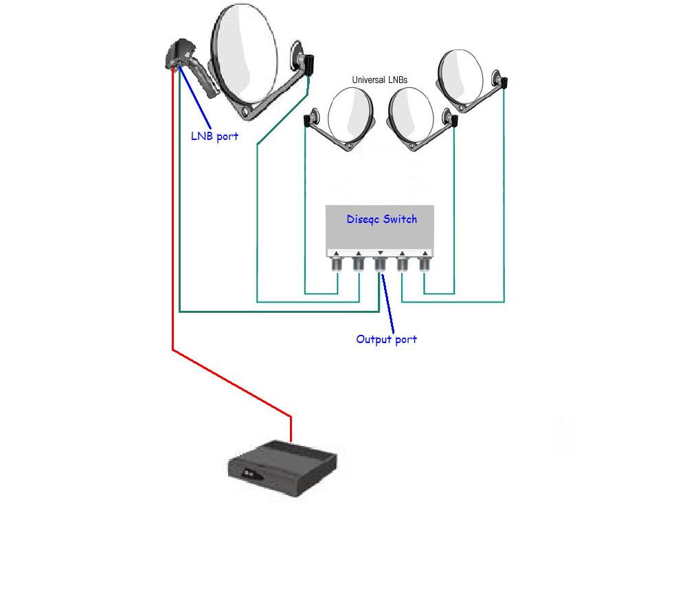

It can be done but the Disqec command
Has to be the same You will have to use
Advanced tunner configuration
If I go with the above setup, could I use any diseqc switch? Or would I need to use like a diseqc 1.2 switch and then use diseqc 1.2 on the motor too instead of usals?
You should be able to get 42e on that dish with a motor. No need for another dish
