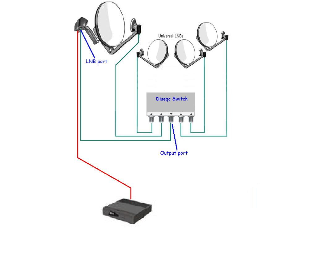

If I cock up the installation and end up missing a key satellite, can I feed that in through a separate dish and diseqc switch?
So I'd have a fixed dish and motorised dish feeding a switch. And if the motorised dish's signal is blocked, the box pulls it in from the fixed dish.
I'm only using a single tuner box by the way.
This was the configuration for motorisied satellite dish and fixed satellite dish on
7 west
Configuration Mode Advanced
Satellite--------You need this setup for each sat position but not 7w. obviously enter you coordinates.
LNB------------------------------LNB 1
Priority-------------------------Auto
LOF------------------------------Universal LNB
Voltage mode---------------------Polarization
Increased voltage----------------no
Tone mode------------------------Band
DiSEqC mode----------------------1.2
Toneburst------------------------None
Committed DiSEqC command---------AA
Fast DiSEqC----------------------no
Sequence repeat------------------no
Command order--------------------committed,toneburst
Uncommitted Diseqc Command-----None
Diseqc Repeats-------------------None
Longitude------------------------001.600
---------------------------------West
Latitude-------------------------54.8
---------------------------------North
Use Usals for this sat-------------Yes
Fixed
Satellite--------7 west
LNB------------------------------LNB 2
DiSEqC mode----------------------1.0
Committed DiSEqC command---------AB
