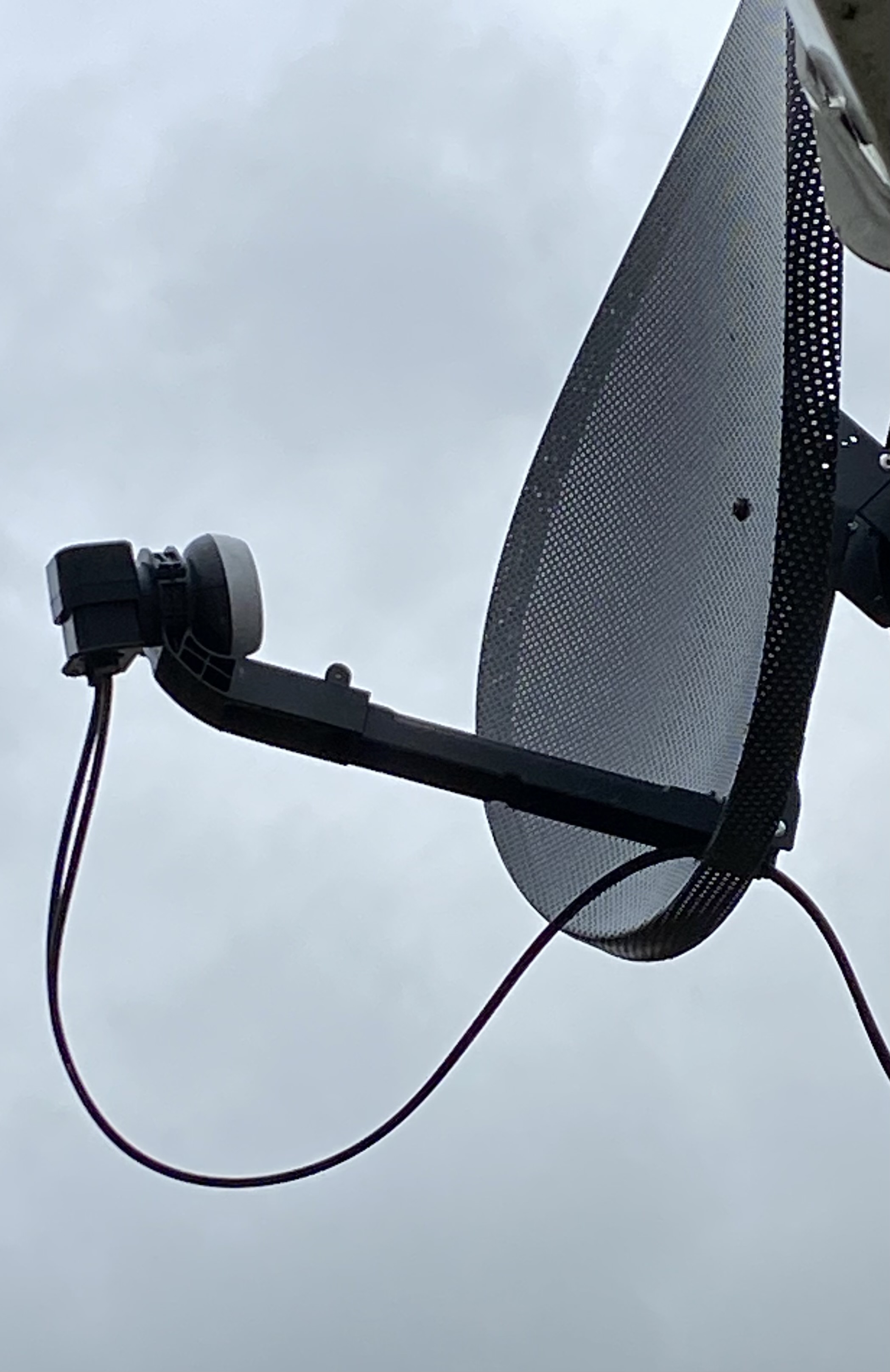

Cheers Ferret’ yeah it’s a wideband LNB by the looks of it 2 way standard
Its two cables as sky q requires a cable to supply the vertical side off the transponder and cable to supply the horizontal side off the transponder
Tie the ladder between the two brackets for safety Undo the f connectors from the l.n.b temporary tie the cables with a cable tie to the satellite dish arm incase they comeaway from the wall Undo the l.n.b holder with star head screw driver Remove the skyq wideband l.n.b
Fit the free sat Universal l.n.b tighten the l.n.b
holder not fully tight until you position the skew angle off the ll.n.b Looking face on at the satellite dish its positioned at 1oclock Fully tighten the l.n.b holder Fit the f connectors tighten and slide the l.n.b cover over the connectors,job done

Who ever installed the satellite dish had it face on then realised there was no line off sight so fitted a side bracket hence forth the big loop off cable

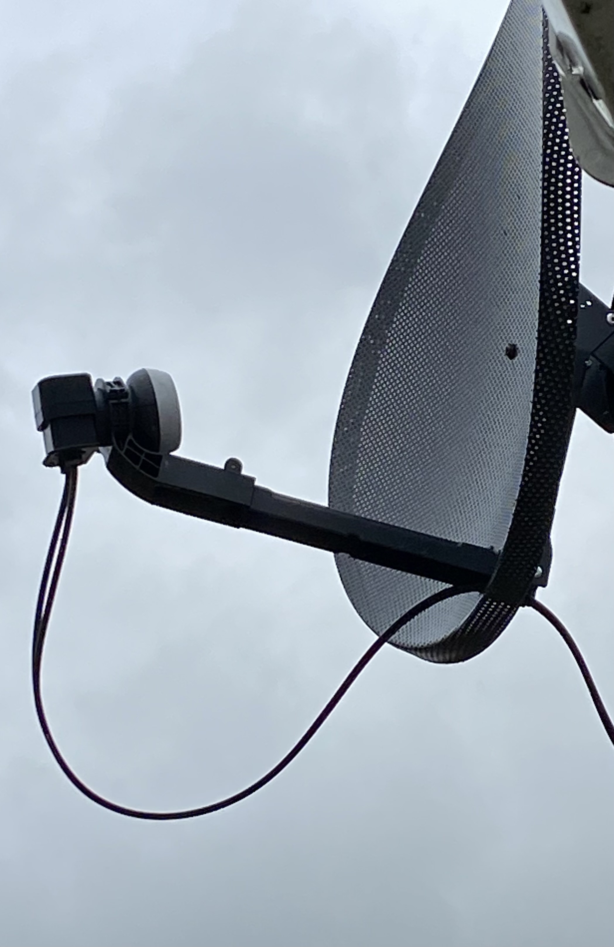

i could probably change the lnb myself or get another dish and move it over to the right side of the house so it’s away from trees for better line of sight the trees are everywhere it’s a nightmare
