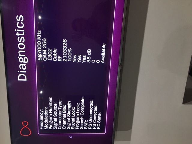

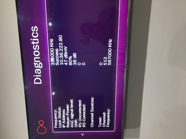

My mate has bought a zgemma h2h and it keeps and glitching every 10 seconds. The same box I tried at my house and it works fine. It's using a vermin line and he has vermin tv package which works fine.
Images attached are the information when from the vermin ti*o box. Does anyone know why it keeps and glitching on the h2h?

If it works ok at yours it must be a signal issue
You need to use best quality cables & splitter

Hi, I have used the correct net ID by getting it from the box and then using the same ID on zgemma.
He is using a splitter, 1 wire to the router and a very long wire going to the box. Id say it's a 2M+ wire

Sounds like your picking up interference from somewhere.

Hmm true. Thanks for the link dave100. I've had a good read of that and it looks like the konig item may do the job
hogie
Just a heads up on all those having glitching issues on zgemma h2h with virmin, I purchased the konig amplifier, just remove splitter then put main feed into amp then feeds from amp to router and zgemma box. Everything working great not a glitch in sight. Great piece of kit.
