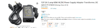

Absolutely not! I use 12v 5a PSU's on all my boxes. These are the ones I bought 5 years ago but they were only £9 each then.
https://www.amazon.co.uk/gp/product/B00OGQMH50/ref=ppx_yo_dt_b_search_asin_title?ie=UTF8&psc=1
