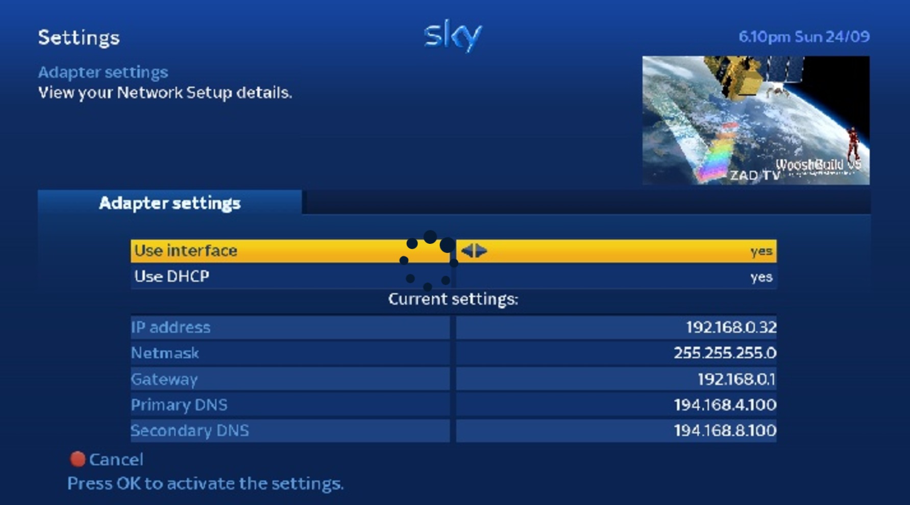

This is what I get under Adapter settings (See attachment)
Thats cause you havnt put dongle in box put it in restart box and go to network settings should come up with LAN and wlan

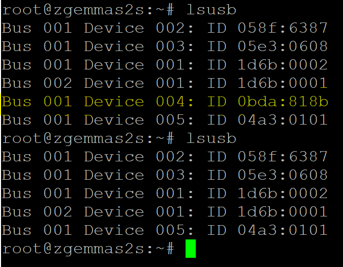

I have inserted dongle, turned off the box, removed the power, but power back on, turned on the box but this made no difference.
I know the box is detecting the dongle. See the difference when i run the lsusb command before and after i remove the dongle.
I will order the dongle you have and see how it goes.
