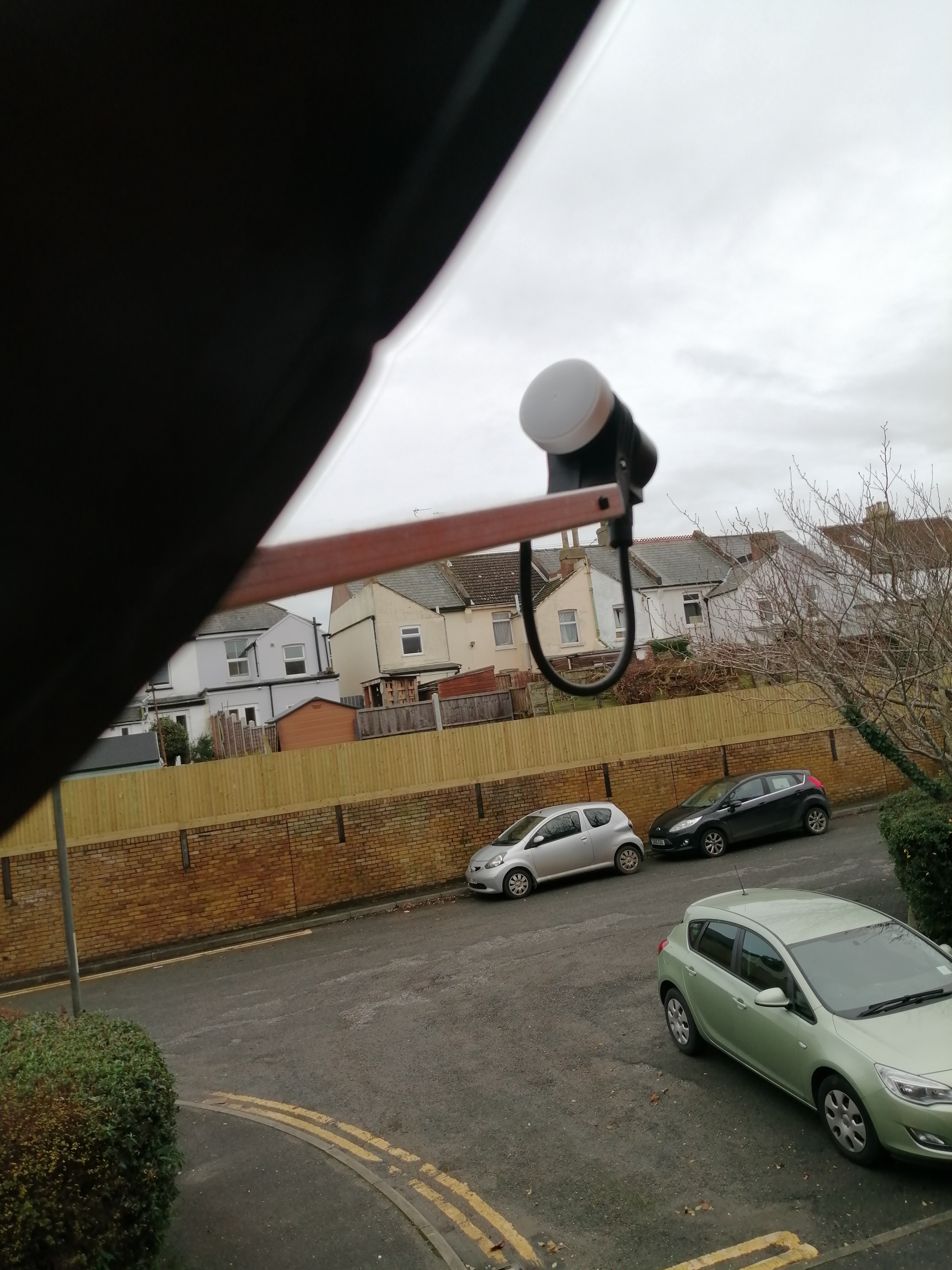

Here is the position for the lnb:
I'm not sure what to do how to improve the signals so I'm asking you for some advice.

Good pics but lnb should be side on so I can see in collar. This is mine on a triax dish with an octo lnb. I moved it in and out to get optimum signal. Make sure your lnb is dead straight ie no twist.

Do you want me to the the pics of the LNB on the side in much closer?

No I have just move the LNB to the left and right but it have make no different. I need you to show me in the pic where the rig is as I don't what the rig so I will do that when you draw me the pics of the arrow where the rig is.
