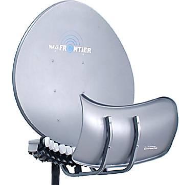

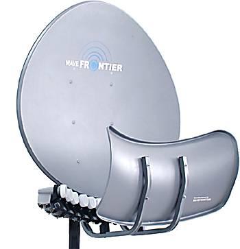

motorised or coroidal dish?

What’s coroidal?Thanks, I found a installer company which is in neighbouring town. They do multi sat, motorised and coroidal dish installation and the prices are not bad compared to other installers. Now that I have so many options, I am confused
Sorry mobile auto corrected it. It is toroidal dish.What’s coroidal?
