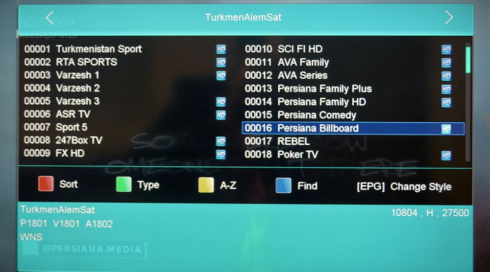

I get 53e to 58w, there's nothing past 30w
52e has some decent FTA channels. I get around 70% SQ on most - 1m dish.
Varzesh 2, 3 & ASR TV show some premiership matches but the picture quality is not so good at times as it's mainly taken from the internet,
Varzesh 1 shows a lot of WWE.
RTA SPORTS shows cricket, with some live matches,
Sport 5 (Czech) is on 51.5e
Poker TV shows Poker & some snooker & pool, (nothing live)
2 music channels - Persian Billboard & Rebel,
Newly added TP (11221 V 27500) has FX HD & SCI FI HD
247Box TV shows films without ads, it's also on the new TP as 247Box
These are the main watchable channels, most have foreign ads during programs,

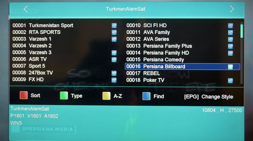

RTA SPORTS shows some cricket, with the odd live match,
247Box TV is also online, google - 247Box TV Live
