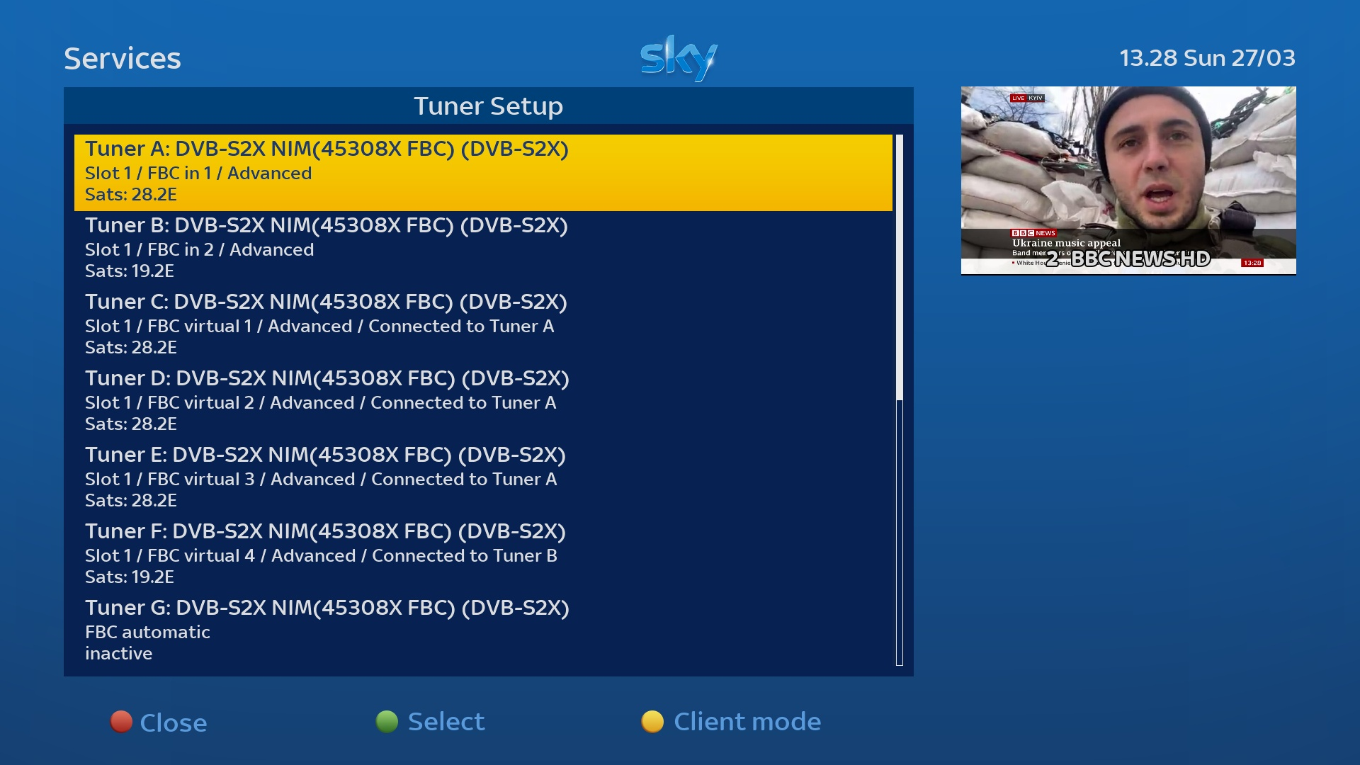

Well perhaps Willo3092 knows what settings you have at the moment , but know one else will no images of settings from autobouquetsmaker :unsure:
Tuner B shouldn't be connected to Tuner A if you have a cable to it.
Set tuners A and B according to what satellite is connected to them.
I have Tuner A connected to 28.2E and Tuner B connected to 19.2E.
You can then set the leaf tuners (C onwards) as connected to either Tuner A or B.
Make sure each tuner has a different SCR number and not the same as the other box.

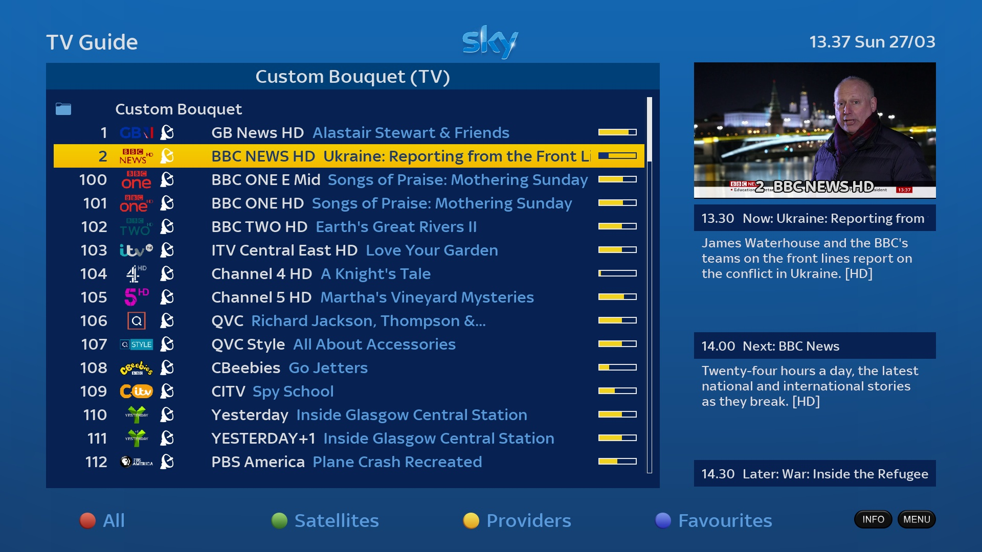

Sorry for going about this the wrong way. I just want to get the slky channel as downstairs which lists beeb 1,2,,3,4, stv, 4 then 5 followed by freesat chanels.
Is it same box downstairs ? if so can you not just backup settings and transfer to new box , then setup your tuners.

last night while pressing some buttons on my controls, discovered I can now get a list of tv programs similar to slky in which the list is exactly the same with no interruptions of non-usable channels

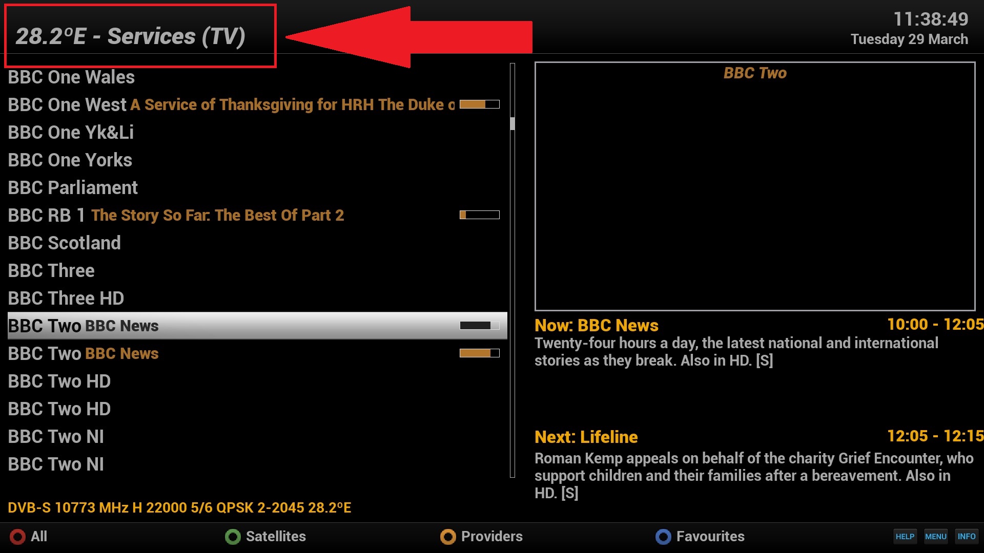

We don't know if he is in a bouquet. He might even be in the 28.2 service list.

3. What do you see in the highlighted section of this example picture. Write the full name or attach a picture of what you see.

At bottom of screen you will see: All, Satellite/extended, Providers, Favourites. These are coloured buttons
Select the viewing mode you want. Most people will want "Favourites"
A list of bouquets/favourites will be shown. Select the one you want.
Channel selection remembers last mode, so not always necessary to do all above. But as I said, surest method.
