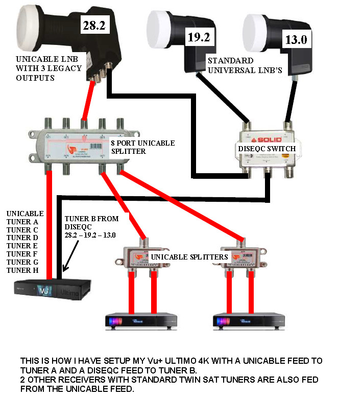

I only use 28e and 19e these days and was considering removing the 80cm motorised and replacing with a smaller fixed with 2 lnb's, now this unicable has got into my head.

In reflection now if i was starting from scratch again i was told to get a 1m dish and multiple lnbs and could be added to and this unicable idea would possibly the way to go . A mate on another forum loves his home made project on feed hunting with this dish as sometimes its the thrill in doing things and seeing what can be done and you thought you had a big one lol

With a satellite FBC tuner there are 2 feed inputs. Could you use 2 separate feeds for each input i.e. cable from unicable LNB for 19.2E into input 1 and cable from unicable LNB for 13.0E into input 2?
Would you then be able to split the tuners to:
19.2E Tuner A, C, D & E
13.0E Tuner B, F, G & H
Effectively giving you 4 tuners for each satellite? I believe you can input a unicable LNB into input 1 and have 7 tuners and run another feed as a single tuner on input 2 but not sure if you can split the virtual tuners evenly.

No expert on unicable So a unicable set up
Can be split as the tunners can work at the
Same time

A question regarding unicable lnb's, if I have two receivers in separate rooms and I wanted to feed both from the unicable output, would this work? As I see most only have one unicable output
