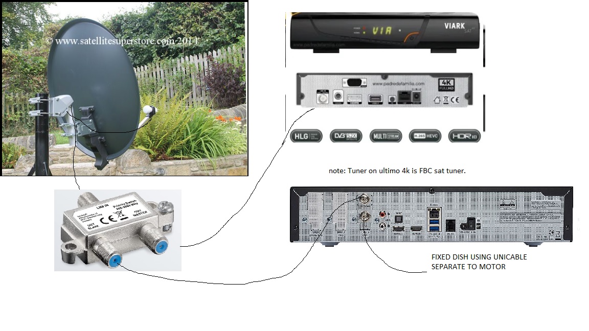

hi
can anyone confirm the diagram i have posted basically works. It shows a simple representation of what i am looking to do in the next few months but just wanted to confirm this is the case where both boxes will be able to control the motor as long as the other one is not in use. Sorry its not the best but hope it can show what the basics of what i want.
hi
Correct

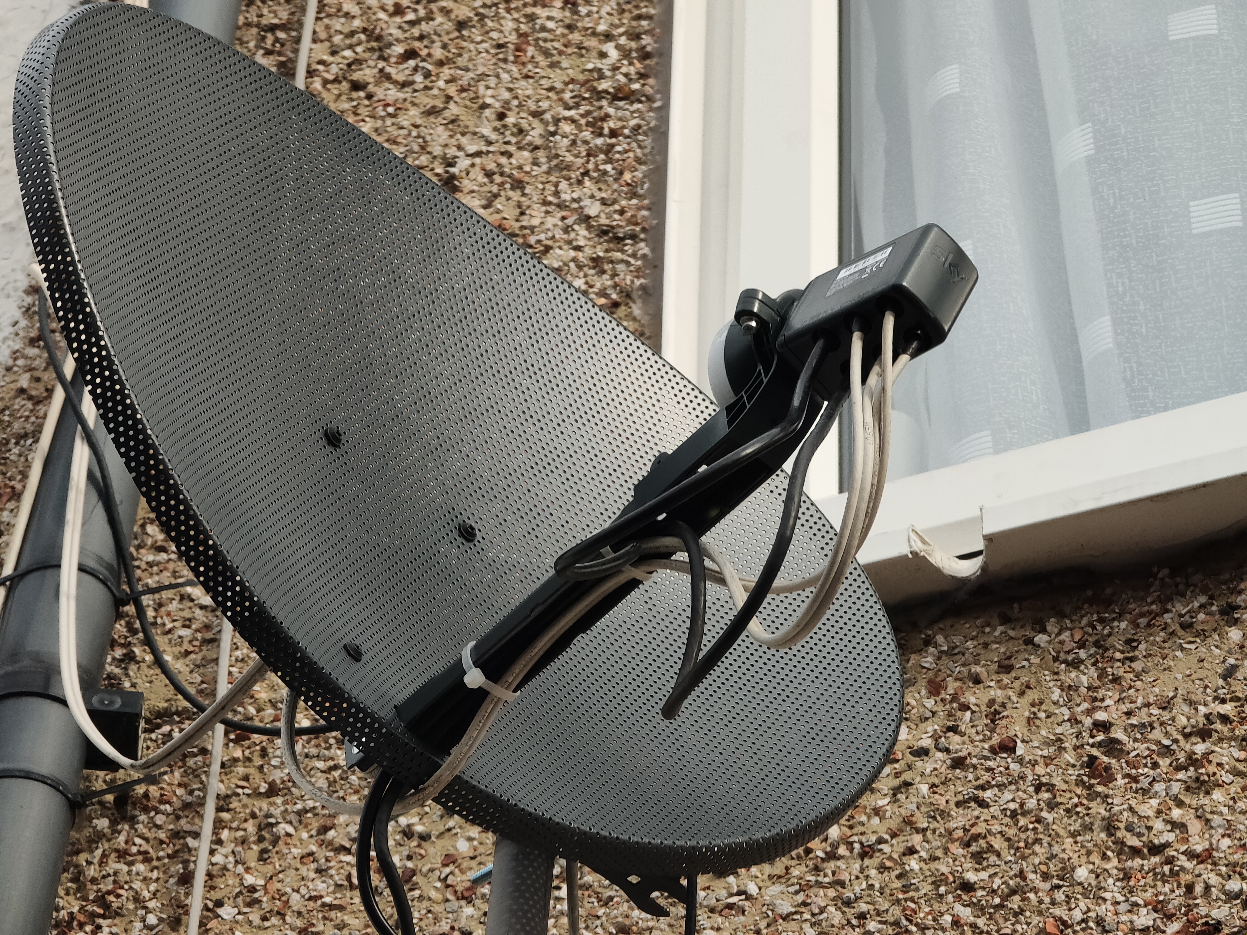

Thank for confirming. So i am just gatherting and researching all the equipment i think i will need. So i am thinking of using my existing LNB that is on my sky dish for my motorised dish when i get one. This one was installed by Sky themselves. It is the HYBRID LNB with 4 legacy ports. I understand obv the wideband ports would not be used. Can i take it that this LNB will work perfectly fine on a motorised dish? or its better i get a higher quality spec one?
Thanks
Thanks
Just get a normal Universal lnb, they are not expensive.
The dish should come with the correct lnb holder, iirc the sky lnb will be 38mm so wouldn't fit a "normal" dish anyway.
The universal lnb will have a 40mm collar.
Never used a technomate lnb so can't comment on that.

I know that dish was installed early 2021 by sky themselves but i can not confirm what size collar that one is.
I think i might just get the techomate one as it comes with the dedicated collar.
Thanks for your help
Unless i'm mis-understanding what your wanting to do.
You need to get a universal lnb for the motorised dish, you won't need the lnb adaptor that comes with that technomate lnb as it's for a sky dish.
Your earlier posts say you have a fixed (sky ?) dish with unicable II lnb, but the picture above is a hybrid lnb (wideband with legacy).
Oh apologies sorry wasn't clear.
Some second hand dishes doesn't come with the collar for example
Triax TD64 64cm Satellite Dish With LNBs and Stand | eBay
So if I find a big dish like this then I will need the lnb with the collar.
If it comes with its own then it's fine. Depends on what I find.

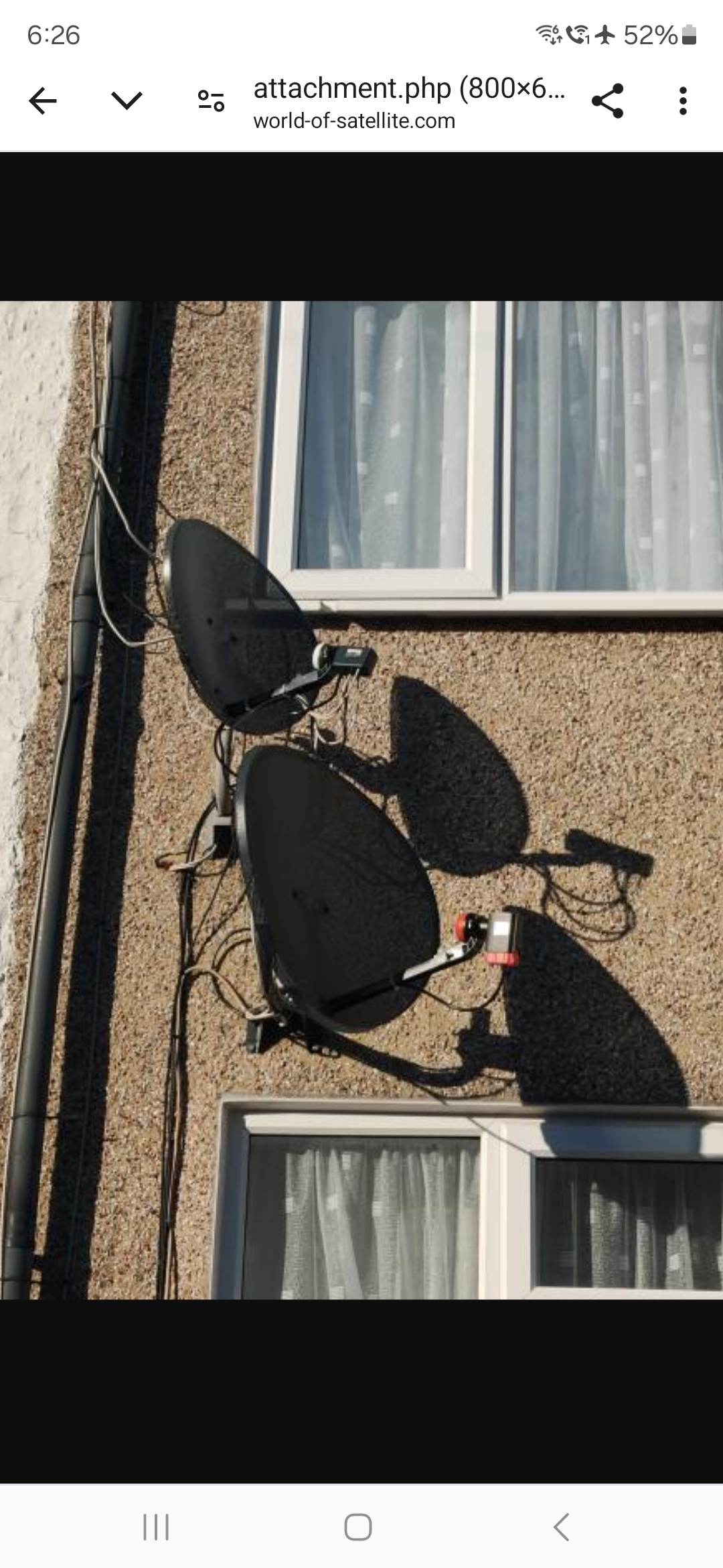

Yes my other satellite dish which I haven't uploaded is a dish with the unicable lnb.
I have a photo somewhere I'll upload it
OK so the bigger dish is unicable set up.
The sky dish is now basically doing nothing so plan to replace it with a motorised one so was asking if existing lnb plus adapter would work on the motorised dish assuming the one I get didn't come with either.
Hope that makes sense
