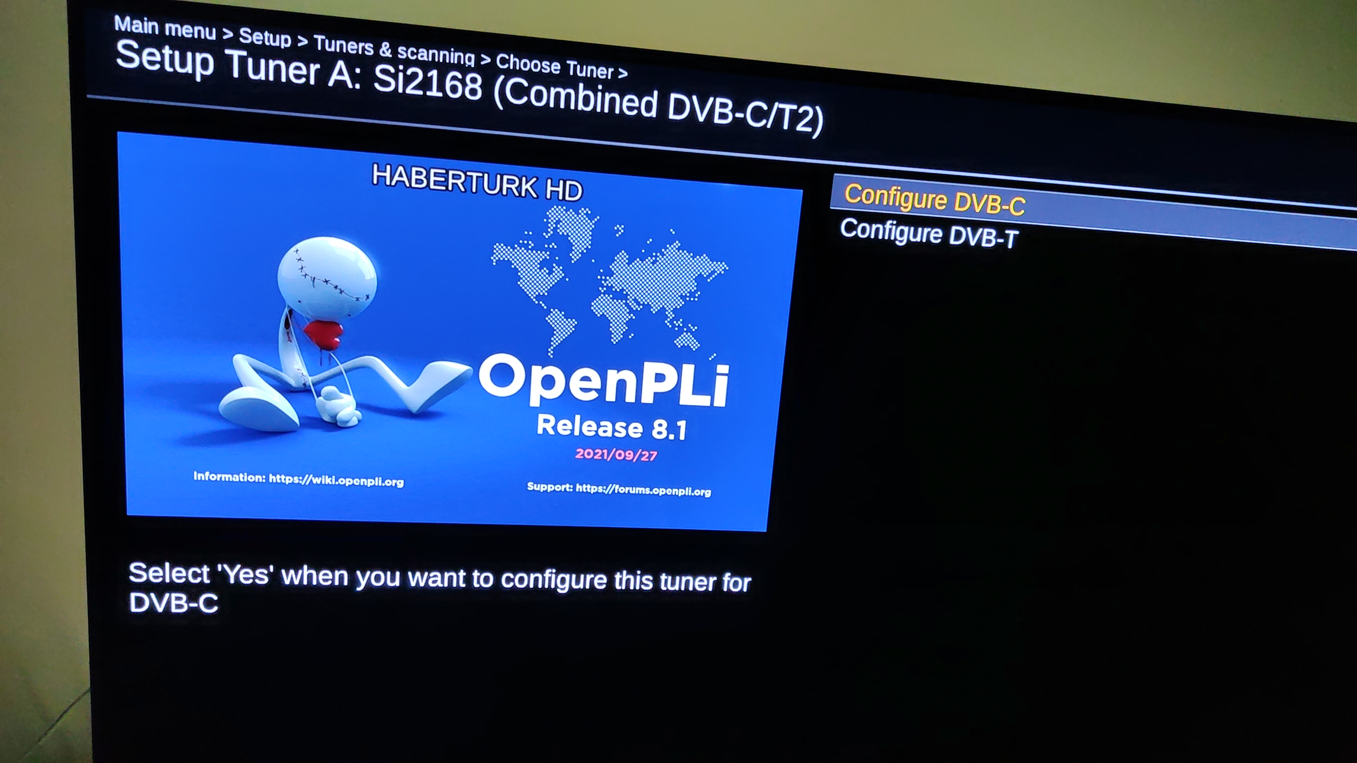

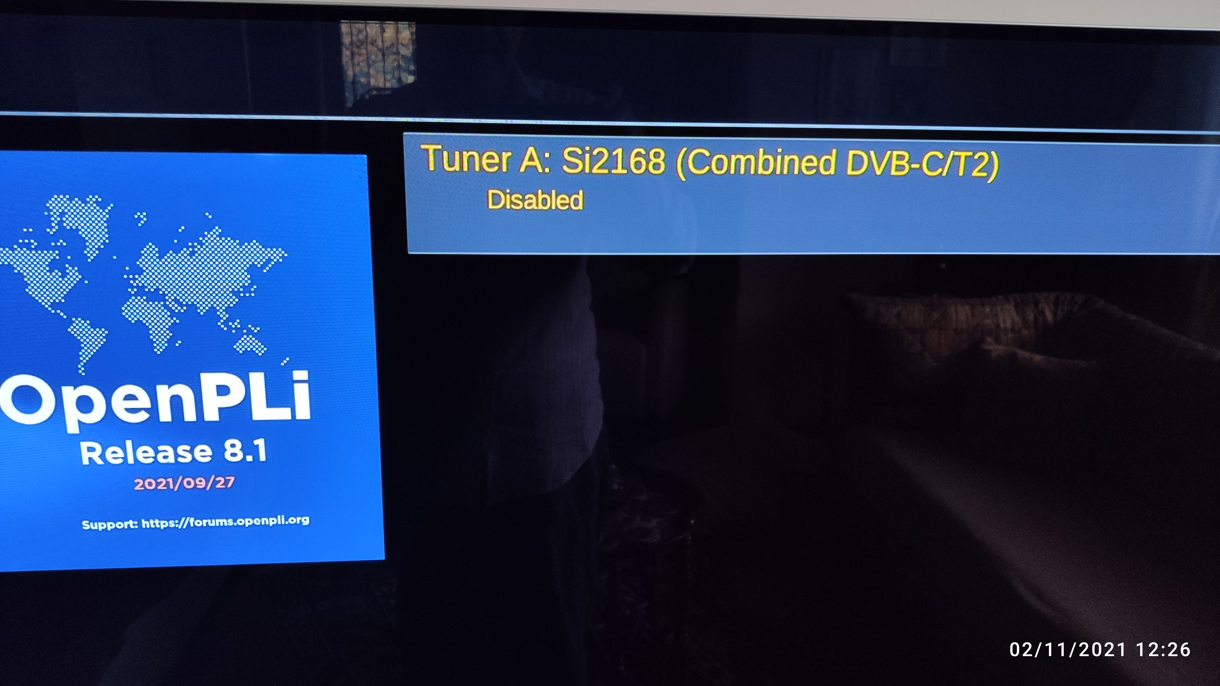

Today my Zgemma H7 faced me with the following screen. In fact Tuner A had already gone for 6 months and I was managing Tuner B since then.
Now Tuner A also is not working as you see. Any other tuner is visible.
How can I do this?
When I press on Setup--> Tuners&Scanning-->Tuner Configuration only one option is appearing which I pictured above.
Press the ok button on it or use the <> buttons on remote to enable it.
Neither Tuner A is enabled nor Tuner B is appearing.
The following screen is coming when I press on it.
