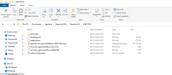

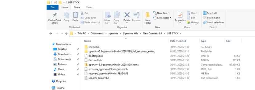

Hi all Does anyone know how to flash a zgemma h9 twin with the new ?
there's now 3 files:
mmc
recovery emmc
full recovery emmc
where as before it there were 2 files:
mmc
recovery emmc

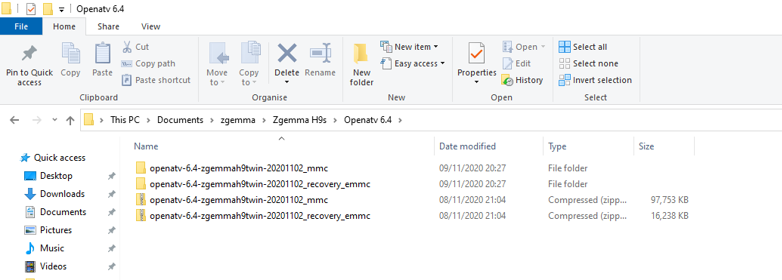

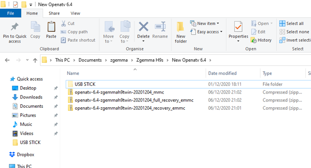

does anyone know if this is right or something I'm doing wrong?
I followed the every step of the video at the top of this forum to flash it originally and I wanted to give it a reflash and a fresh version of open atv 6.4.
I have posted a picture of what the Usb file looks like with the old files on and a picture of the new files
All Usb sticks are formatted fat32 and every one of them flash with the old files on.
I do use the reset button on the back to flash like in the video or it wont flash .
when i flash with the old files the box will say boot , flash then come up with the boot menu like it does in the video posted above
when I add the new files the box will come on with the yellow dot for ages then say boot then flash it wont flash with the new files.
Is there anything I am doing wrong?
I have posted pictures of the files and what I mean
Thanks
mmc
recovery emmc
full recovery emmc
mmc
recovery emmc
Thanks

In your pics you have a folder called Zgemma H9s with the H9 twin or combo files in it.
What model is the box?
zgemma H9 Twin
The file it is saved in is called zgemma on my computer is h9s but that's for my own preference
i copy the files i need out of there to my USB stick
